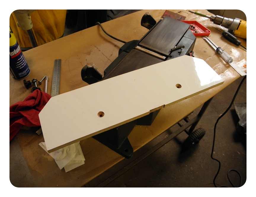

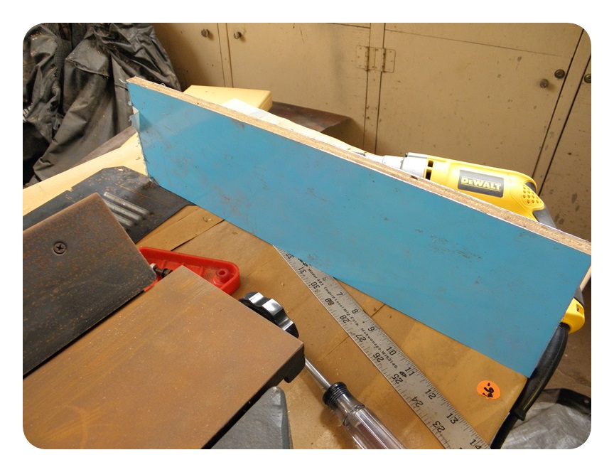

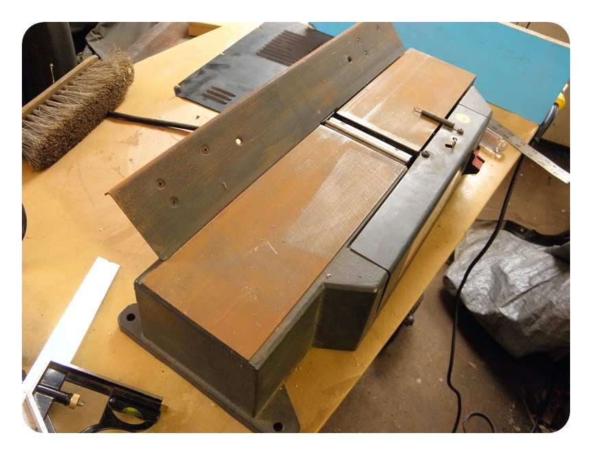

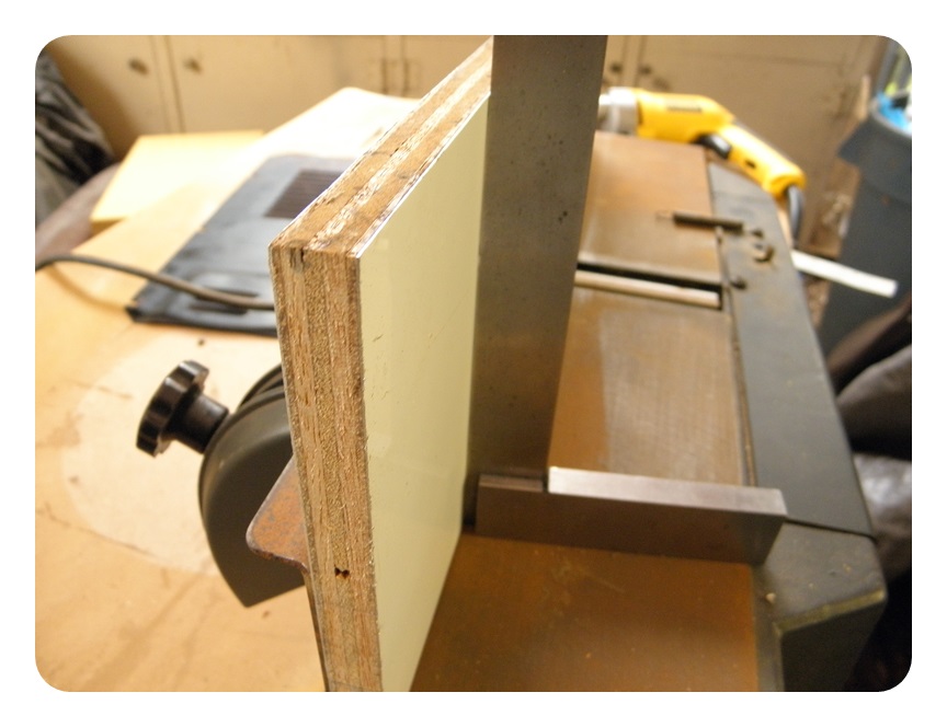

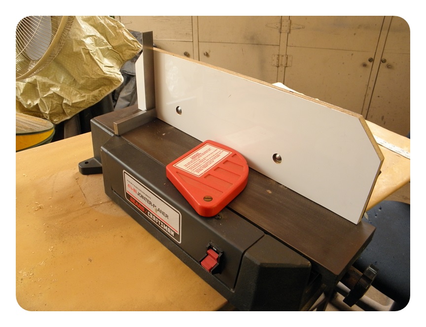

    Surface Planer Fence Modification. Made from double sided aluminum plywood to stiffen and square the fence.
