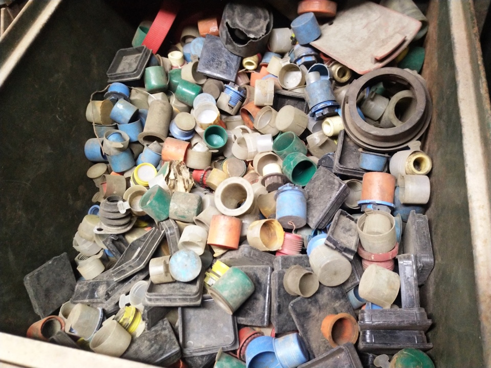

    I don't know about anyone else but I save every plastic fitting cap or plug I find.
    These are just the ones in 1 of my bins

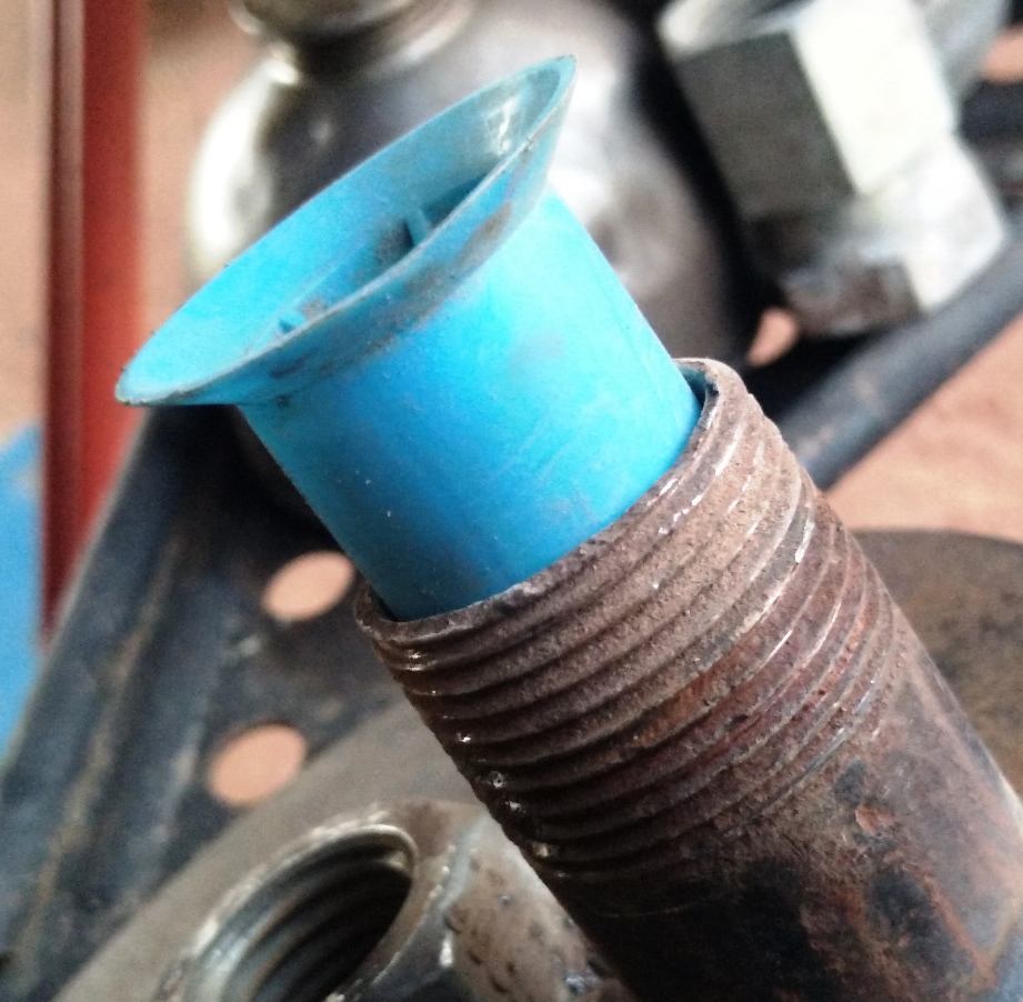

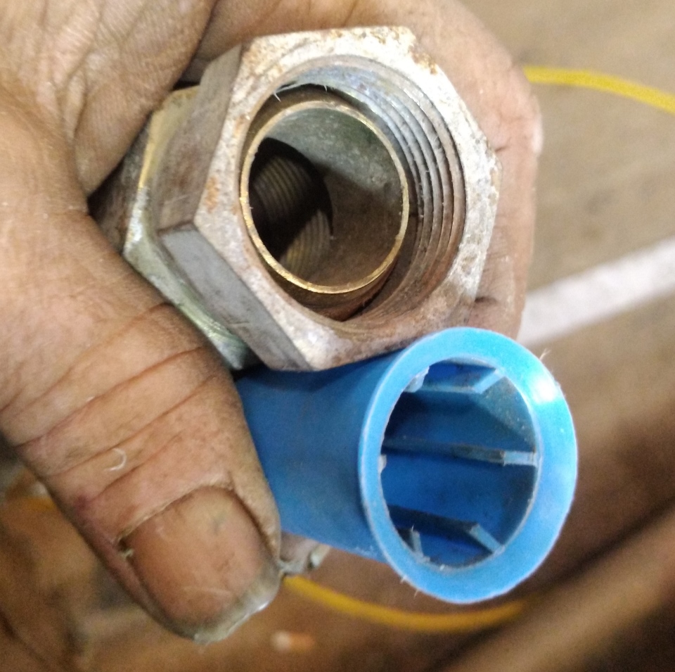

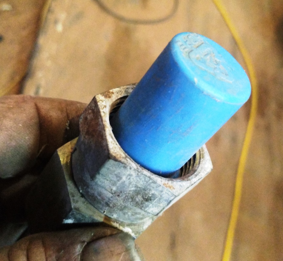

    After searching through I found the perfect candidate for my seal.

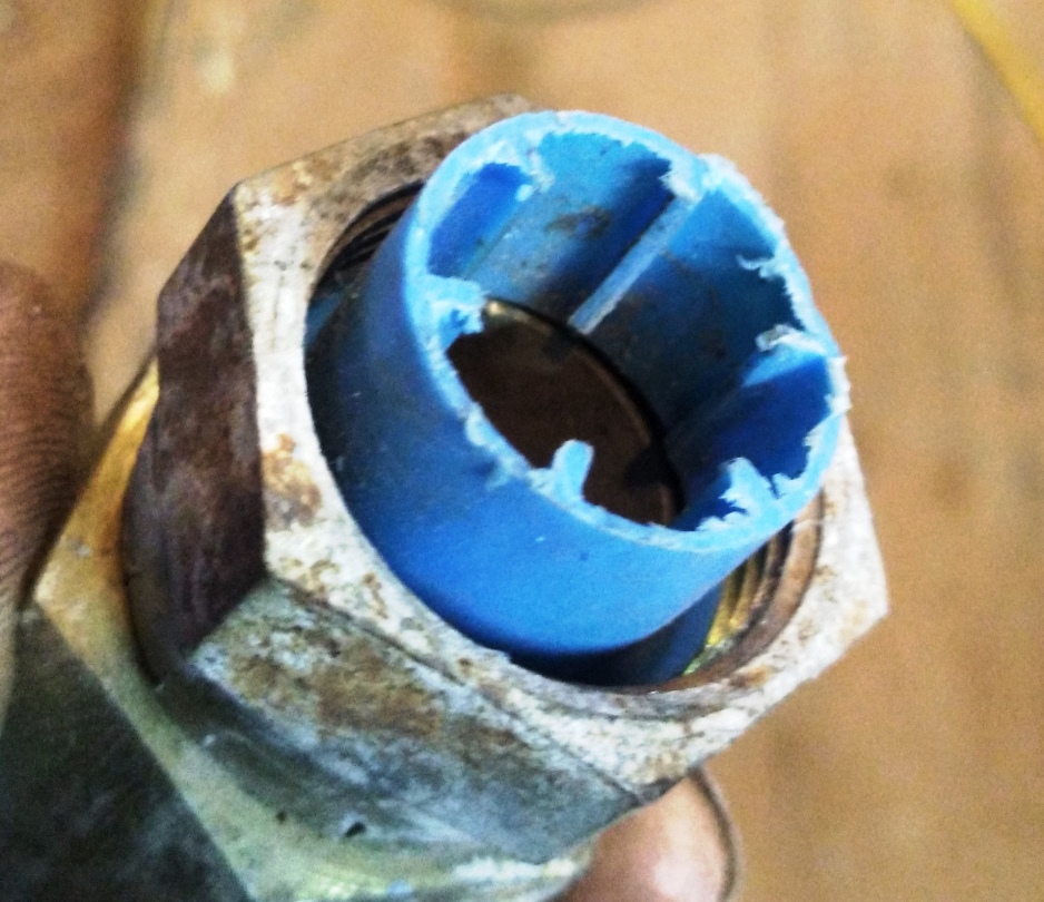

    After sanding the flange down to fit in the swivel fitting and cutting off the excess length
    this is how it fit in the pipe

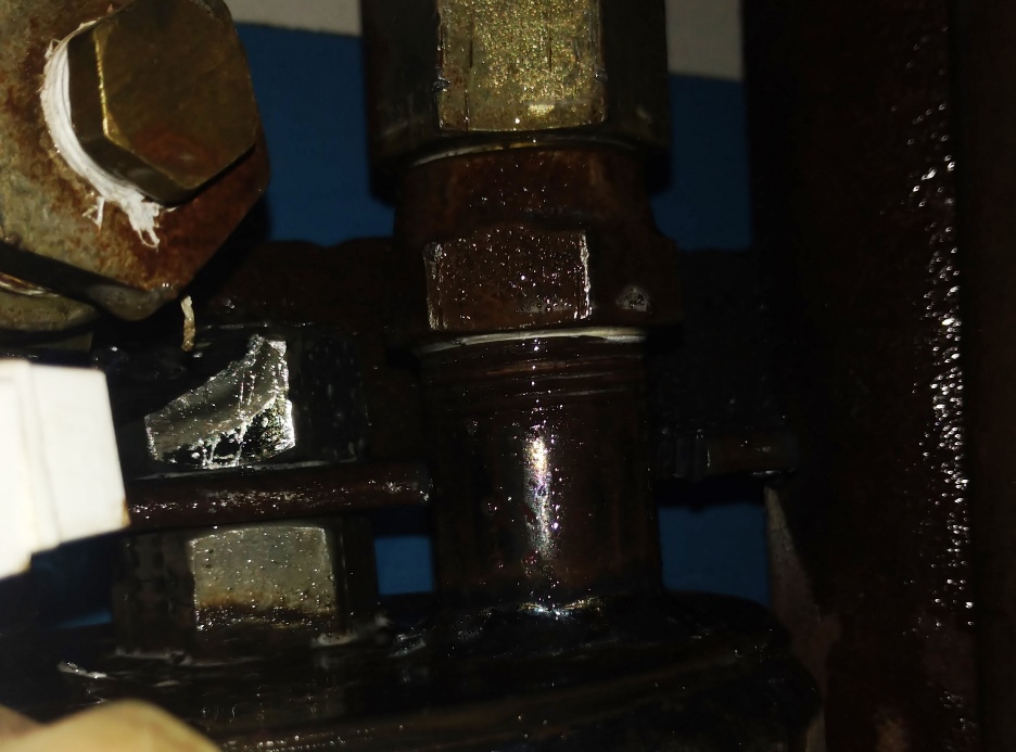

    Reassembly aired up to 120PSi and doused in diluted dish soap
    A little hard to see gut there are zero leaks.
    So far I have only about 30 feet of pipe and fittings installed, and it takes 12 hours for the system to lose enough air for the compressor to kick on and refill
