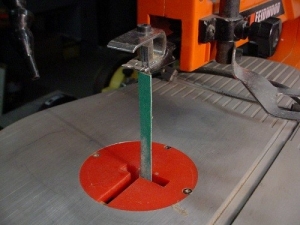

    This can be very useful and money saving for those who like scroll sawing.
    It is a sanding blade you install in place of a cutting blade on the saw.
    You need to reduce the speed to get efficiency.
    It's made of a thin strip of metal sheet, the length of a regular blade, slightly larger, and a sand paper strip stuck on it using double sided tape.
    Two little holes at each side, with small pins crossing the holes allow to use them as pin end blades.
    Cheers !
    Christophe

    I could never thinking about it.

    That's a neat trick. Thanks for sharing Christophe.

    That's a nice idea, Christophe. Thanks for sharing.

    That is certainly handy for sanding small items Christophe but if you need to use it for sanding actual scrollsawed items you probably need to use a good reverse cut blade - I use them so I don't have to sand the fuzzies.
    Too lazy to sand, I am
