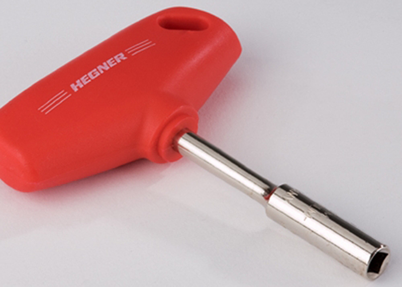

    His Hegner is a piece of artwork in machine tools, IMHO and he wanted an old style "Skate Key" for it. You can get a new fangled key for <$20 but has a plastic handle and it just doesn't cut it with a $2k saw, IMHO.
    Here is what the new fangled keys look like.

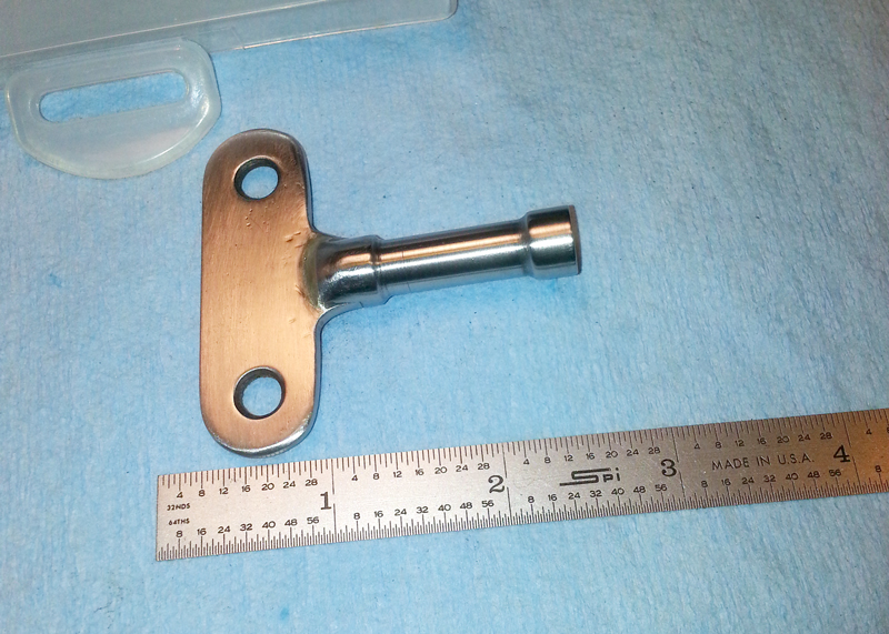

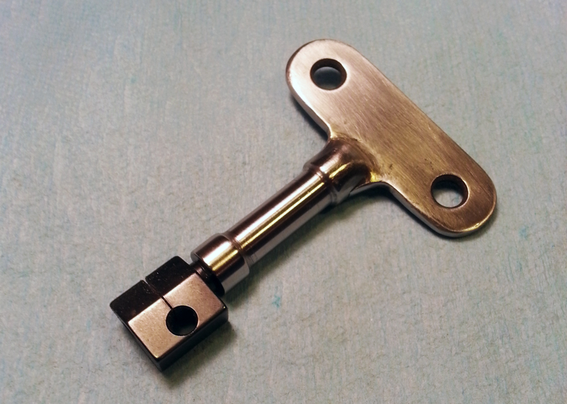

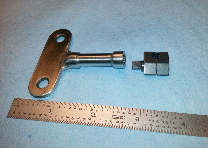

    I did some research and found some pictures of the old style and he gave me the head that it fits to match the square drive and Off I went.
    The shank is made from 1/2" W1 steel and turned the head down to about 7/16" (.44) then turned the center down to about 3/8". I mounted the 3/8 section in a tool holder on the lathe and used my cutoff arbor and a 3"x 3/64 cuttoff wheel to cut the notch for the key wings.

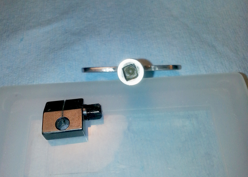

    Doing the broach was a bit more tedious! The square was odd size (.105 AF) which equates to .1485 across corners, so I used a number 38 drill (.1015) knowing I'd need to open it a skosh. I then tried to make a broaching tool form a piece of tool stock but the Peanut (Mini Lathe) just didn't have the spizeringtom to get it done from the tale stock or the cross slide/compound. So I punted and used the Dremel and some tiny engraving bits to whittle it out to size. It was a Real Nice fit when I got it done despite the slight vortex affect you see in the pics. I chucked it back up in the lathe and put a shallow crown to it so it would slip in nice without looking or fiddling.
    Next I had a piece of 1" x 1/16" CRS and cut the rough length and shaped it mostly on the belt sander. Center punched the 2 holes an drilled them. Mostly a lot of hand work to get the shape and fit into the shaft slot right. Then just silver brazed them together....then a lot more hand work to get it looking right.
    The last thing I did was to heat treat the broached end to hold up to the hardened square head. Just heated it dark cherry with a Mapp torch and soaked it for a minute or two, then quenched in room temp water. A test with a file (All good) and little clean up and Whalah an old school Skate key for a Nice Scroll Saw and good friend!

    One minor issue occurred when I heat treated it that I didn't think of. That was that the broach opened up maybe a thou or two, so it was a little looser than I originally had it. Basically because all the ducks lined up (grains tightened) in the structure it shrank the material, thereby opening the hole a tad. It works fine and he loves it but I will remember that next time I heat treat W1 for a fit like this.

    Looks good. I’ve used a Hegner. It’s price suggests it is top-notch and well made, but I thought it was short on features. I concluded it was appropriate for intarsia but not for fretwork...and I don’t do intarsia.
    Two differences between your skate key and the Hegner key in the pic: length and heft of the grip. Yours is a thumbscrew and some people get sore thumbs using them. The large plastic grip on Hegner’s fits in the palm and enables hand turning, with the longer shaft giving room for the fingers. It’s been years since I used the Hegner and I don’t recall the details, but something tells me they had the thumbscrew like yours back then, and their newer design might have been in response to users requests because of sore thumbs. (Or, in response to old folks with arthritic thumbs. )

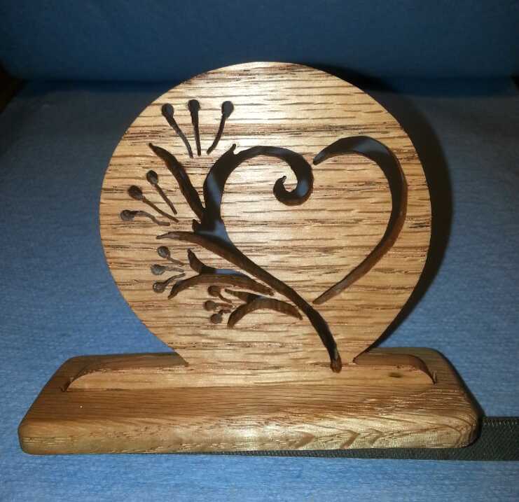

    I do prefer the plain end blades but on thick cuts or metal the pin type flex less I feel. However the plain end blades are much harder to remove and secure on my inexpensive machine because of the design and access to the holders. I've modified my holders with some TLC and new swivel pins to reduce the slop which helps but it's definitely Not a Hegner Quality of machine for 1/10 the price. I can live with that for what I do. Here is one of my early pieces I made for my Mrs.
