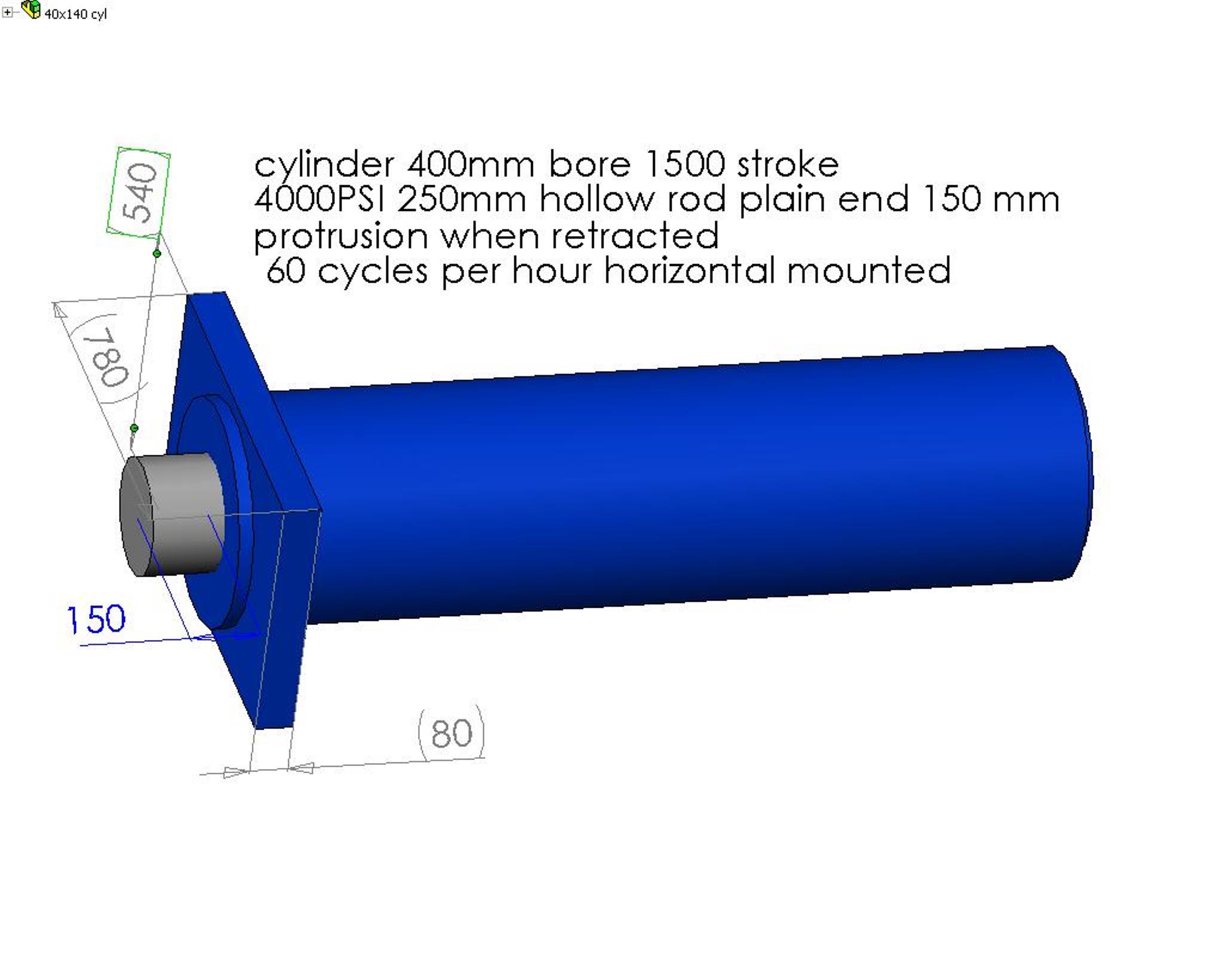

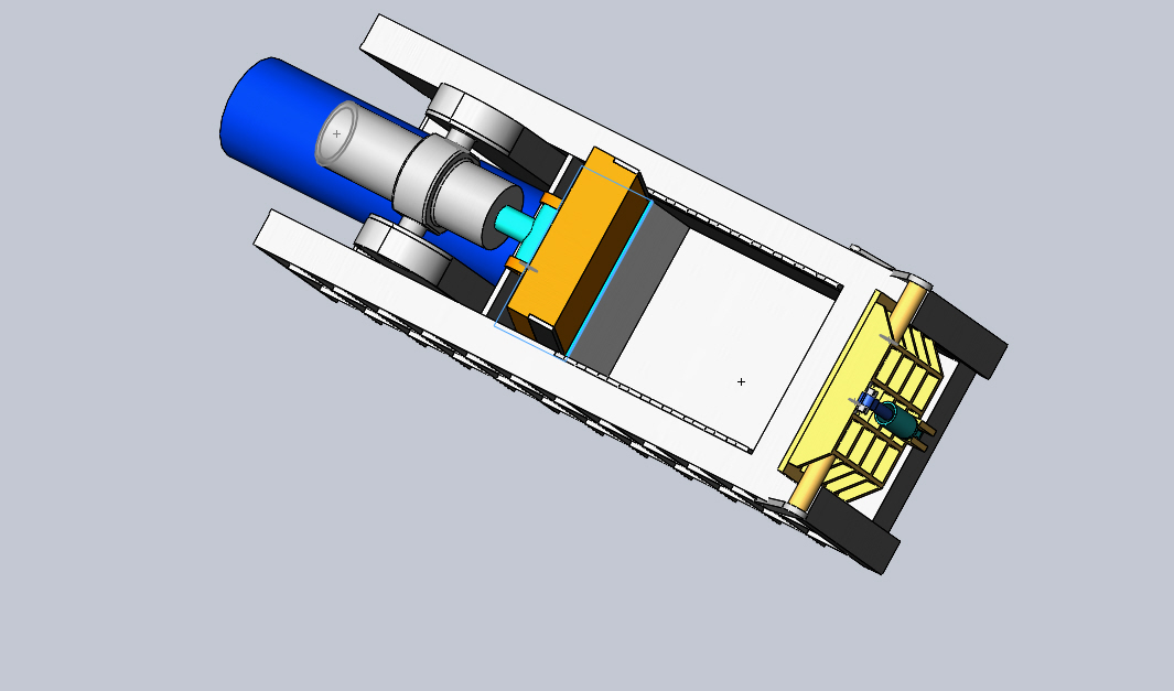

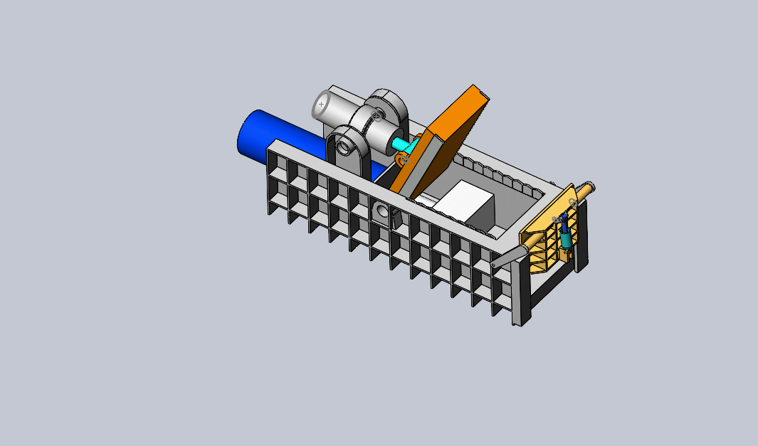

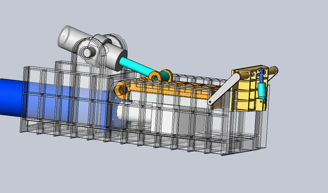

    Here is the start of the design for one I I did while in Kuwait

    I get 389 short tons on your cylinder Frank. That's a lot of squishing!
    Mark
  6. #6
    11,715
    2,228
    Quote Originally Posted by mwmkravchenko View Post
    Mark

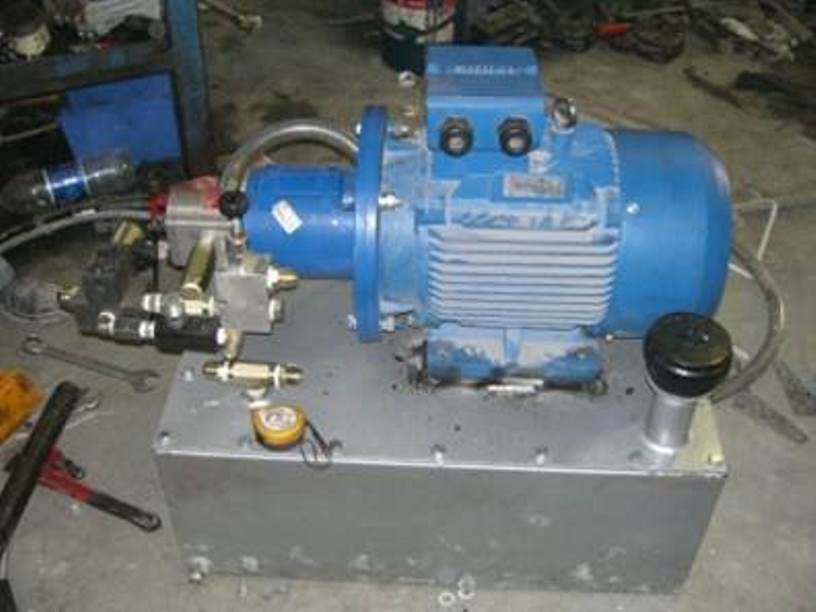

    It was actually quite a bit less than that because the 50 hp power unit could only develop around 3000 PSI but still close to a 300 ton compaction The shear blades on both sides could shear 20mm x100 mm flat bar with some difficulty though but the machine was mostly used for compacting sheet metal I think I still have a picture of the power unit but can't locate any pictured of the working press
