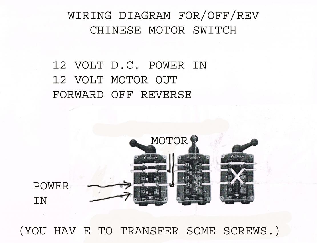

    Schematic for Chinese Motor Switch FOR/OFF/REVER
    SCHEMATIC FOR CHINESE MOTOR SWITCH    FOR/OFF/REVER-switch-schmatic11092014.jpg

    I wire them. 'backwards' for left handed operation on Chinese lathe/mill.
    It seems more 'logical' and you don't need to move around when switching on/off as you would with 'exclusive' right hand use
