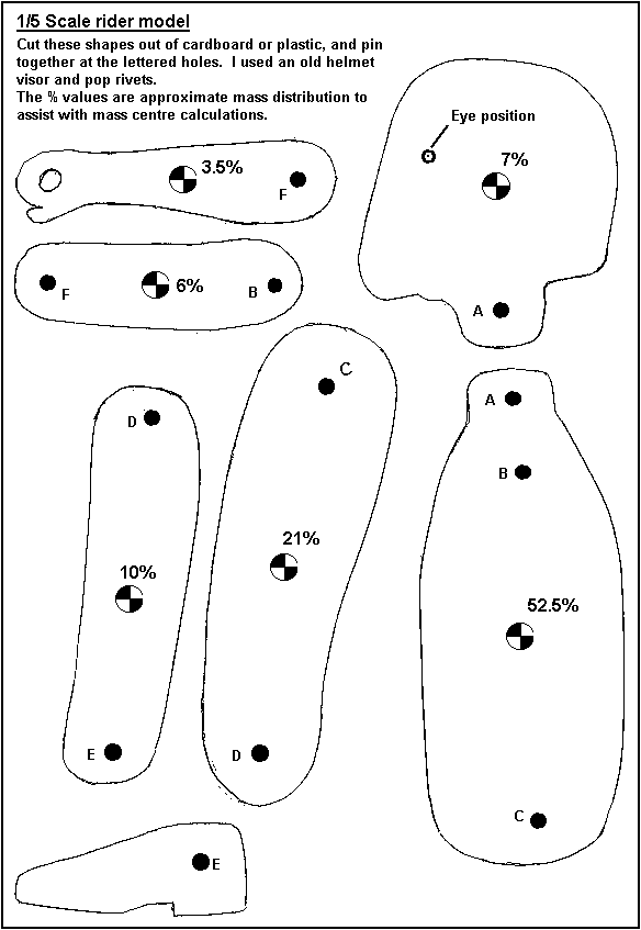

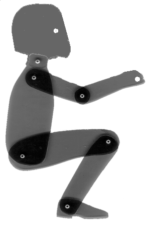

    Way back before desktop CAD I had a business designing and making chassis for racing motorcycles. For positioning things like handlebar and footrest positions it was useful to have a scale model of a rider who could be arranged into different positions. I would trace the outline on to the drawing of the bike. I also wanted to be able to estimate the rider's CG in different positions. I made a few models of different scales with indications of body parts CGs. BTW. He is called Fred and he has a helmet shaped head for obvious reasons. Here are the parts.
    Scaled 1:10 Human model-bodyparts.gif
    and here is an assembled model.
    Scaled 1:10 Human model-fred_all.gif
    Some years later I found the following info regarding CG positions which I include in the hope that it may be useful.
    Scaled 1:10 Human model-bodycog.gif

    Way back before desktop CAD I had a business designing and making chassis .....
    Hi Tony, that's really valuable information, the CG info may be useful as well , for designing seats for instance.
    Thank you, I 'll keep it in my archives !

    Glad to help. BTW I notice a difference in our respective models. Yours has an extra torso joint but no neck joint, mine has the neck joint but not the extra torso one.
    Vive la différence.
