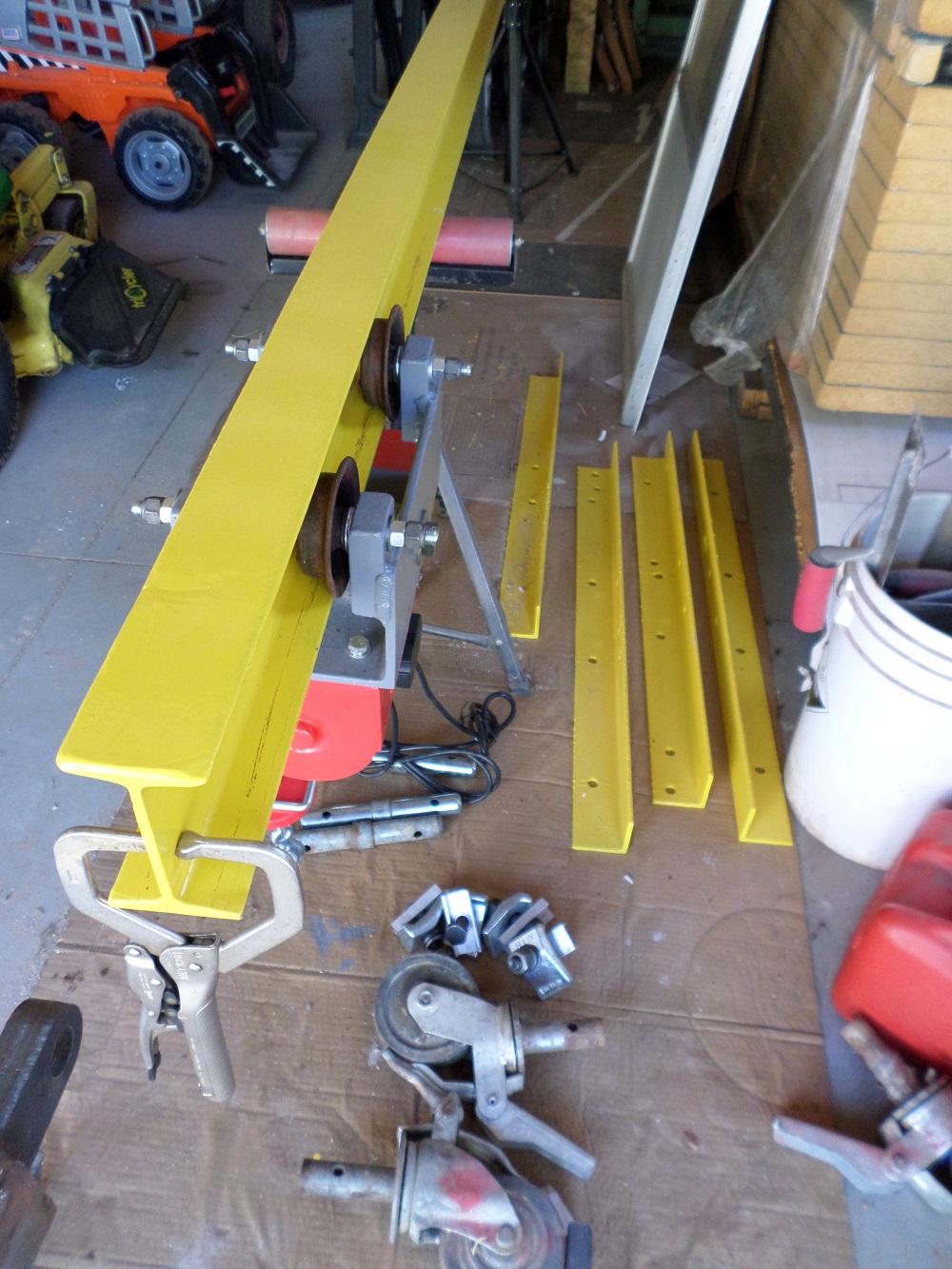

    I was able to procure a couple of small I-beams on craigslist for about $40. Together, they would be long enough for the scaffold crane. I beveled the edges, clamped it straight and then welded to two pieces together with 7018 stick weld. I ground the inside flanges smooth so that the trolley would roll across it, but I left the outside weld bead as laid.
    I also cut some 3" angle to length and then drilled some holes for the mounting hardware.
    Then I Painted everything before assembly.

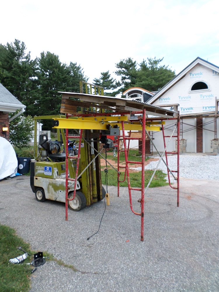

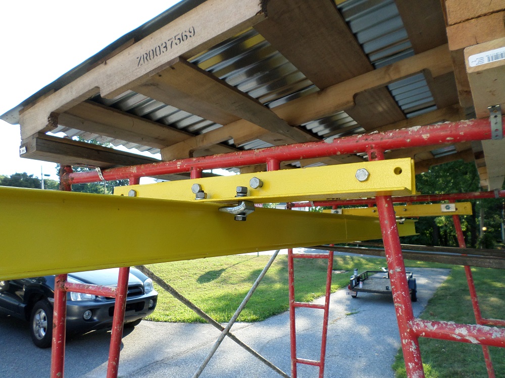

    For the assembly process, I had a few pieces of equipment at my disposal... a Forklift, Skid steer and a good friend... With that, we proceeded to set up the scaffold crane.
    I had sourced three section of 6'6" walk through scaffolding. I only ended up using two sections of it.
    First we assembled one section of scaffolding with the braces. Then the 3" angles were bolted on to sandwich the scaffold buck frames. Then we manually lifted up the I-beam and used beam clamps to secure it to the angle irons. I ultimately had to put a spacer in between the I-beam and the angle irons as the trolley was interfering on the beam clamps.
    While we had everything on the ground, we also constructed a roof over the scaffold crane. The roof was simply made of a 4x8 pallet I had with some spacer blocks screwed on one side to give it some slope. Then I cut some corrugated tin to length and we screwed it into place. The roof skid was lifted on top and strapped into place so it would not blow off.
    The harbor Freight hoist and trolley was also installed. Notice that there are angle clips on the end of the beam to keep the trolley/hoist from sliding off.

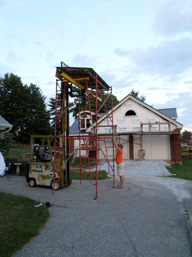

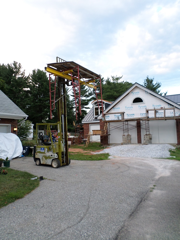

    The next step was to get sufficient height that I could use it. This is where the forklift came in extremely handy!!!
    We simply lifted it up until we could assembly an additional section of scaffolding under the first set!
    My friend was a little hard pressed to get the connector pins in... I took care of that after snapping some pictures...
    The forklift doesn't do off-road very well, so the next step was figuring out a method to move this beast.....

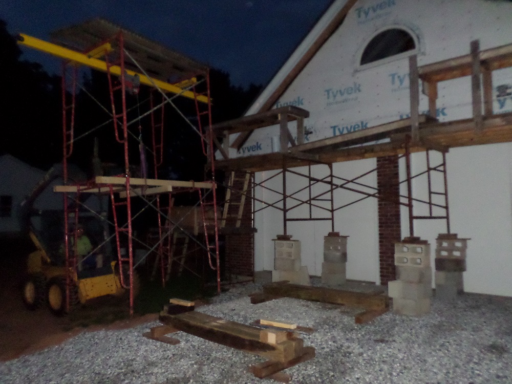

    Enter the skid steer. It doesn't lift more than about 8' at the pallet forks, but that would be sufficient for this purpose.
    I installed some blocking across the lower section of the scaffolding. Then eased the skid steer in and picked it up.
    It was a little hairy moving it to the new location, but the key was to be steady and smooth on the skid steer controls. The picture is a little grainy as it was getting dark and we needed to get it done.....
    Notice that the hoist is being used to keep tension on the horizontal blocking as well as keeping the hoist from sliding around during transport.

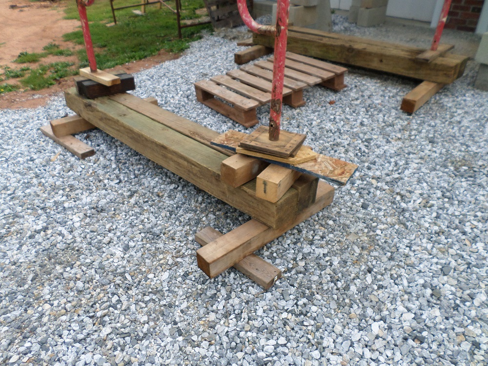

    For the time being, we used some blocks and cribbing to get the scaffold tower crane leveled and plumb. I wasn't totally thrilled with the blocking, but it would work for the moment....

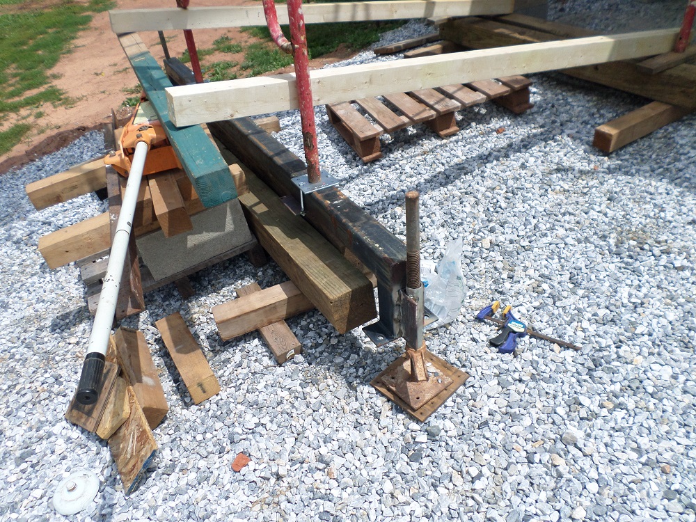

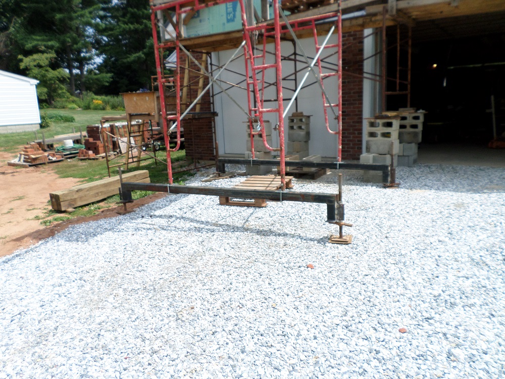

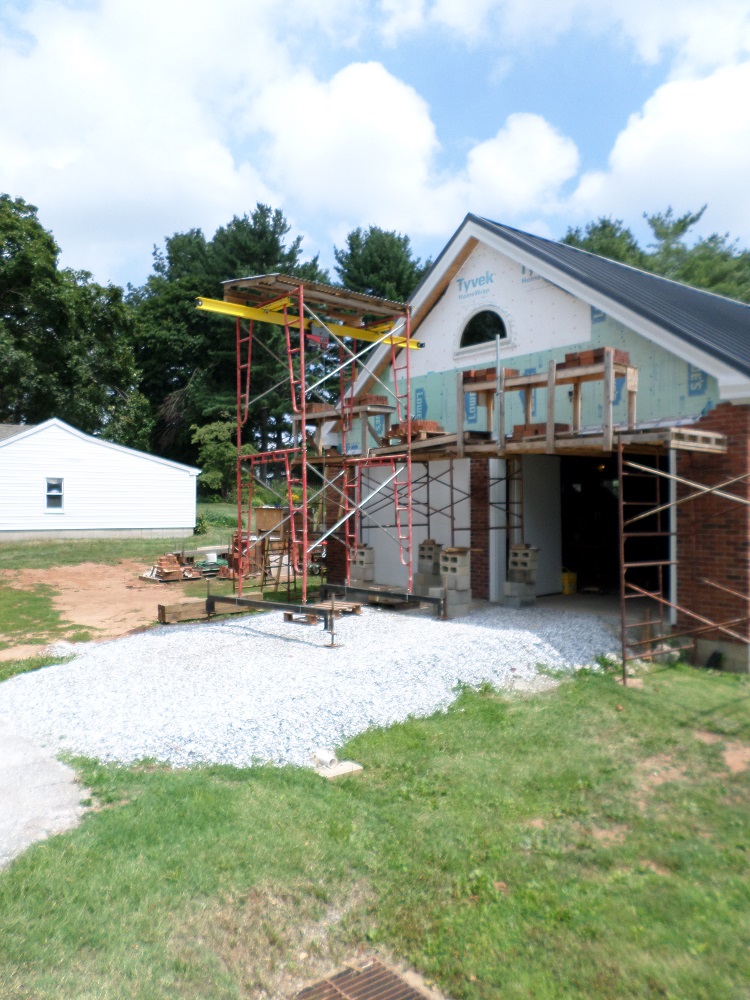

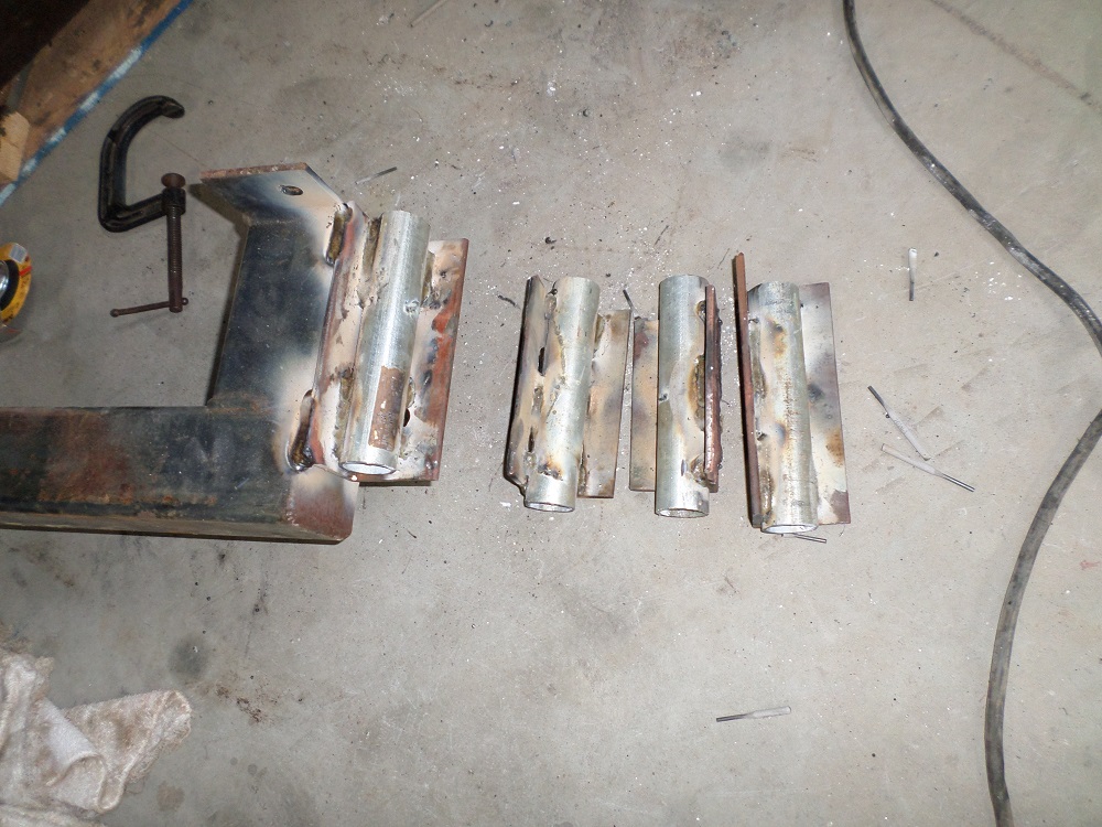

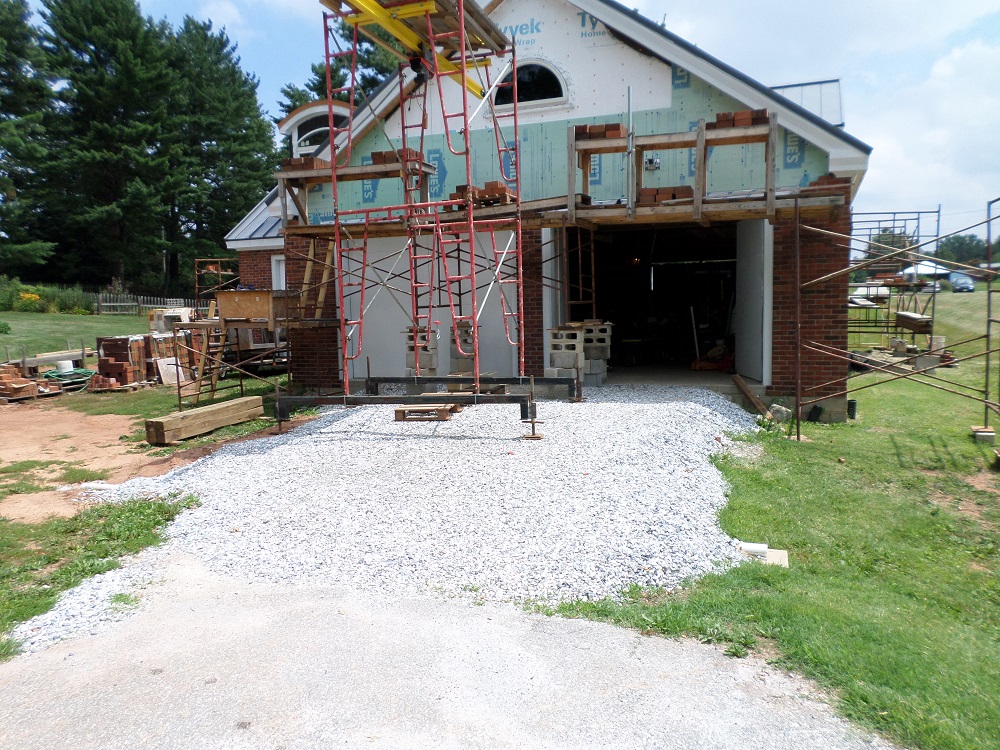

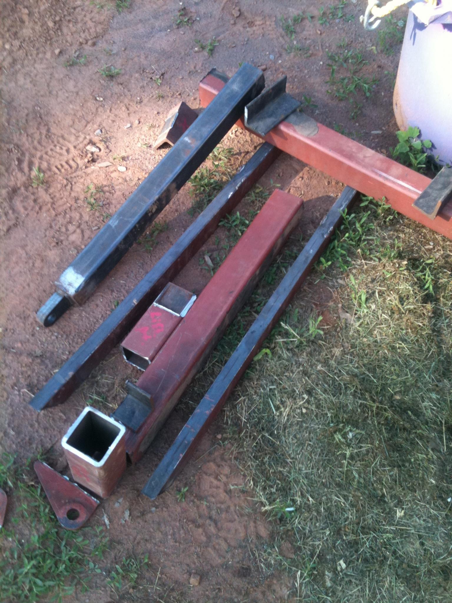

    After a few cycles of brick were hauled up with the crane, I quickly became aware of the need for a better base. The wood cribbing was just not stable enough. I needed the tower to be a little taller and I wanted a wider base. I would also be moving the tower crane at some point and I wanted an easier method to level it.
    I had salvaged some 3.5" square tubing that was about 9.5 feet long. I found some heavy wall pipe that my scaffold adjustable feet would slide into.
    To ensure that I got a secure attachment, I first welded the pipe into some angle iron. This way I could get four good welds onto two different edges. The angles were then welding onto the steel tube. The tube already had some 6" long short sections welded on each end from the previous purpose. These "C-Channels" gave a good surface to weld on the adjustable feet brackets.

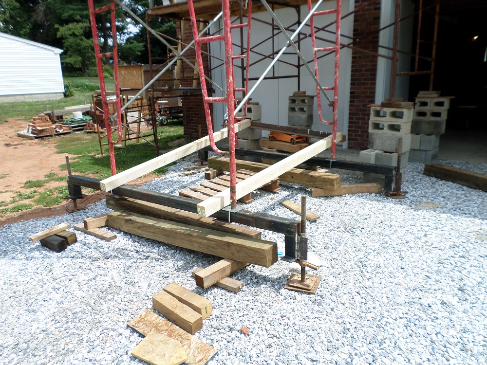

    Once I had the two outriggers complete, I needed a safe way to install them....
    I used a variety of wood beams and a jack to ease up the end of the scaffold tower and slip the new outrigger into place. Also notice that I bought some scaffold end pads to bolt the scaffold leg onto the outrigger.
    Then I did the other end and adjusted all the legs so that the scaffold was level and plumb.
    Much more stable and secure!!
