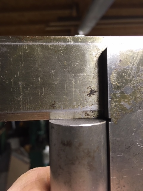

    Hi All

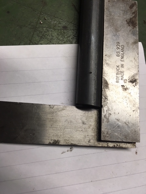

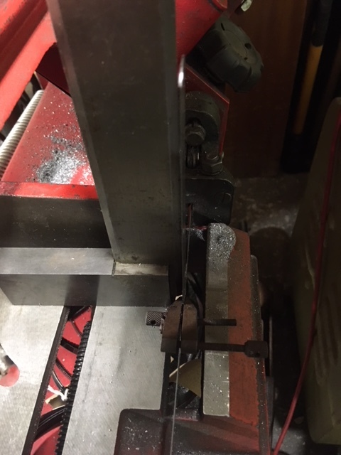

    While sawing up the material for the retractable internal tool holder on my 4x6 band saw I noticed how out of square it was cutting. When cutting smaller sections it is not that noticeable but as the stock size increases, it magnifies the error. This is the simply method I used to realign the bearing guides and the saw is again cutting straight. This poor little saw is now 20 years plus and sits in the workshop and gets used and abused with next to no maintenance but is still going strong.
    The first couple of photos show the problem

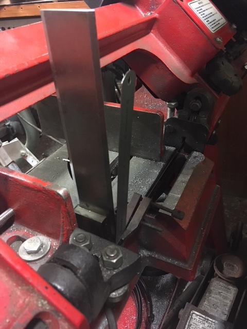

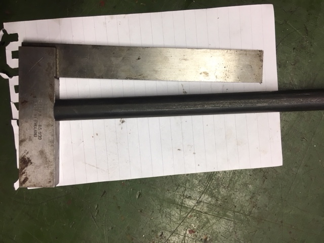

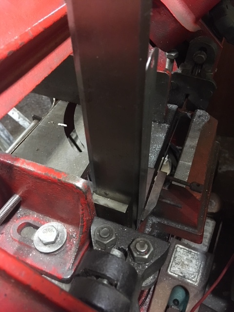

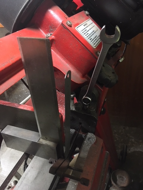

    The next photos show how I fixed the saw issue. To try to place a square against a ½” blade to check it is vertical is quite difficult. To overcome this a 6” rule clamped with a small tool makers clamp to the edge of the saw blade gives a good indication on how far the saw is out. With a square placed against the rule, both bearing guides are set until the rule is upright and therefore making the blade square to the base of the saw vice.
    Saw not cutting stright-img_0553.jpg Saw not cutting stright-img_0554.jpg Saw not cutting stright-img_0555.jpg Saw not cutting stright-img_0556.jpg
    The last photo shows the saw once again is cutting square.

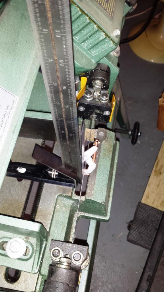

    Good advice and am now curious about the accuracy of my Enco 4X6 bandsaw. I tend to take it for granted that it would remain very close to being in alignment after my initial setup. I checked this morning and the bandsaw blade was not perfectly aligned relative to the saw vise table and as you can see below. I checked by clamping a stiff 6" rule to the saw blade with a Kant Twist clamp and compared the 6" rule gap with a combination square. There was a significant gap at the top and had to be corrected.
    I now fixed the errors in the blade vertical alignment and also the right angle to the stationary vise jaws. Periodically checking is the best approach rather than wasting metal stock.

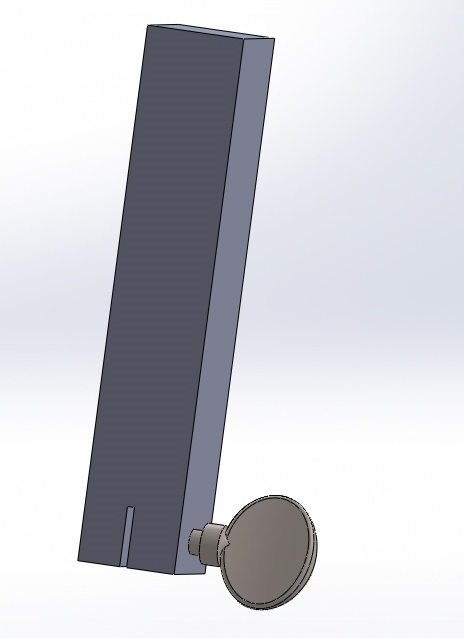

    If I might add I have used a very similar method for setting up saw blades on various size band saws for years the only thing was though I found that it was often a little tedious trying to clamp the scale to the blade with the small makers clamp while at the same time holding the scale positioned just above the teeth of the blade so as not to incorporate the set of the teeth into the the mix. so I made a pair of slotted gauges to fit which ever saw I needed to adjust
    they looked something like this Just a piece of sq stock with a slot cut into the end and a thumb screw to tighten it to the blade, the depth of the slot was just shy of being deep enough to reach the teeth. We made them and included a pair to fit the blades of every band saw we sold
