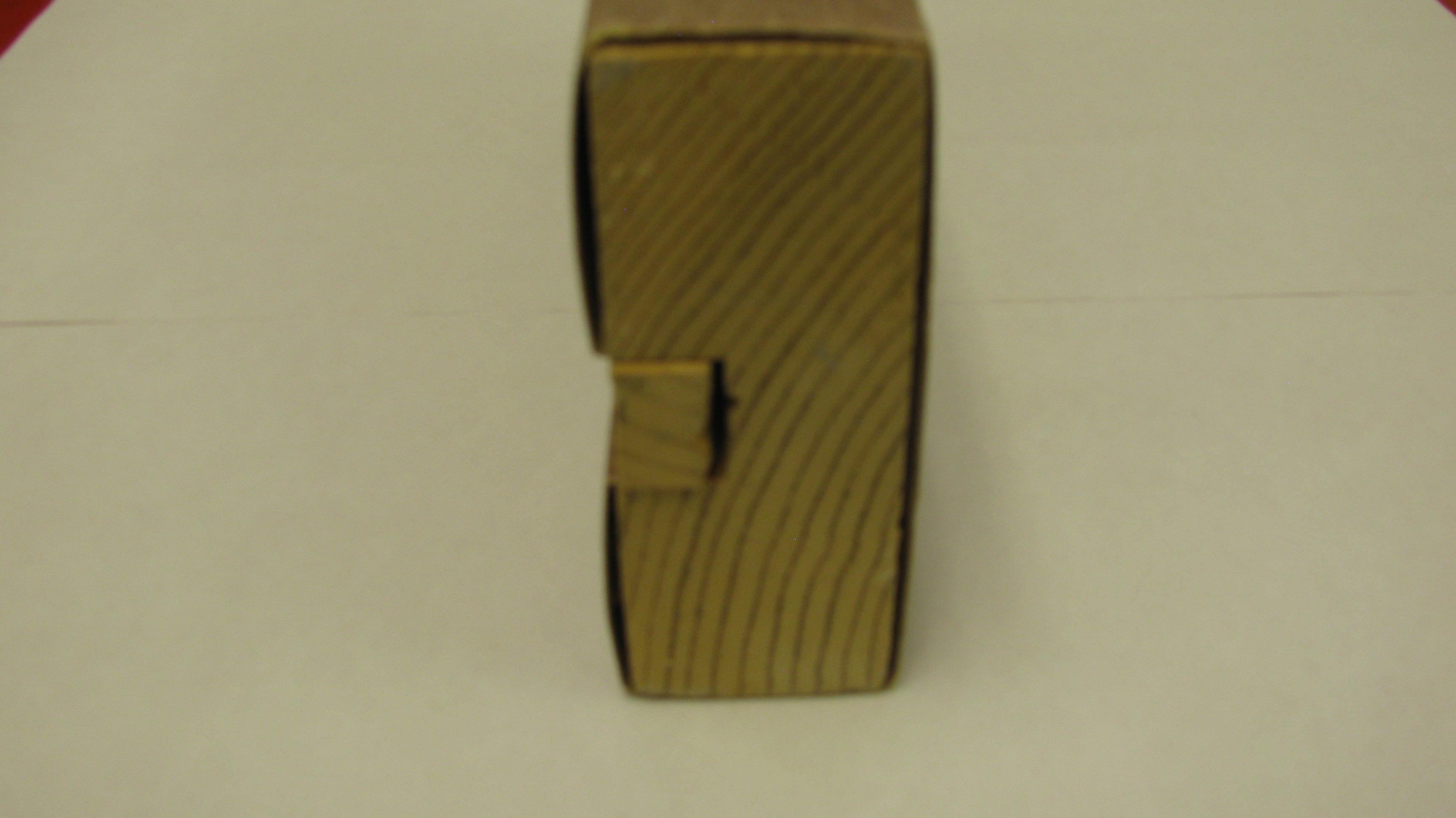

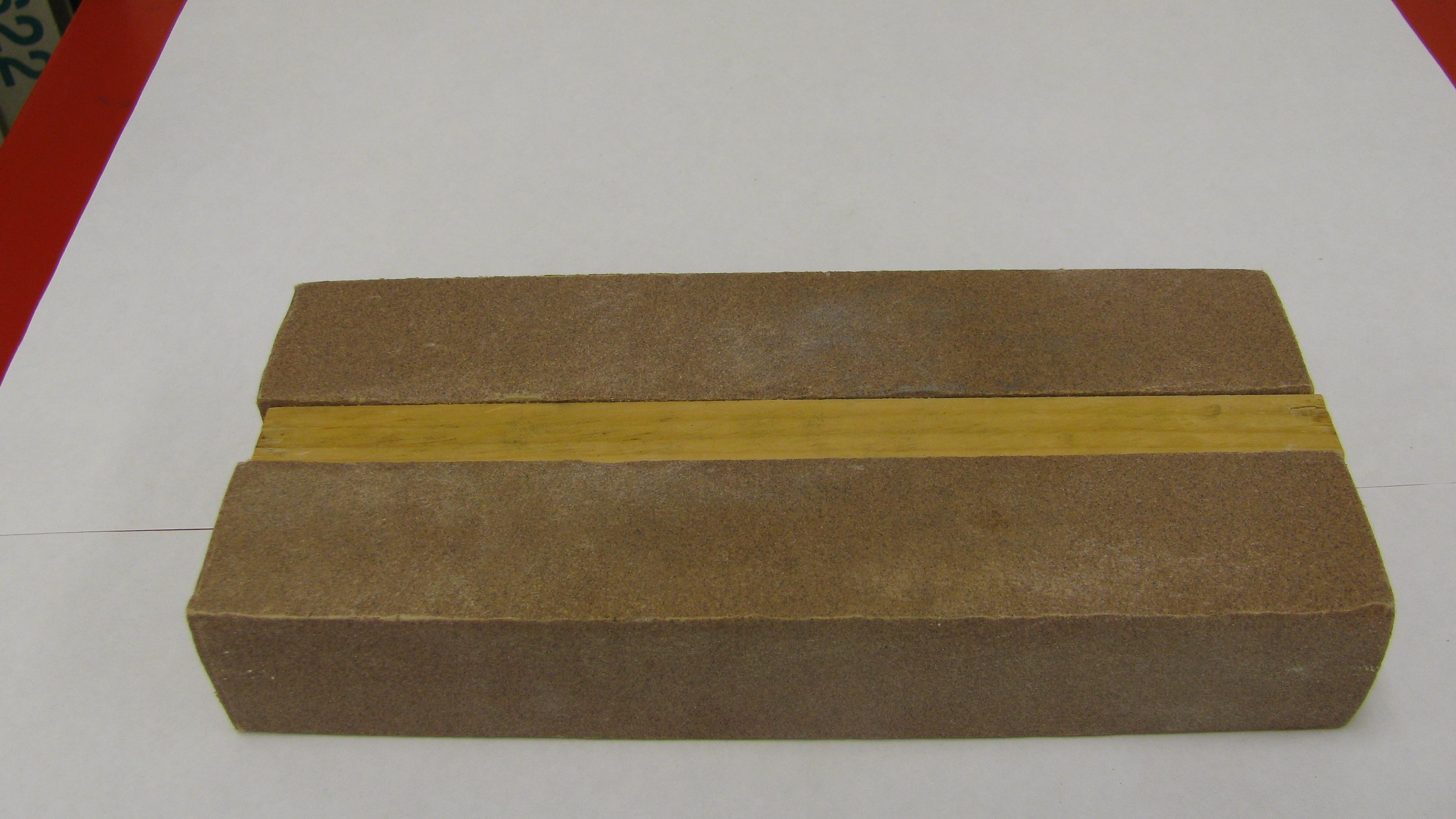

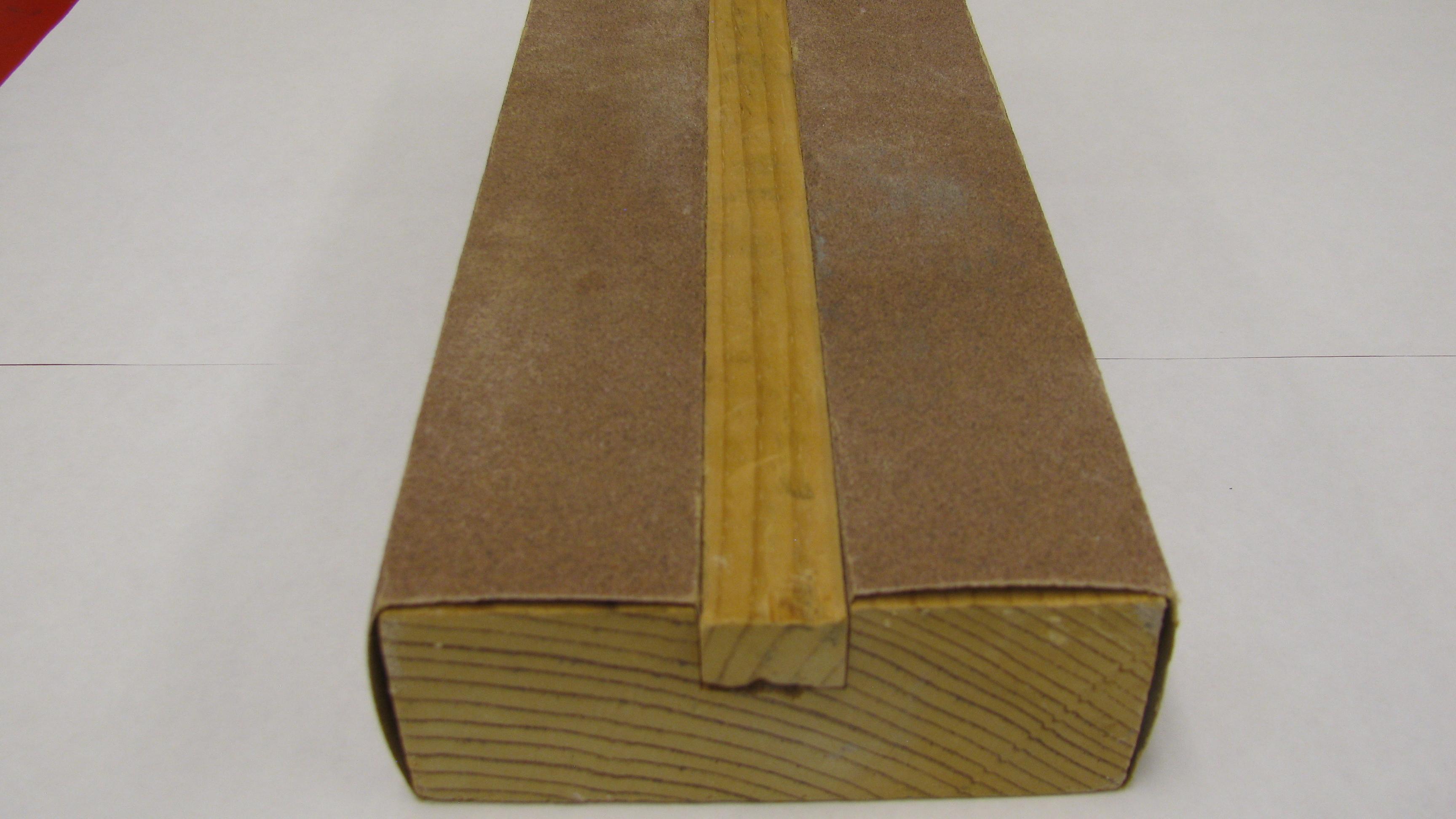

    Have not seen this version of a sanding block on the forum. Thought I might share this tool with the forum. It was first observed some fifty odd years ago in one of the tool shops of my employer and I thought I might share it with the forum. It requires a block of material large enough to accommodate a standard 9” X 11” sheet of sand paper or emery cloth and a wooden key to retain the sanding paper. The key can be rectangular or wooden dowel. The only tool required to produce this DIY tool is a table saw to keep things straight and square.

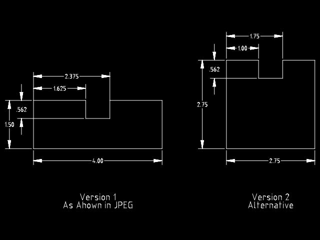

    I have included a photo of one configuration and a sketch of an alternative configuration. This one I loaned to a friend, must have grown legs.
    In any case either one needed are quick and easy to make.

    Both of the pictured blocks are dimensioned such that a strip cut from a standard sheet of sandpaper will just fit without any trimming required.

    The blocks are intended to utilize a full sheet 9 X 11 inch paper. This should leave approx. 3/8" each side of the sheet that will fold
    into the channel and held in place with the rectangular key or dowel. I apologize if I left something out of this narrative. In the event
    that the paper comes up short for some reason, a simple remedy is to narrow the block. The configuration of the block can be made
    into just about any shape desired, such as a hexagon or wedge, still utilizing the channel and key.
