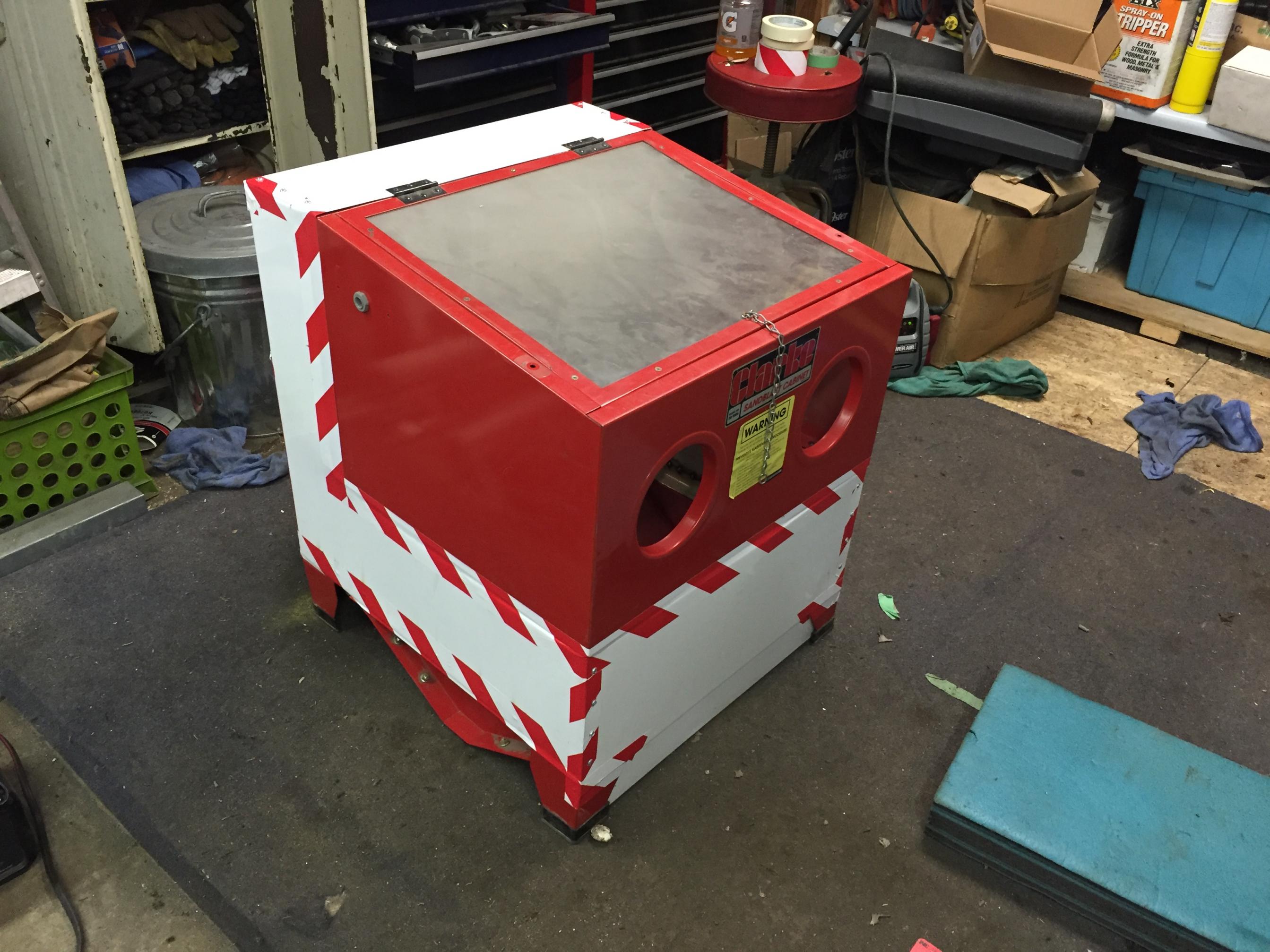

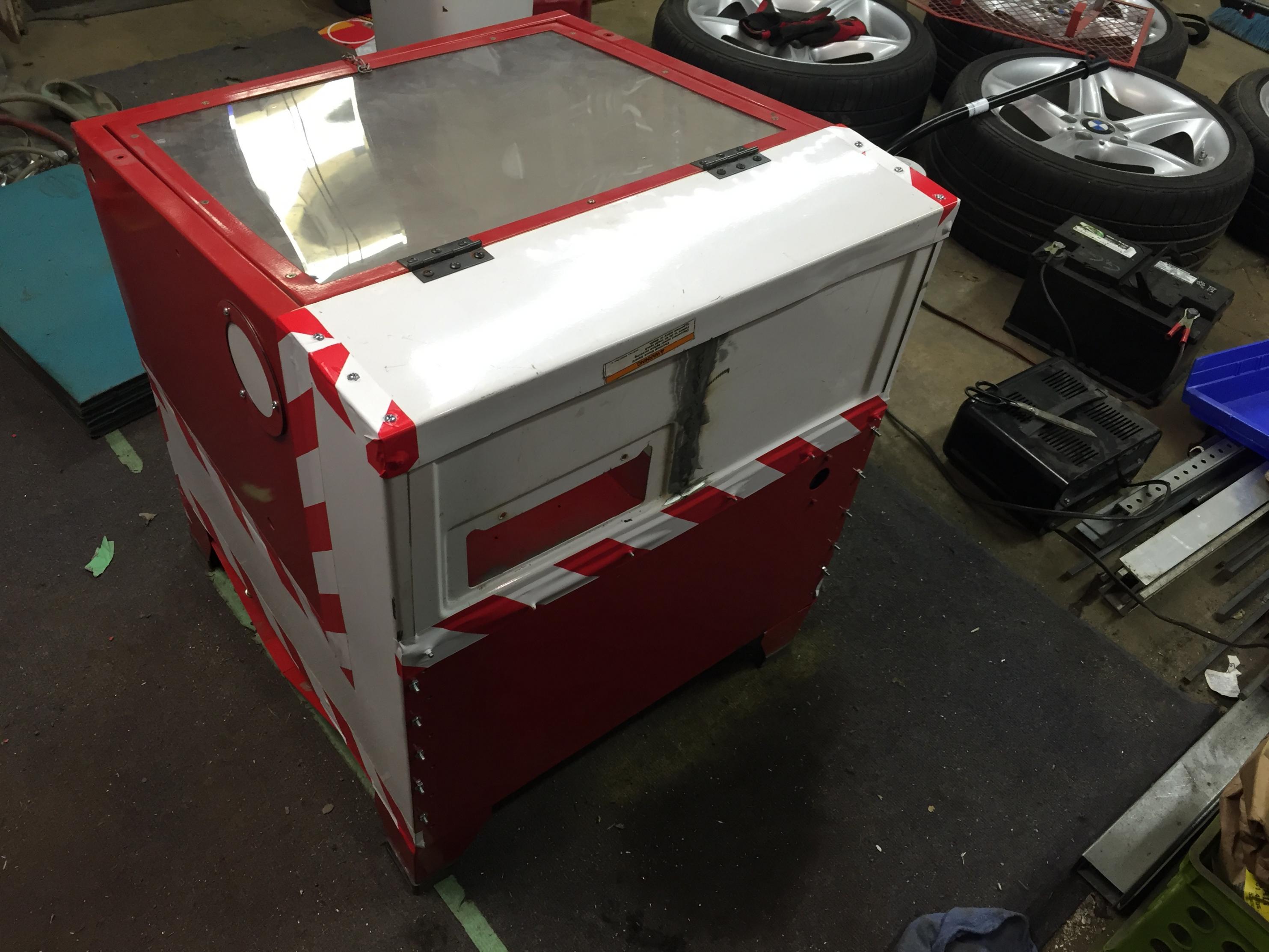

    Clarke brand, but same as most Chinese tabletop units. Identical to the Rural King branded one.
    The white panels are from the same drier shell I used for my lathe tray. The L-shaped white panels are flanged and spot-welded to the original cabinet. The rest are fixed with automotive foam tape and bolts. I removed the rear panel and lowered it to provide structural support.
    The tape merely hides the seams. I was planning to paint the seams, but I found this tape and thought I'd go for a black box vibe instead.
    Sandblast cabinet enlargement-img_2469.jpg Sandblast cabinet enlargement-img_2472.jpg
    A few in-progress shots.

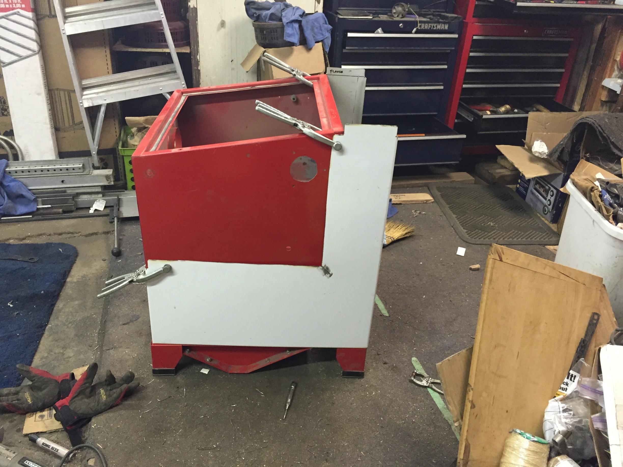

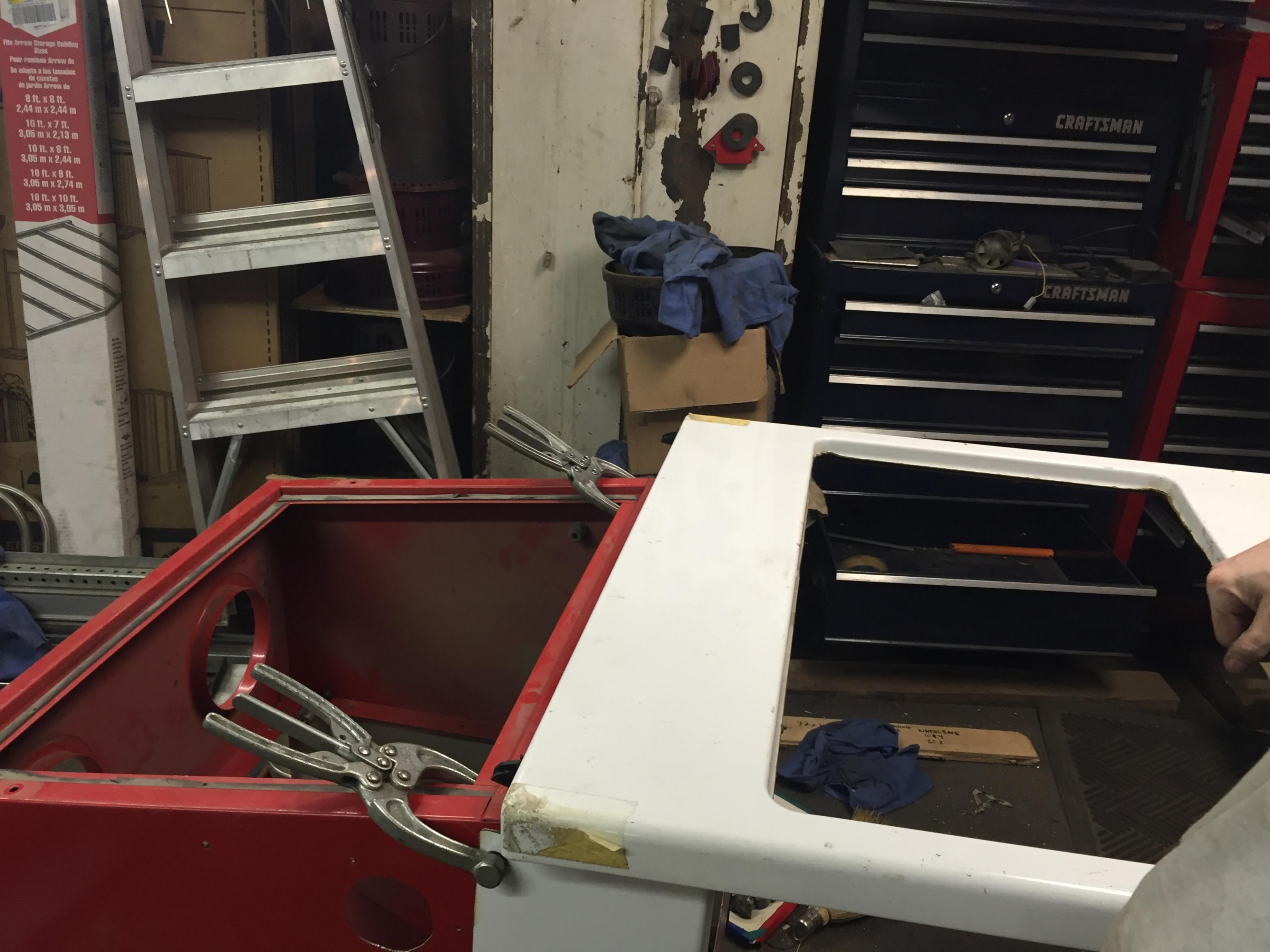

    Before I bent the flanges:

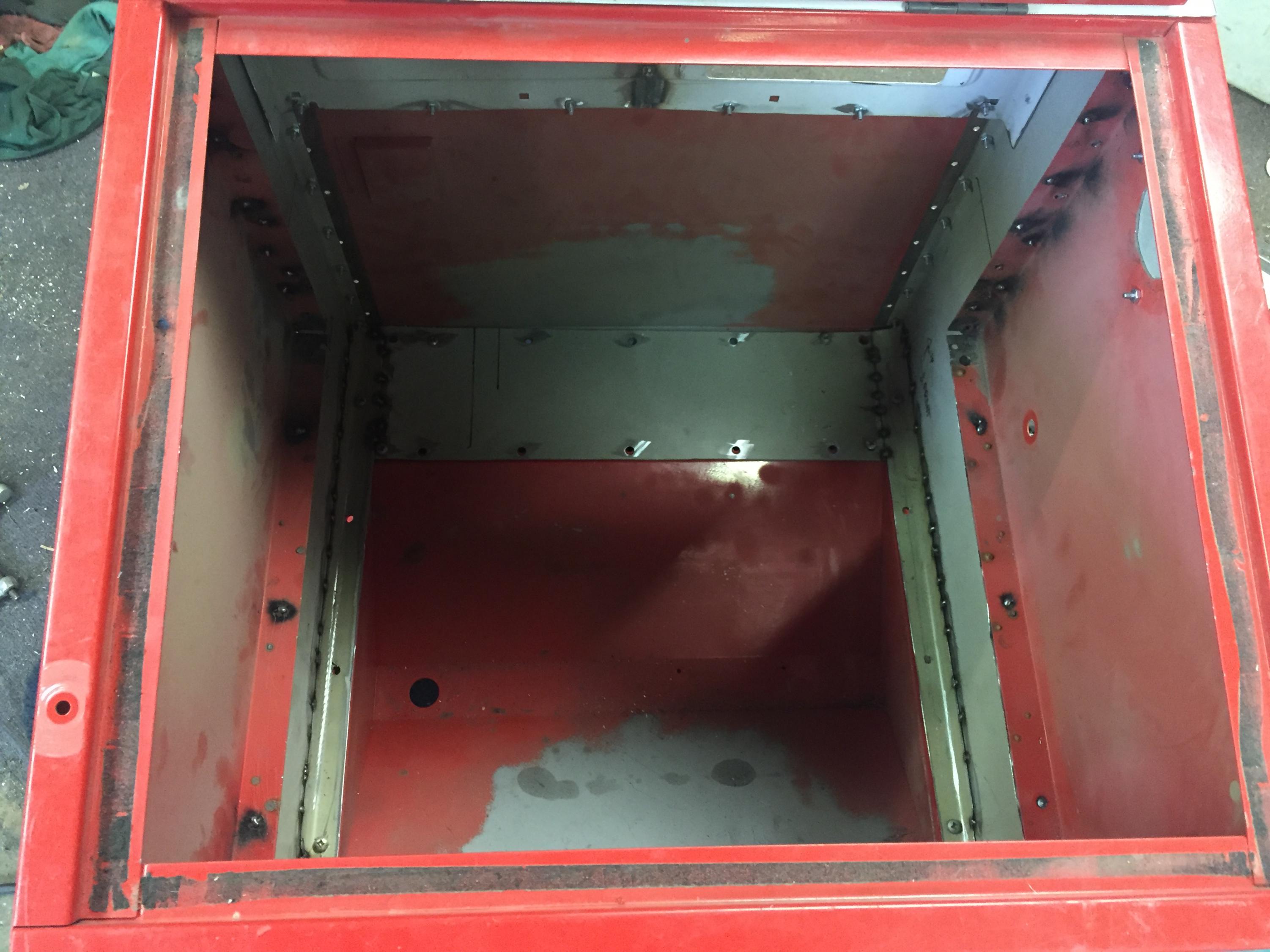

    After plug-welding the sides together:
    Checking for size:
    Sandblast cabinet enlargement-img_2348.jpg.

    I never had a problem with the pickup tube itself, so for now I'll re-use it. My biggest problem was that the media would not flow to the pickup tube's opening, and there's no good way to funnel it without adding height to the cabinet. I'll make something up when I get that far.
    I relocated the air inlet to the upper front corner and install a double swivel at either end of the flexible hose inside the cabinet. These keep the hose out of the way and prevent kinking.

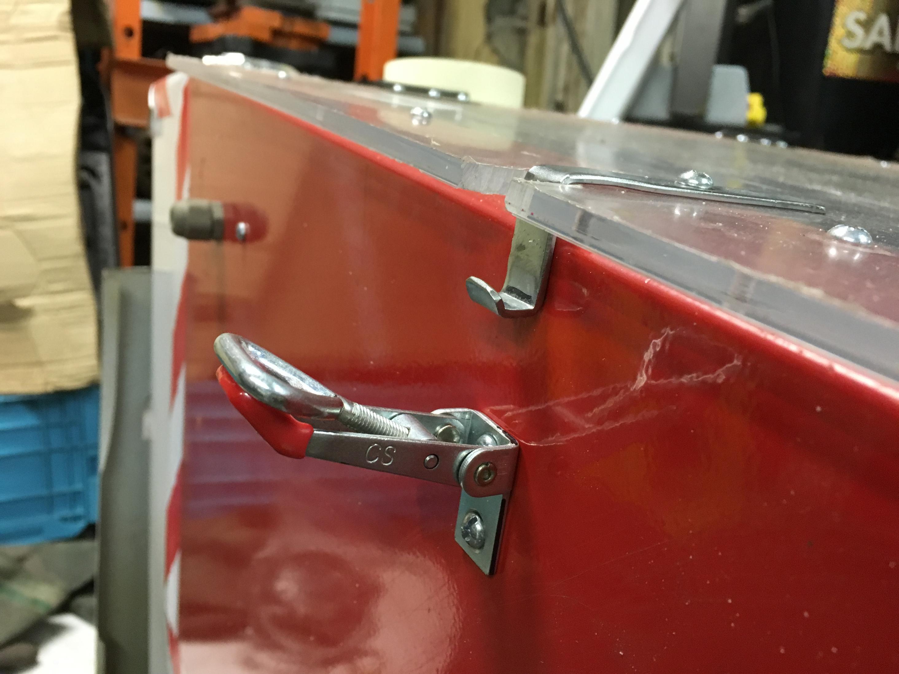

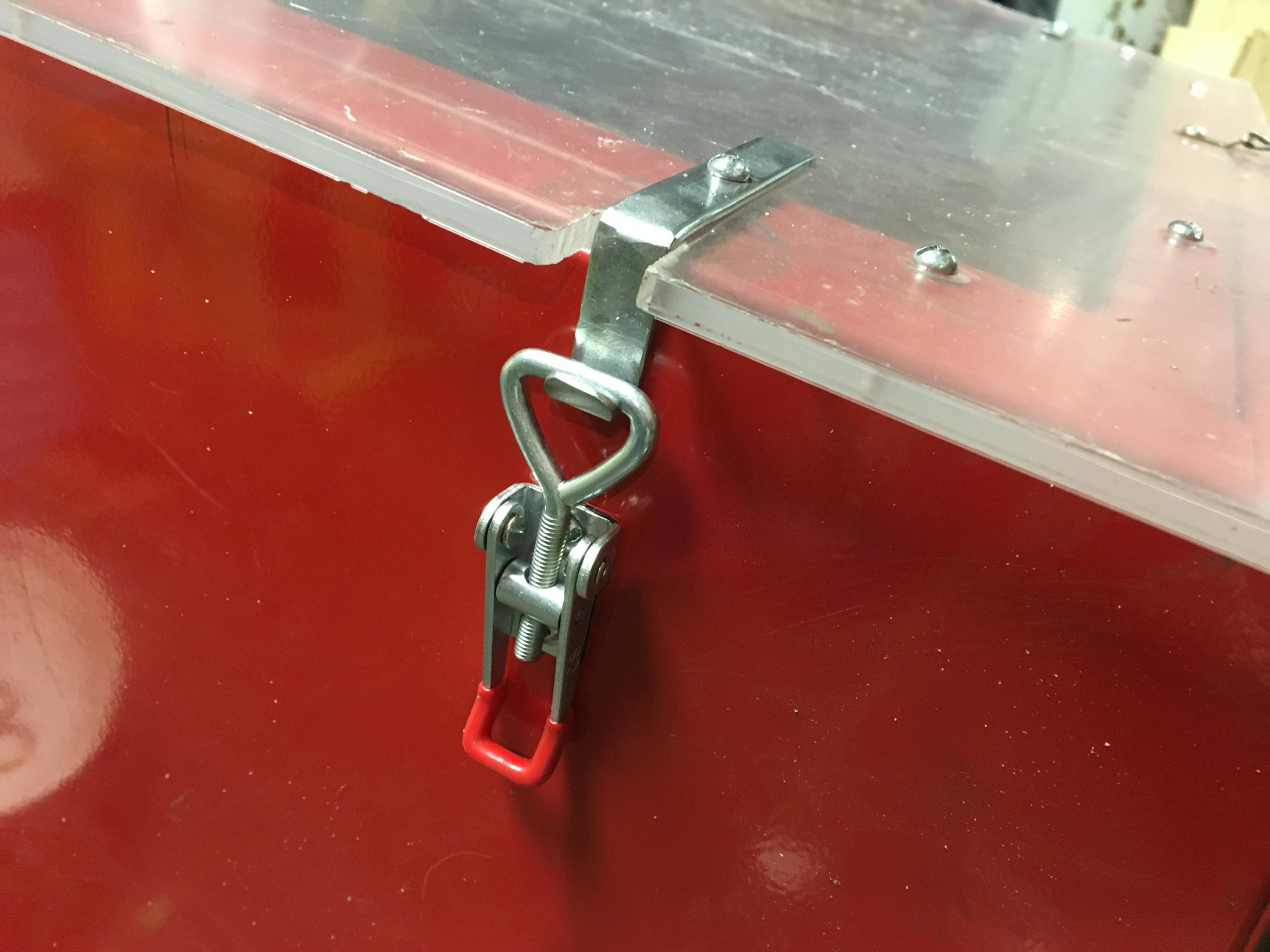

    I haven't done much with this cabinet because reasons, but I added new latches this weekend. The hooks are made from some locking clips from parts of the hanging bracket of a microwave oven/stove vent fan. The toggles are CS-brand (Chinese) DeStaCo copies.
    Sandblast cabinet enlargement-img_2516.jpg Sandblast cabinet enlargement-img_2518.jpg
