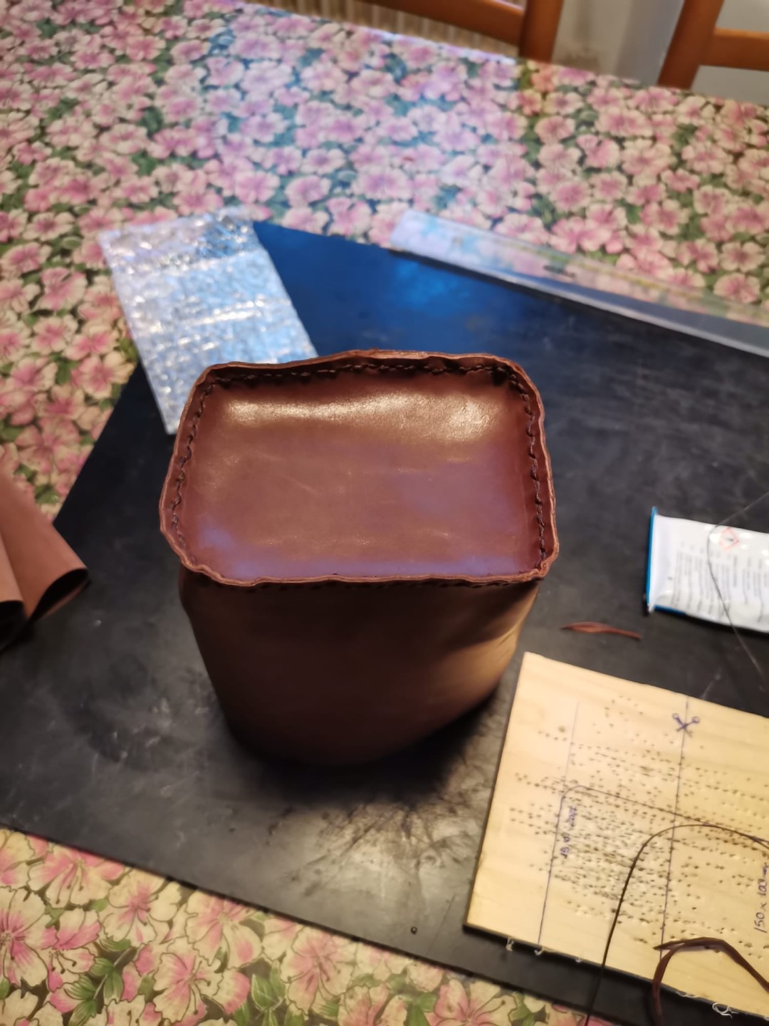

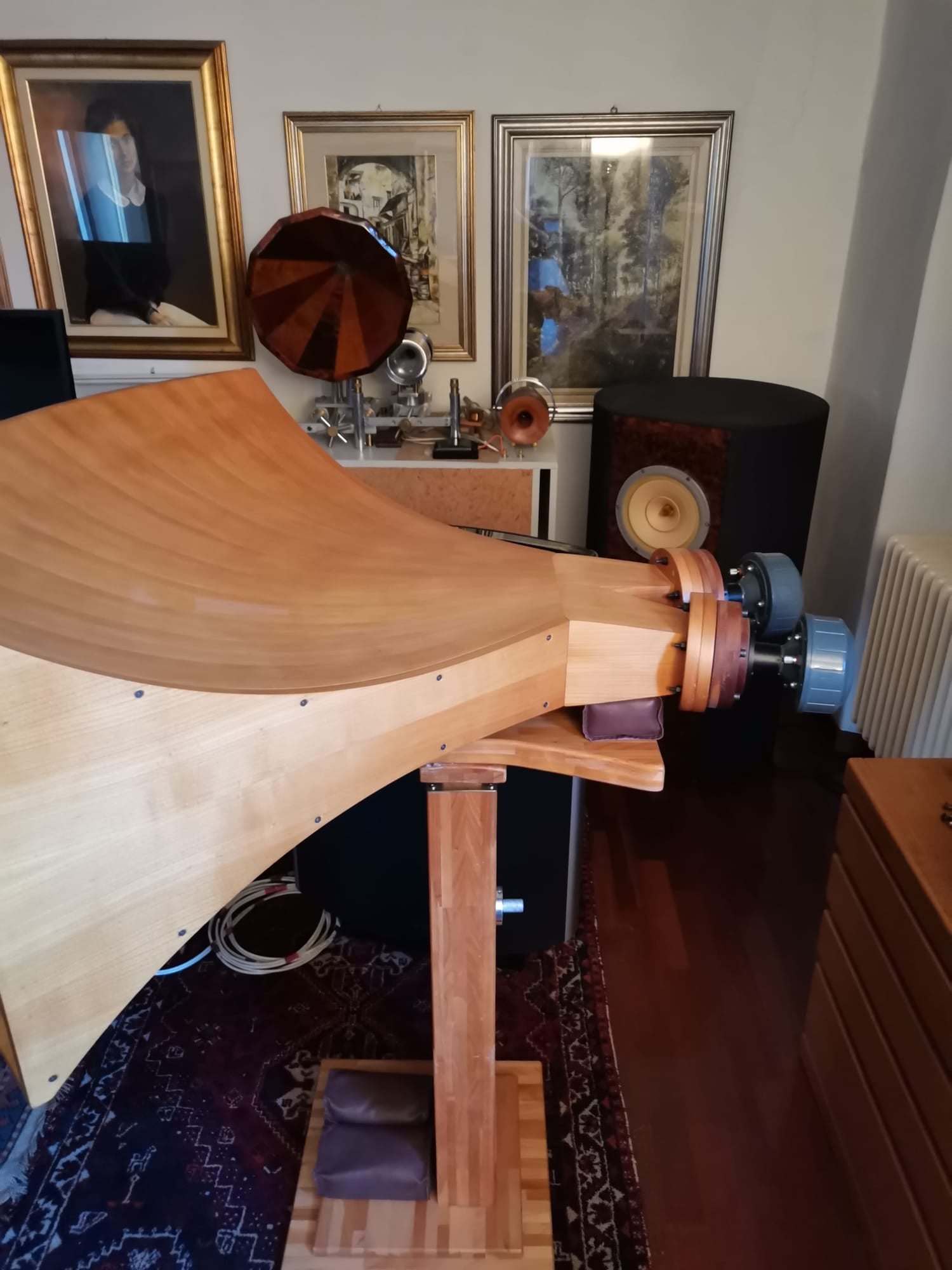

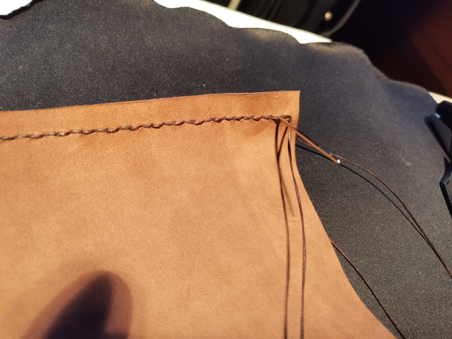

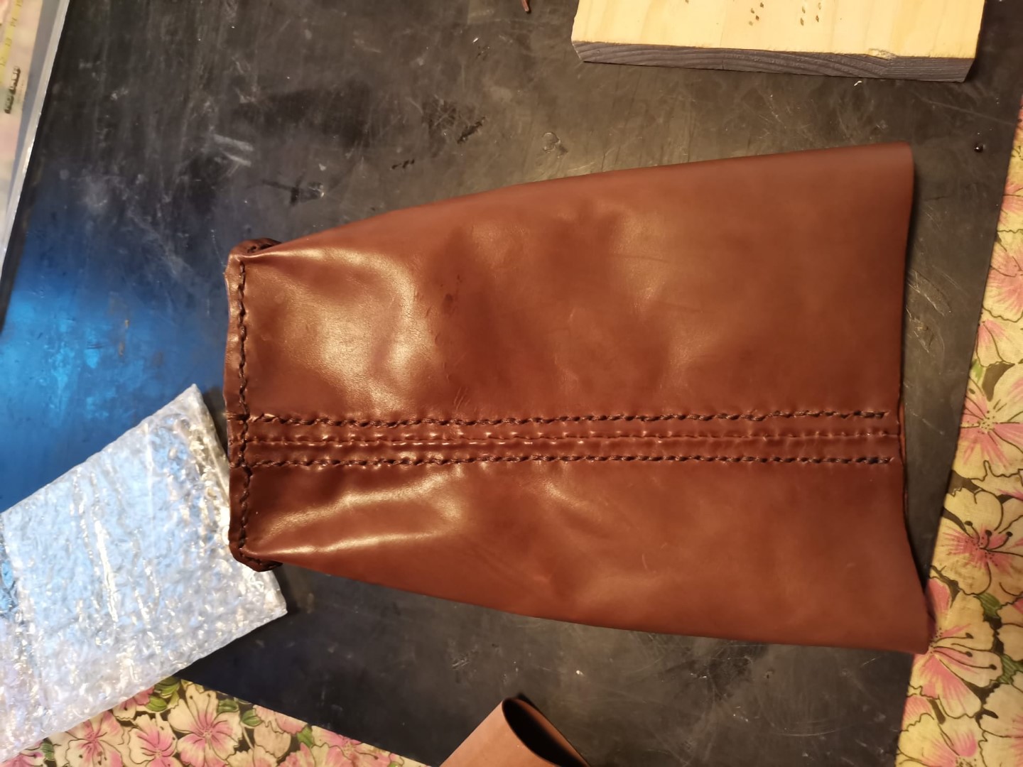

    Hi!
    Just finished a set of sand bags, useful to press or keep objects with curved profile, or as a beater bag.

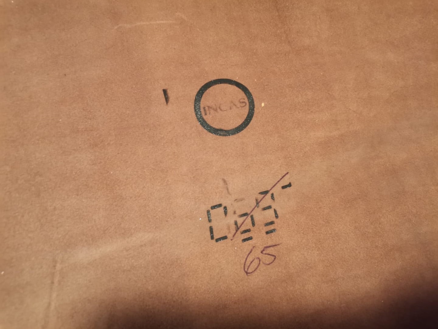

    Considering my purpose, as big horn stand, I decided to use oiled calf leather (from Incas, a very good italian tannery), hand sewn with waxed twine. I poured 2,5kg of dried sand in each bag, they are pretty stable and copy the pattern of the object.
    Sand leather bag-img_20220325_233030.jpg Sand leather bag-277164219_351140020278157_8849938562916648791_n.jpg Sand leather bag-276993151_351140030278156_7438191749972465566_n.jpg

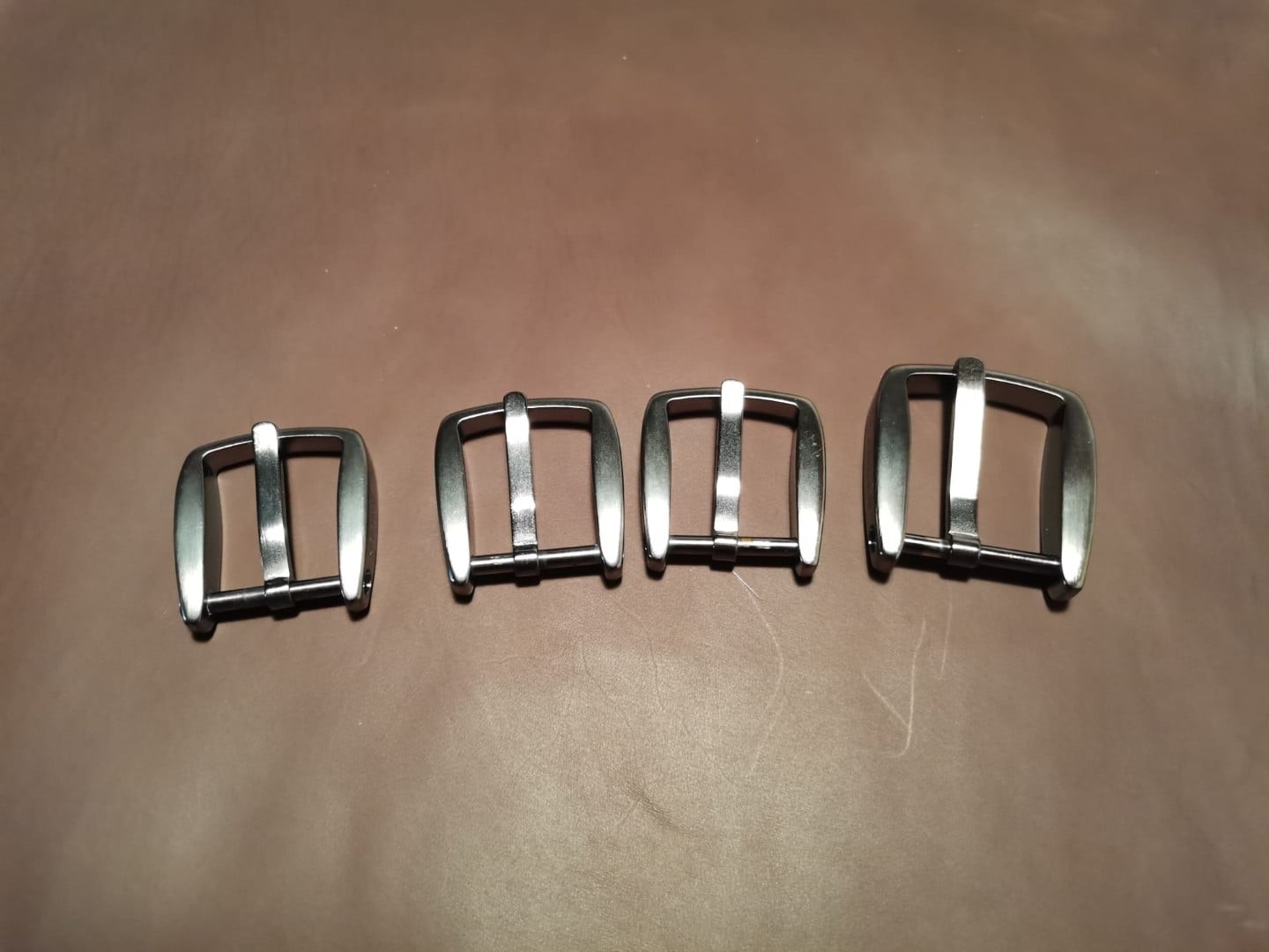

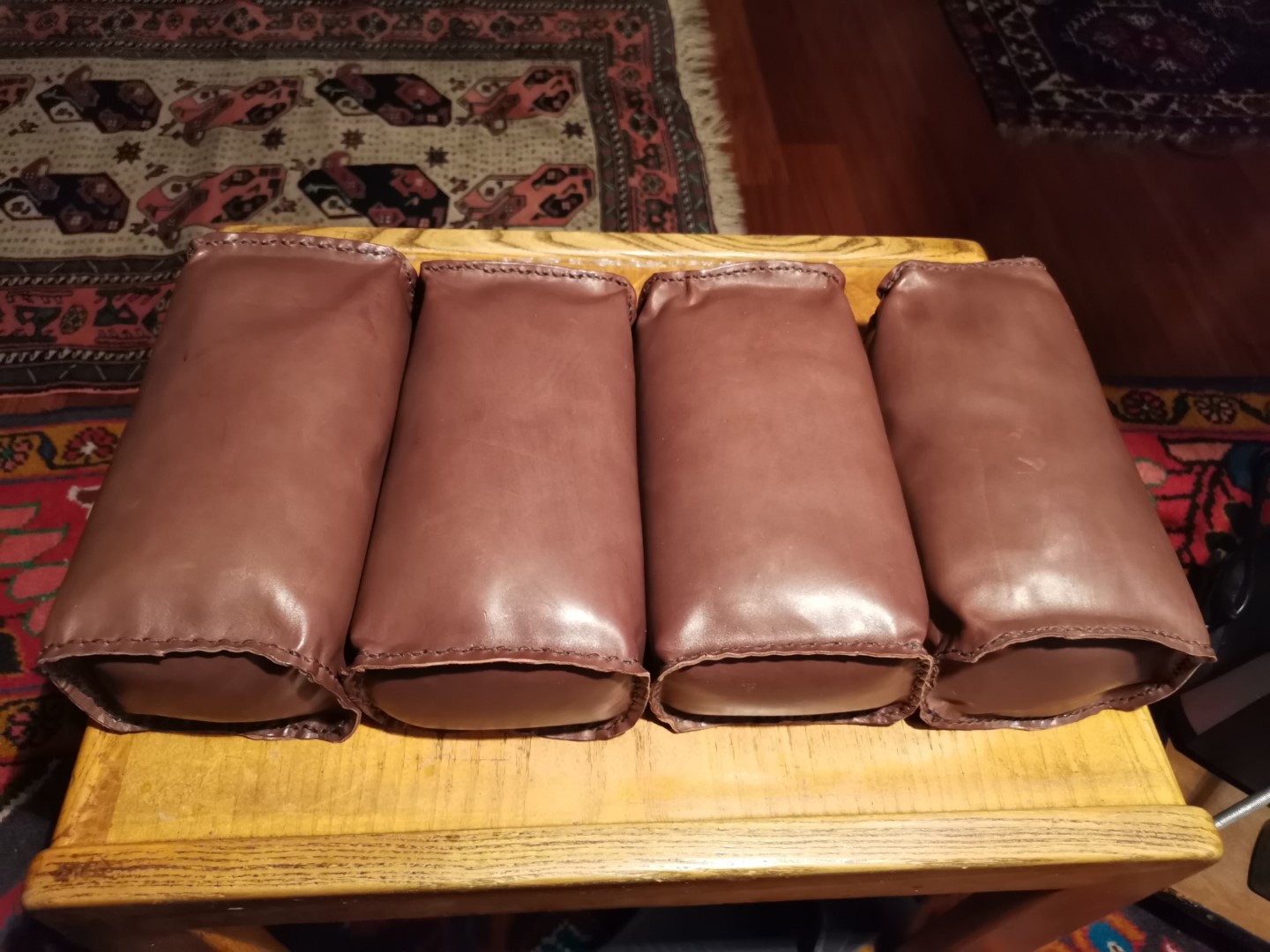

    Thanks for the info! I've been away from shooting range for a while, I just saw a picture about the patch pocket, it seems a smart trick to seal the inside. I tested the sand bags, everything is ok, the balance is correct, I added leather belts just in case.
