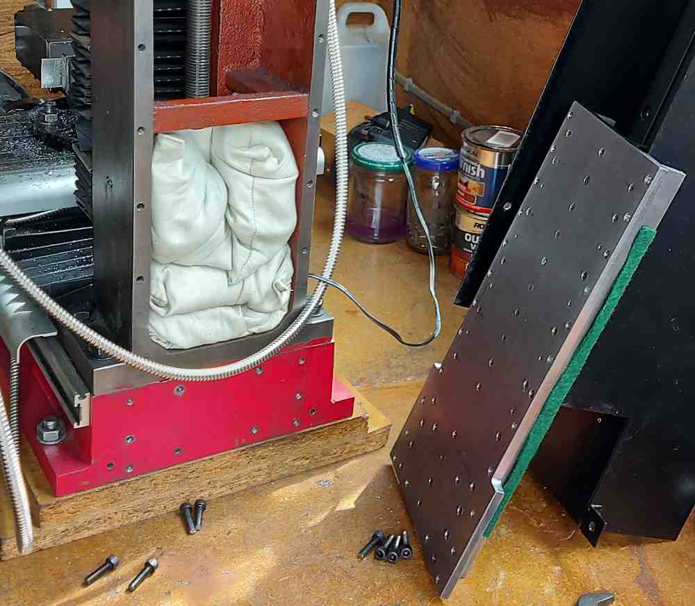

    Just made up some small sand bags to fit in a cavity of my milling machine and damp down the vibration.
    This idea though could be applied to other machines. Just take care that the sand and bags are secure and cannot get caught in any moving parts.

    I've seen a drill press with the column filled with oiled sand to dampen vibrations. I'm planning on trying it with my 2nd hand Harbor Freight mini-mill. And my Dad's old Craftsman drill press once I get around to doing the restoration on it. Somewheres FAR down the list...

    I've made some bean bags with cast iron granules in to place on the milling table and dampen workpieces and even the table. Again, mine are just 3.5x4" and weigh ~0.4kg (~14oz).

    assembly of the sandbags into the space
