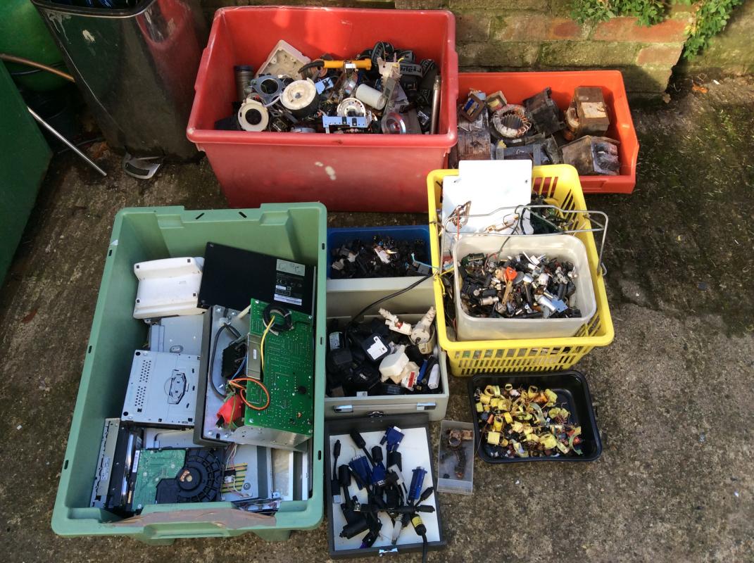

    Twelve years ago I realized the value of non-ferrous scrap when we moved warehouses and the sparkies left. From then, as well as wood and tools salvaged from skips, it went on to saving anything electrical, or plumbing, etc. The charity I work for, supplying furniture, has several shops and I have tried to promote the idea that instead of throwing unsold donations away, we could organise collections for their scrap value. With the exception of one manager, only the guys at the warehouse with me do this, despite banging on about it for more than a decade. Last week half a van load of IT equipment came in, so a lot of that I’ve dismantled.
    But it’s all getting out of hand. There are boxes within boxes, parts, smaller parts, sacks of flex (£1.30 per kilo), greasy copper, dry bright, zinc alloy, aly, pewter mugs(£10 a kilo) computer chips(do.) pcbs, stuff in the warehouse, stuff at home. More and more.
    If I can’t work at my bench or have to move boxes outside to get into the workshop, it’s got to stop! I’ve had enough. There’s far, far better things to do. I’ve set a deadline of two months, and by then all that stuff will go!

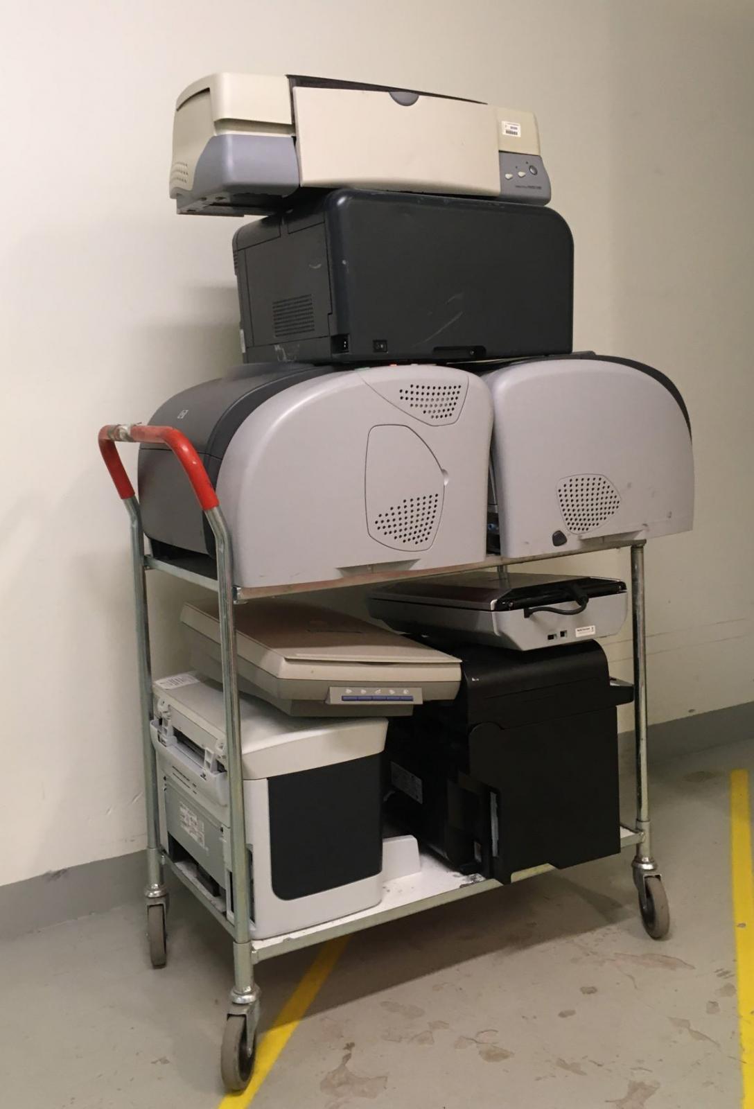

    Case study of stuff liberated from the Recycling center at work
    (shared with a foreign aid government agency, a commercial bank, an "Interweb bureau" and a lunch restaurant):
    About two hours of work in "de-constructing" these, using only screwdrivers, curiosity and brute force.
    6 printers including: a handful 1"-ish polished 12" precision steel rollers, 3 dozens of 4-8 mm 12" drill rod axles with POM or even oilite bearings,
    a dozen small DC motors with belts, some 4 & 6 mm roller bearings, some POM gears and other details, micro-switches and opto-couplers.
    A couple of electrical and Sprag clutches in 4-6 mm dia and an odd electro-magnet. Loads of small springs.
    6 PSUs with oddball DC V & A outputs, mains switches and RFI suppressing components.
    Some POM & PC plastic sheets could be useful, otherwise plastics goes to the bin. All structural steel to the metals bin.
    Personal gains: Besides feeling smug from saving the world yet again:
    Looking totally like a Smurf from the CMYK toner with ditto inked-stained hands for the upcoming week.

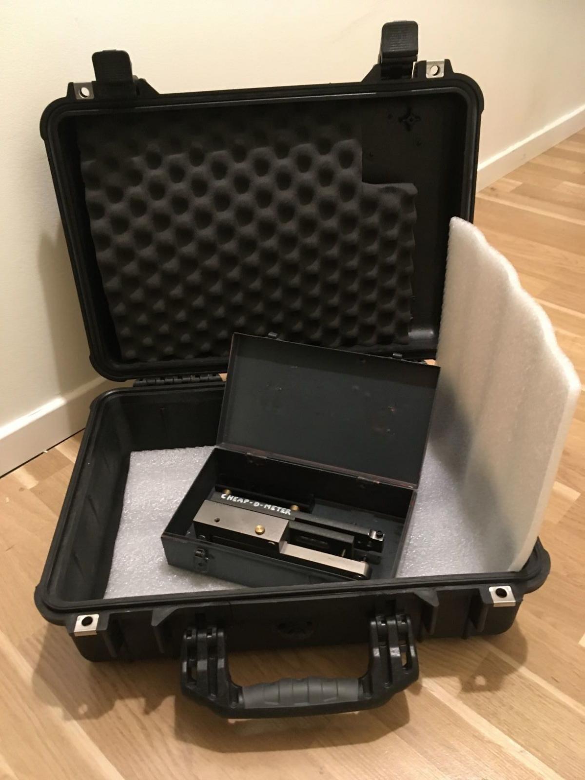

    Then, when I just dumped the scrap above - I found Providence had refilled the bins during the X-mas vacation:
    Yep - 150 bucks worth of hardly used Pelican 1500 Protector Case (sans foam) and a metal box for my "Cheap-O-Meter".
    Closed cell foam blocks and electric cutter all set in my shop to make the infills.
    Not too bad for a 2 hour "stay-behind" after work?

    You did well to dismantle those printers so quickly. I hope that they weren’t destined for general rubbish/landfill. I’ve been banging on for years about our organisation throwing away non ferrous scrap: I estimate we could easily have made £5k a year or more. Loads goes into the dustbins, yet we have a formal mission statement on the environment. Of course, it would have been my job to process it all. Since I was a “voice crying in the wilderness”, I’ve given up on dismantling, although I will still strip flex! (Not for myself, of course)

    I've gotten experience thru the last few years, needing the salvaged stuff both at work and at home.
    Really no need for wire cutters, figuring out to "reverse assembly" was pretty simple -
    keep as much wiring/ connnectors on, and each unit as complete as possible.
    Recycling centers are free of charge for private persons here, but "electronics"/ appliances will cost companies app 1 buck/ 2 lbs.
    Hence I offered my services dismantling 3 big color printers at app 150 lbs apiece.

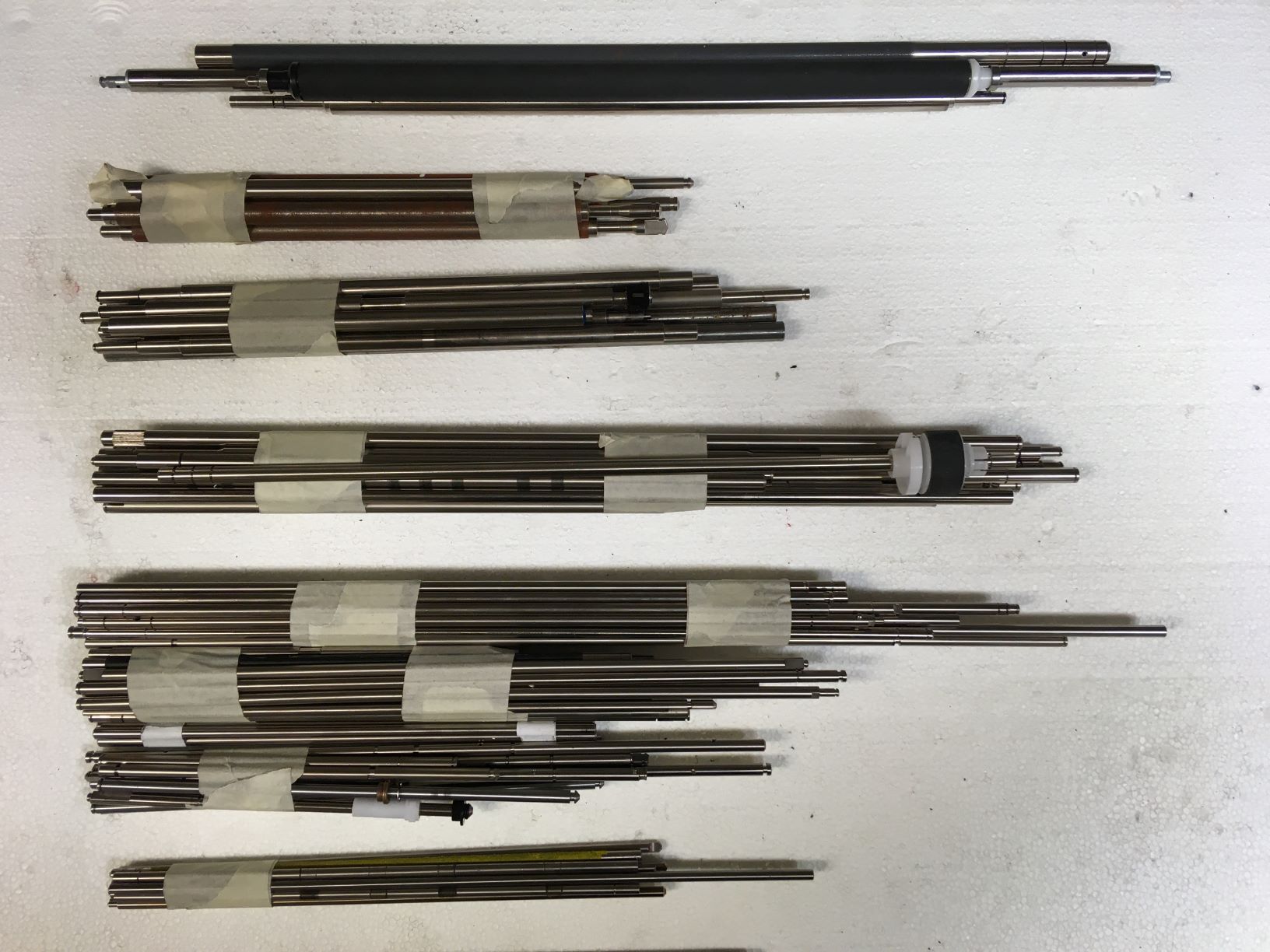

    Salvaged, cleaned and sorted thru some stock materials during Labor Day:
    This is 12 kg of silver steel/ drill rod (liberated from the stack of printers in the above post),
    that would've cost me some 500 bucks + pp from an online supplier around here:
    Bottom row: a few 5 mm, then mainly 6, 8, 10, some odd 11 and a few 12 mm ones at the top.
    The longest ones just over 500 mm for comparison, the bulk of them around 350 mm.

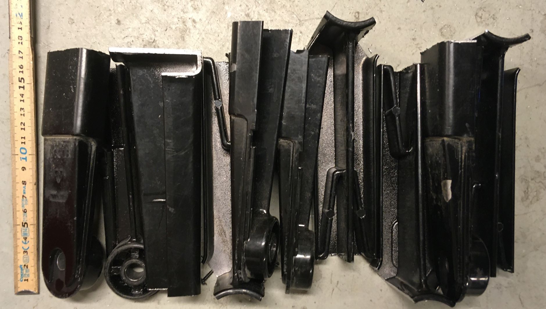

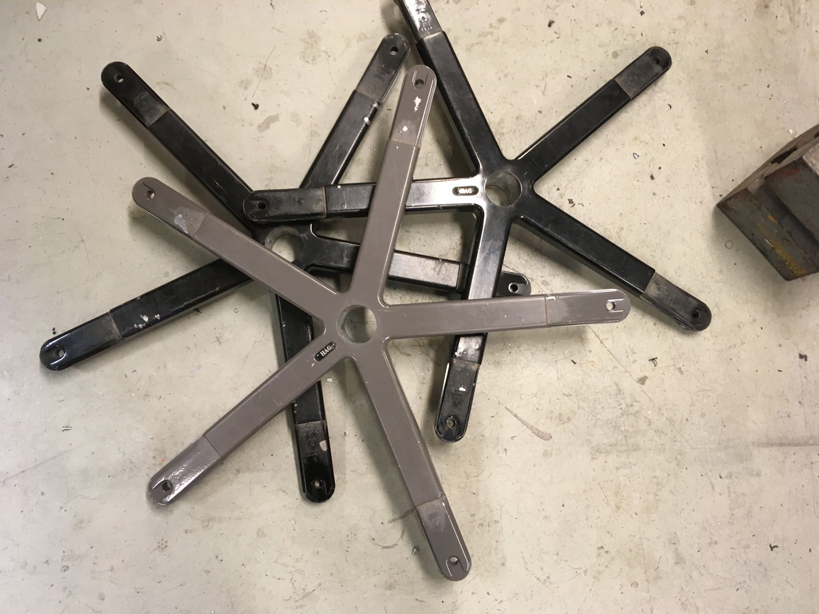

    Whilst at it, I also found a few chair stands, who were butchered for remelting into 5 kg of AlSi9Cu3 stock:
    Salvaging philosophy-5-kg-alsi9cu3.jpg Salvaging philosophy-5-kg-ready-crucible.jpg

    Very good! I still have a few of those printer rods, wasn’t sure what sort of steel they were, got rid of just a few to the engineers’ group, but came home with most of them! Chair parts I take to the merchants.

    AFAIK, the smaller dims below 10 mm are nearly all polished silver steel, which I've successfully hardened in water quench.
    The sponge/ rubber coated rollers are mostly BMS only inside, but I've had some unusual finds thru the years:
    16 or 18 mm polished (and perhaps honed), hardened massive rollers from the printer platen unit,
    they have some really tight tolerances, and I therefore use them for lathe alignment rods and flatness checks.
    Guess a few will also be used in an upcoming height gauge project
    Now having some 20 kg of drill rod/ SS axles I figure I'll be good for the coming years, health and providence willing.
