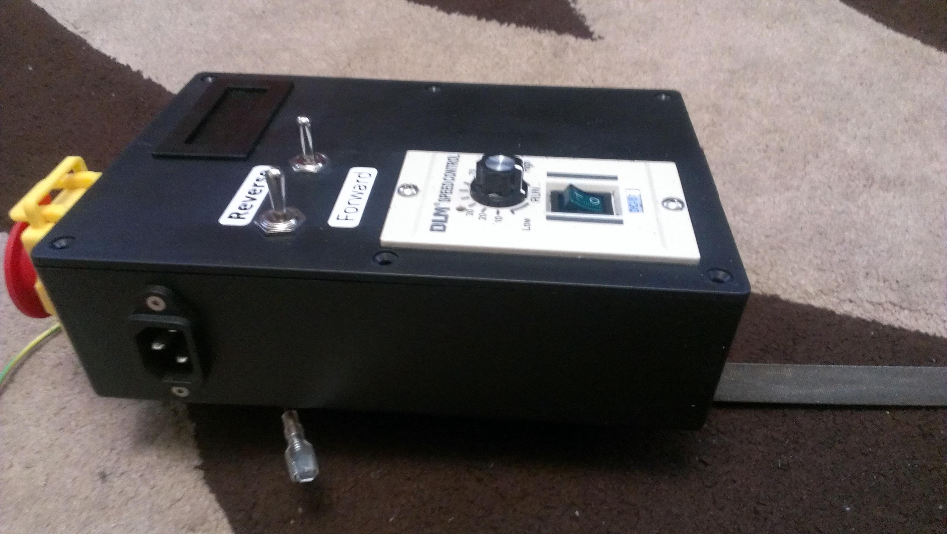

    Well as documented else where on this forum I tackled the sloppy Tailstock problem and started adding the Tailstock DRO (the barrel markings were very faint and Imperial only ) the DRO is both metric & Imperial at the press of a button.
    The next stage was to modify the "control box" with speed controller and dodgy switching from forward to reverse (the switching mod is detail elsewhere on the forum). I should explain the original OEM speed controls had been replaced by the previous owner with another chinese self contained speed box which he had fitted side ways so that for me setting speed was too close to the chuck for comfort.
    I re-arranged the layout in a totally enclosed box (shown in another thread) to keep swarf out of the electrics after hearing horror stories of long strands of excess metal infiltrating the electrics letting out the vital blue smoke that keeps electrons flowing :-)
    Having tried my new layout it worked but the newly added Tacho was now awkward to read.
    ORIGINAL DESIGN:-

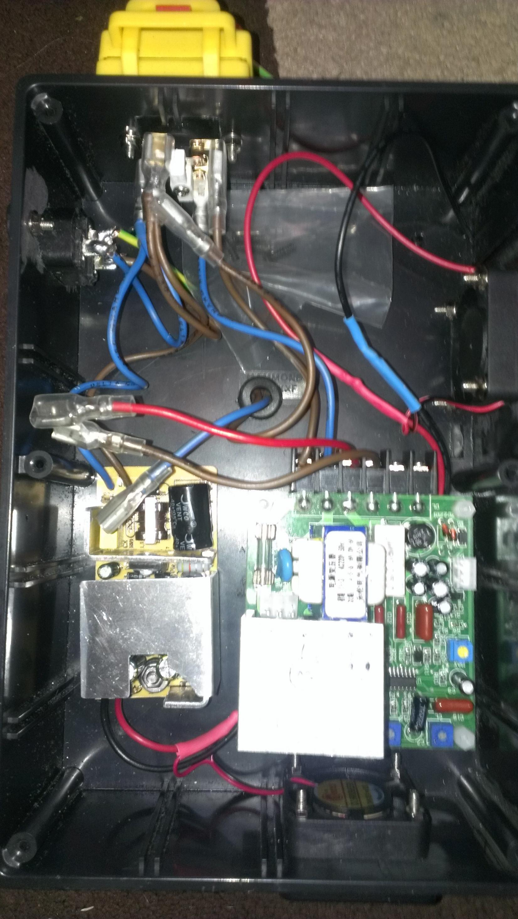

    Time to redesign! I bought a second set of parts :- control box , Thump switch (emergency lock out ) Toggle switches, Tacho panel, Fans , 240Vac to 12VDC wall wart and chinese speed controller.
    The first thing was to strip the P.C. board from the wall wart (power for the tacho & fans ) & did the same to the new chinese speed controller. the idea being that the control pot & on/off switch with their Bezel/face plate can be mounted remotely from the PCB allowing greater flexibility to the layout within the box.
    The Saga that is my Conquest mini-lathe re-furb.-y-geo-2nd-interior-conbox.jpg,
    The LH lower cct board is the "wall wart" innards and the RH cct board is the Chinese speed controller
    The speed controler board has a huge heat sink on it and since it now sat in a far larger but fully sealed case, I added two 40mm fans one mounted directly under the heat sink (when the box is mounted vertically on the lathe ) in the base of the box sucking cool air in, the second fan is almost on the top of the right hand side blows the warm air out.
    Having done all that I am now far happier with the layout. (PHOTO'S to Follow ):-

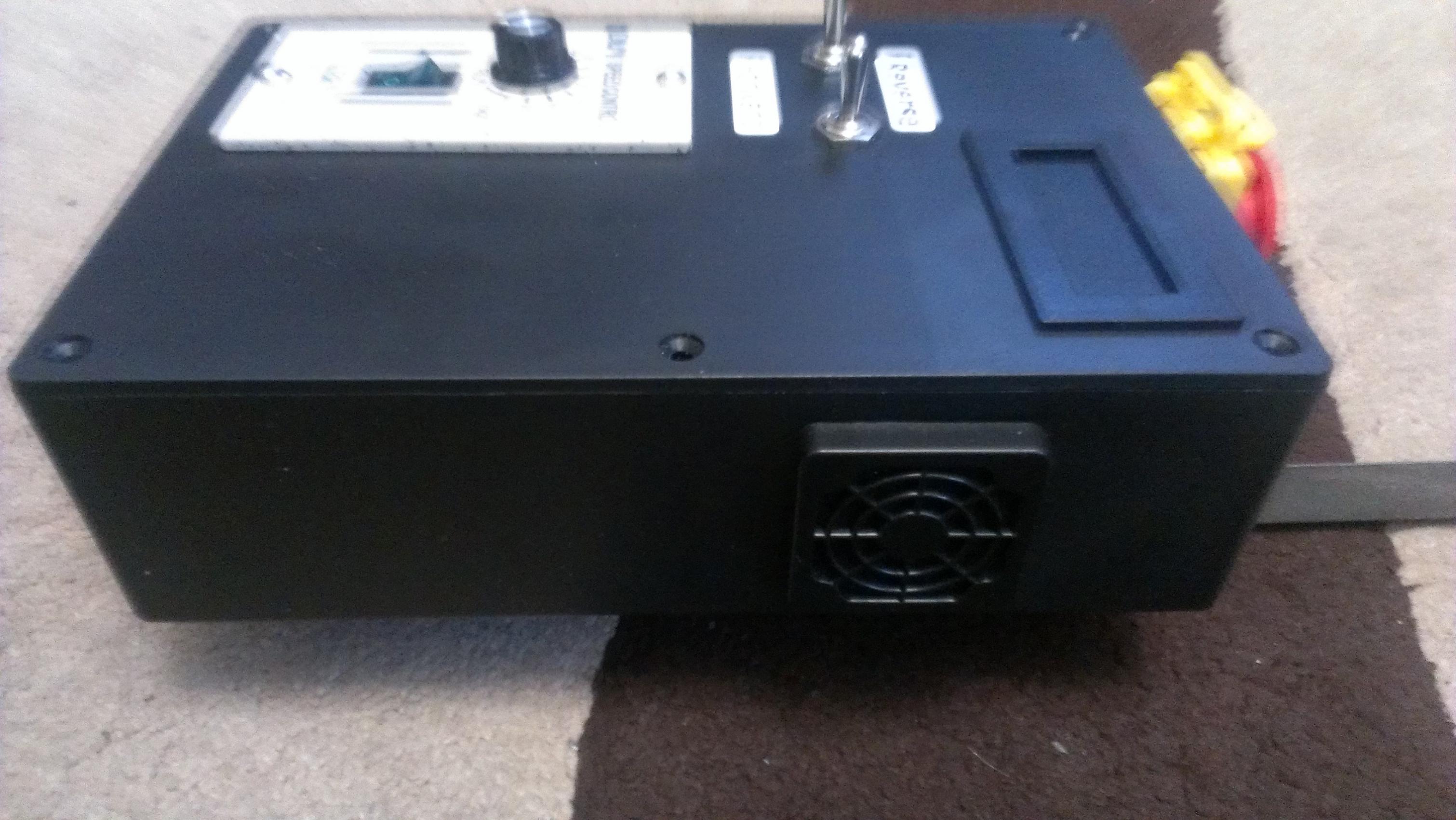

    The Saga that is my Conquest mini-lathe re-furb.-y-geo-2nd-exhaust-fan-conbox.jpg,
    RH side exhaust fan

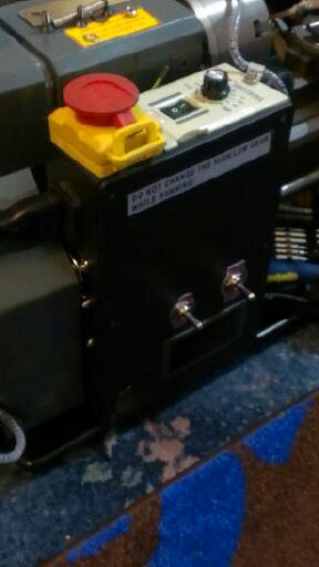

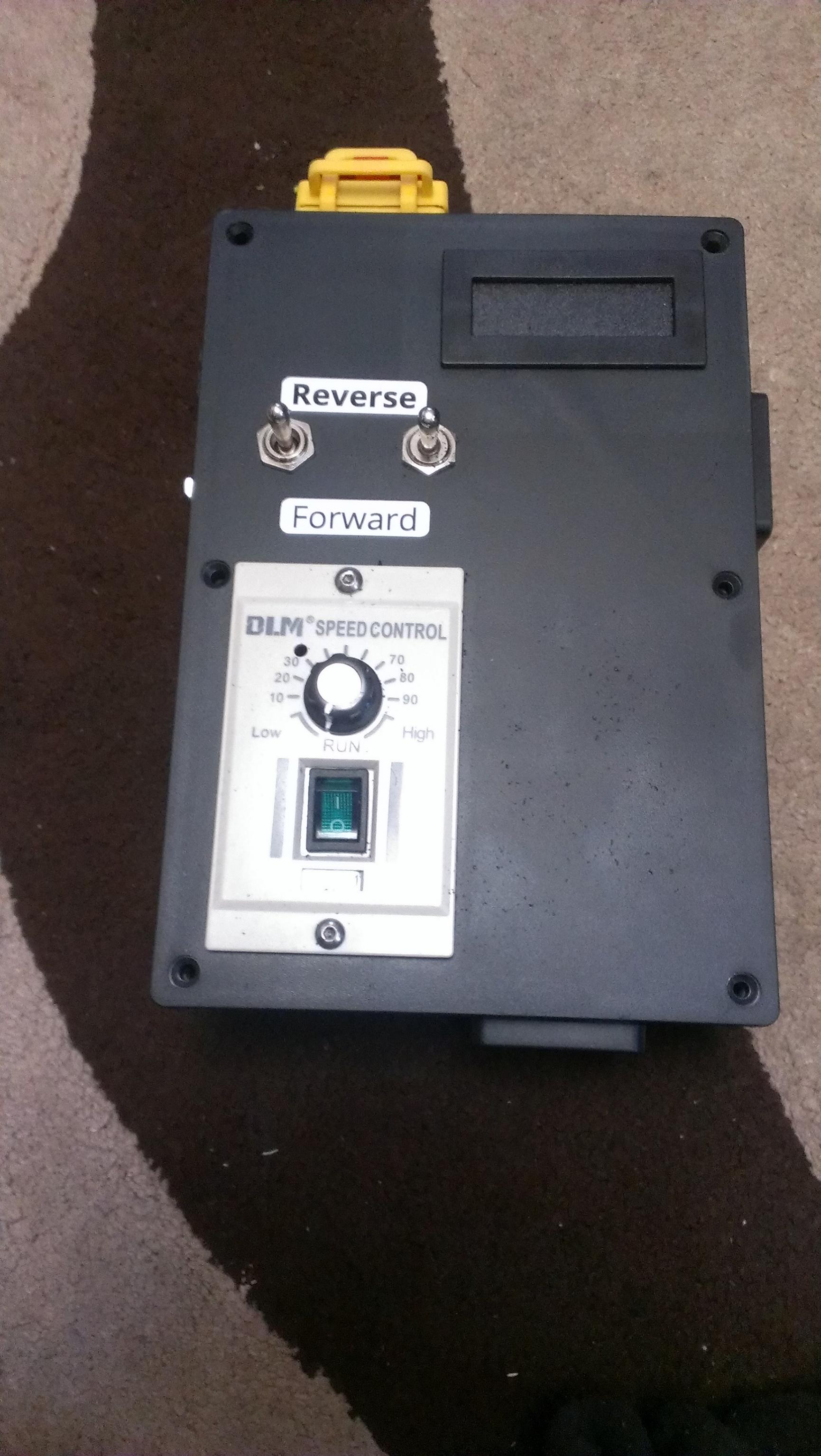

    The Saga that is my Conquest mini-lathe re-furb.-y-geo-2nd-facia-conbox.jpg,
    Front facia layout (also shows the lower inlet fan filter in place )

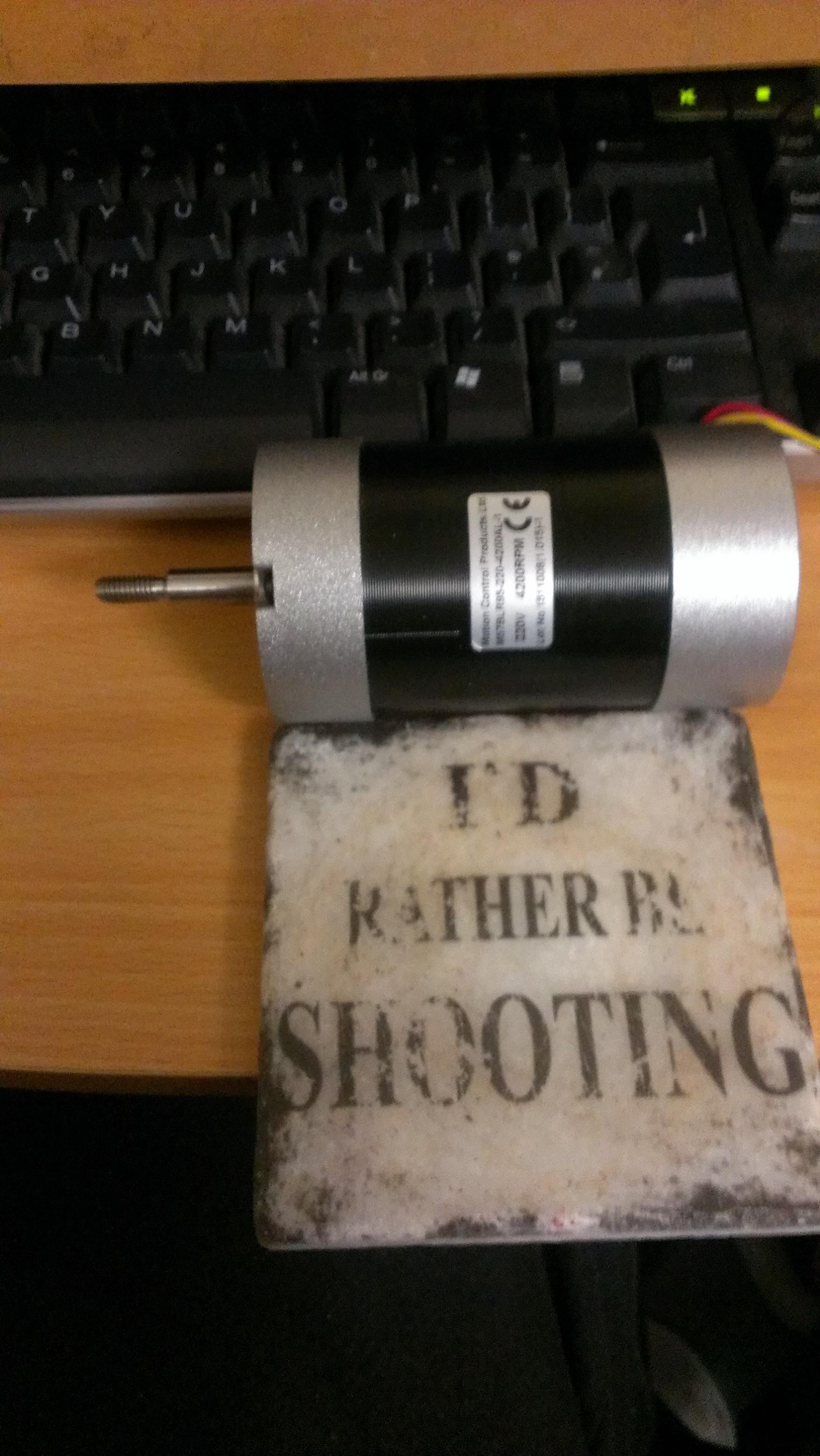

    QUESTION:- I have inherited a 3 PHASE 240v DC MOTOR need a control circuit for it ? loads of guff on 3 PHASE AC motors none on DC pointers PLEASE ........................TIA
    If it is a DC motor, and the name plate indicates this as well 3 phase, this would be an electronically commutated motor. This requires a special controller.
    Do a google search for "3 phase dc motor controller schematic diagram". As well "BLDC" = 'brush less DC'.
    Finding a 240V controller may be difficult. My quick search found many on eBay but all were low voltage i.e.<50V.

    Thanks, been doing a lot of that BUT it seems AC 3 phase is very well covered but DC 3 phase is non-existent except as you say for sub 50 volts.
    Although I gather that treadmills run at 80 V but again i can find no new cct for those only cannibalize ones and most of the electronic /technical info is at best "patchy" and not really enough to start a controller from scratch.
    I may have to buy a "toy" controller with the biggest ratings available and reverse engineer it with higher voltage/wattage (if those exist ) semi-conductors etc
    The motor in question is :-MOTION CONTROL PRODUCTS LTD.
    PART NUMBER:- M57BLR95-220-4200AL-1
    220V 4200RPM
    The company were VERY unhelpful except to tell me the motor was now obsolete and refused to furnish any tech spec/use/ control info except that it is 3 phase (and that was after I said i was puzzled by the fact that it had 3 wires instead of two for the usual DC motor. Which left me a bit puzzled as 3 phase AC usually has 4 wires if my creaking brain is remembering right.

    Y-Geo,
    the motor is a 57mm 3 phase Brushless Motor,If there are only three lines, he is not a Hall element version.the
    the M57BLR95-220-4200AL-1 Is the old number,According to the new naming rules, it is 57BS95R-##-2242-T-S,the##is watt
    sorry I did not find the data for this model, I think it is custom product for mini lathe,
    If his label is correct, you can use the No Hall 310v300-500w Universal Brushless Motor Controller, but there is a high risk. At the same time the cost will increase。your chinese speed controller is a Brush motor controller ,can not be used with this motor!
    My advice is to temporarily give up this motor, with a conventional DC motor.
