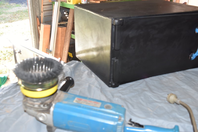

    Having removed the box for repainting due to surface rust lifting primer & finish coat, it seemed a good time to share with HMT friends/family.

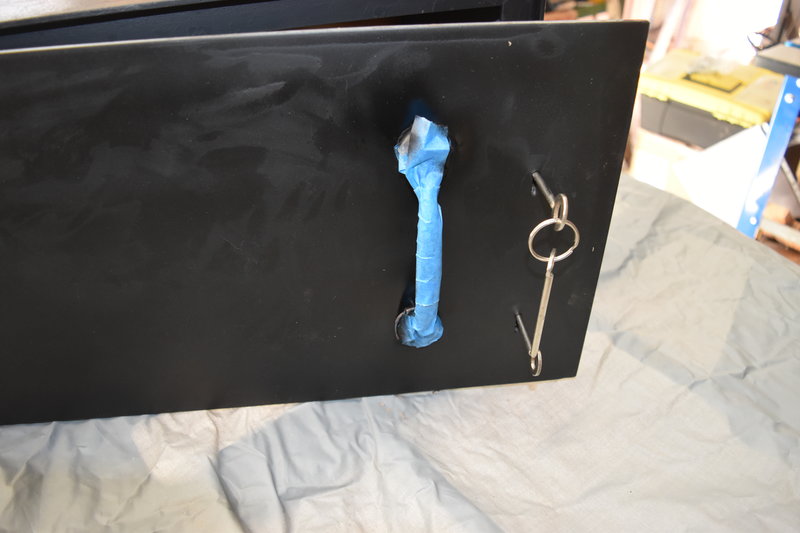

    SAFE FOR VALUABLE BITS OF KIT-rsz_dsc_1943.jpg The "SAFE" was made primarily from 3/16" plate I was using for repairing sand blasted mower decks.

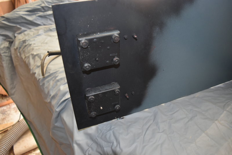

    SAFE FOR VALUABLE BITS OF KIT-rsz_dsc_1948.jpg SAFE FOR VALUABLE BITS OF KIT-rsz_dsc_1946.jpg Two solid locks from a demolition were used after a locksmith made keys to fit. I used 2 locks after working as a Head Cashier for a grocery store: they had one key & the security company had the other.

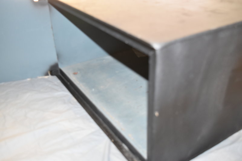

    I used MS angle for the striking plate & for door stability & strength this angle was continued all the way around the inside of the box.

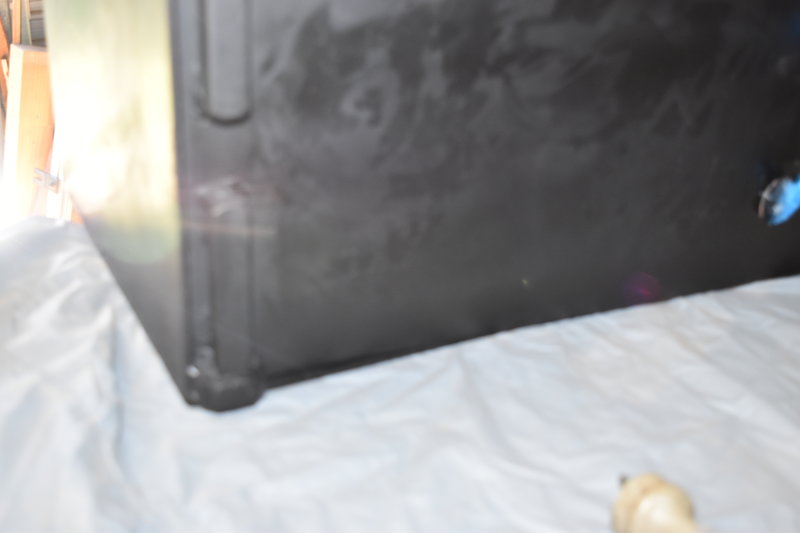

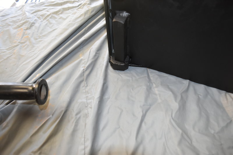

    The simplist hinge I came up with was a hardened bar I bought from an engineering shop. Holes were drilled into some solid scrap bar I had to complete the hinge and welded to hinder any cutting attempts. I originally intended to dyna bolt to the concrete floor (too late to inset in the shed floor) so the 8mm holes were never employed as I decided to camoflage it in a bench and clutter the front with cartons of screws etc.
