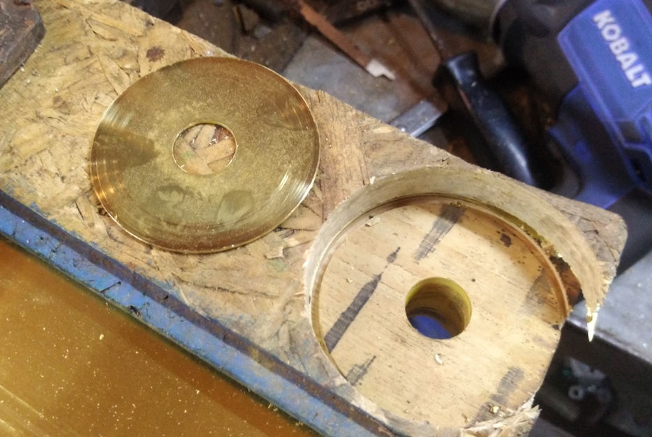

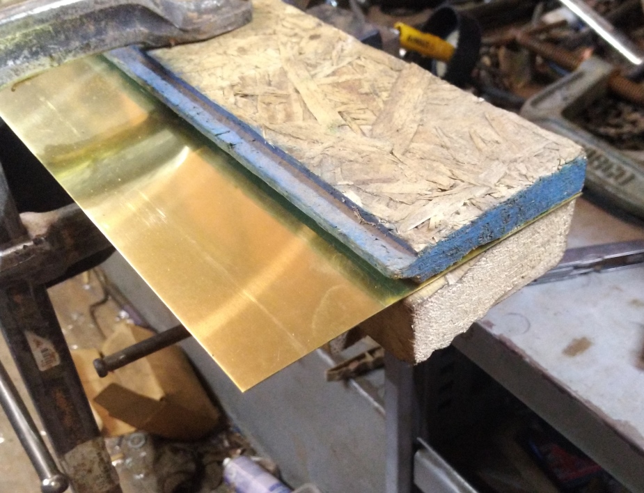

    I find the best way for me to cut holes in thin materials is to clamp them between 2 pieces of wood as a sacrificial drilling fixture
    Sacrificial drilling fixture out of OSB and a 2by4-img_20220413_200403df.jpg
    In this case I need to drill 2 sized holes in the brass shim stock

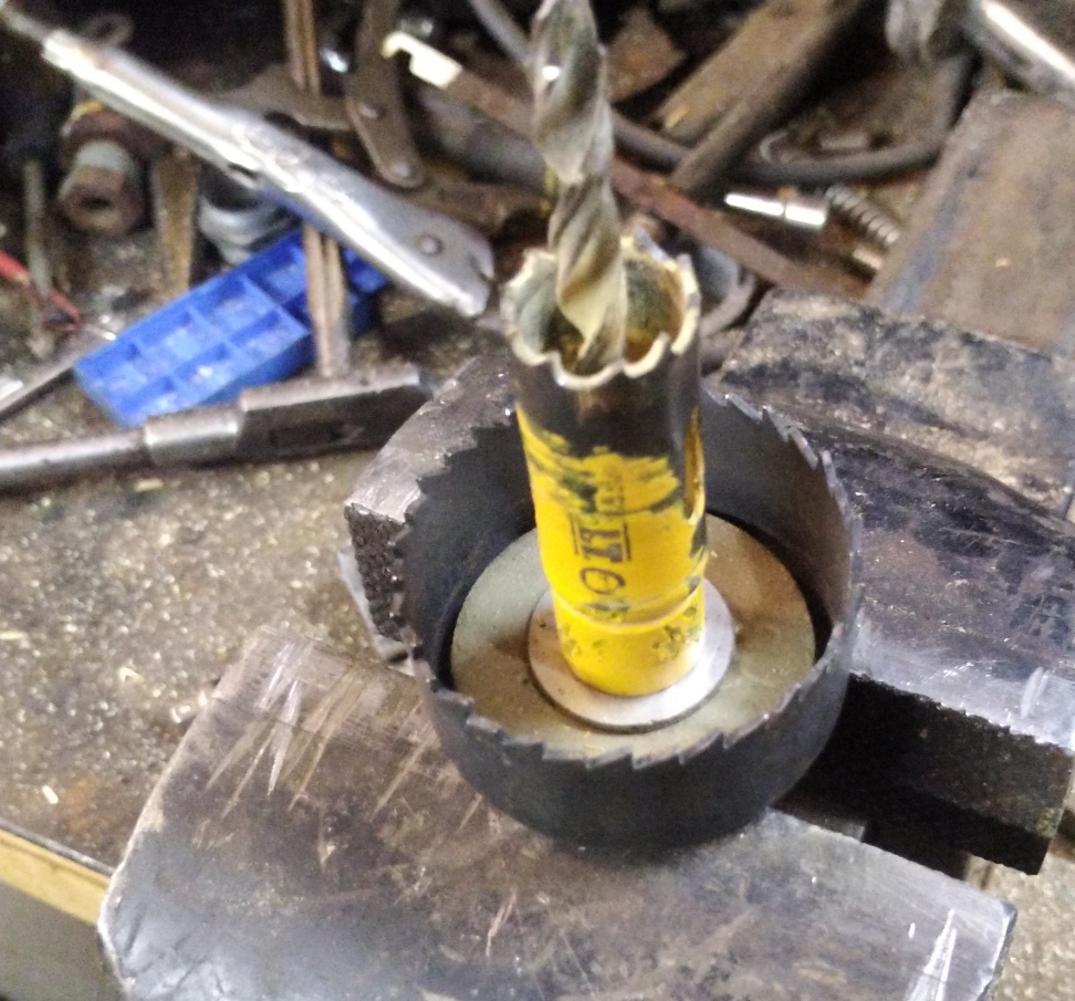

    First the small hole
    Sacrificial drilling fixture out of OSB and a 2by4-img_20220413_201407df.jpg
    then the large hole and drill through the stock to create the part
    Sacrificial drilling fixture out of OSB and a 2by4-img_20220413_201521df.jpg

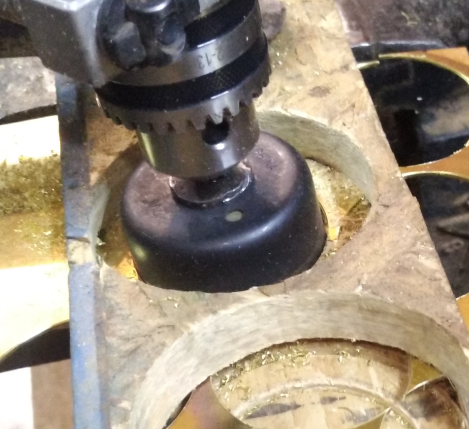

    Since I needed multiples of what I was making in 2 sizes after making the large diameter shims
    I changed the 3 1/2" hole saw out for a 2 1/8" so I could make 2" shims
    Sacrificial drilling fixture out of OSB and a 2by4-img_20220413_203532hs2.jpg
    Sacrificial drilling fixture out of OSB and a 2by4-img_20220413_203821hs2.jpg

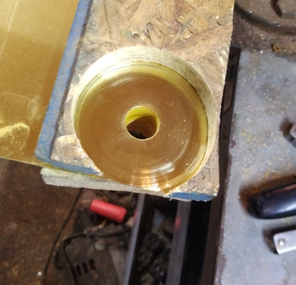

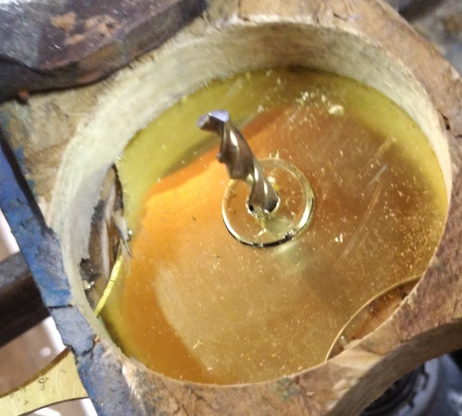

    Now drilling up from the bottom the 2/4 becomes the guide for the 3/4" hole saw
    Sacrificial drilling fixture out of OSB and a 2by4-img_20220413_205016df2.jpg

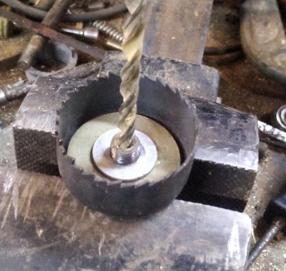

    I then finish off by using the 3/4" hole in the shim and the 2x4 as the guide for the 2 1/8" hole saw
    Sacrificial drilling fixture out of OSB and a 2by4-img_20220413_211331df2.jpg

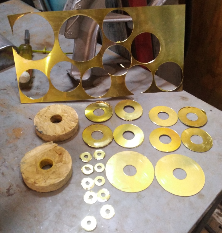

    Large & small brass shims plus a bunch of 1/4" brass washers as an added benefit, with a couple of OSB disks thrown in for good measure
