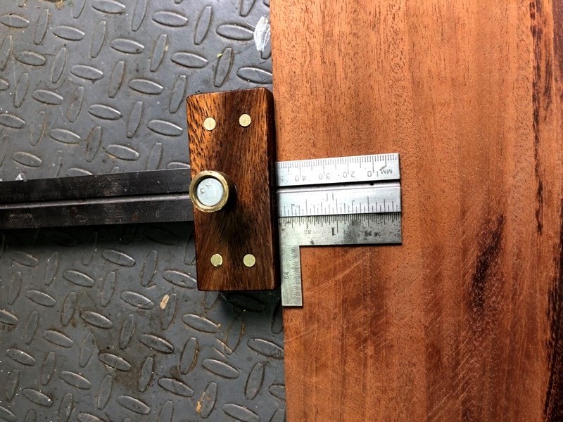

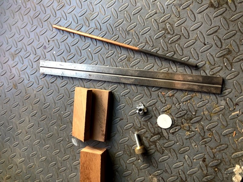

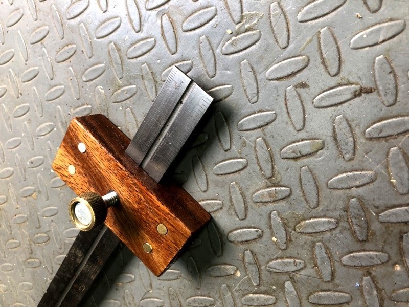

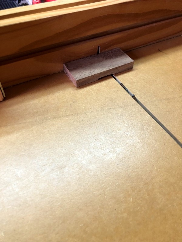

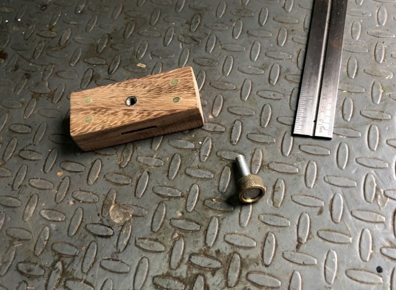

    These tools are very useful in woodworking. With a quick search (Ruler stop), you will easily find many trade items (Veritas, Woodpeckers, Czeck Edge, etc.), many DIY versions, and some 3D print models. Here I present my version without great details about the construction.
    I used parota wood, a ruler, a 7/32” brass rod, a 1/4 x 20 bolt and a T-nut. The finish is with linseed oil and beeswax.
