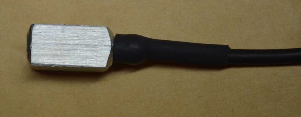

    Ruggedised temperature sensors-board_10.jpg Ruggedised temperature sensors-board_11.jpg

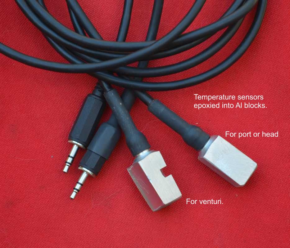

    Here are examples of the finished sensors.

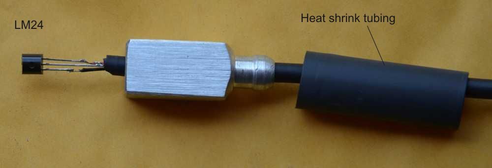

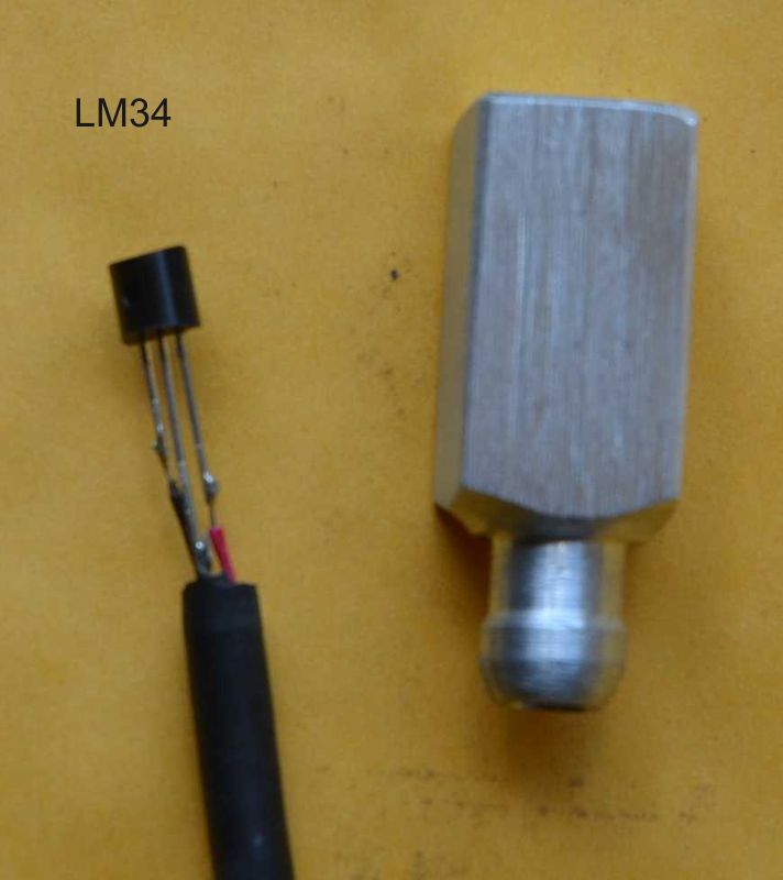

    The base sensors are of the semi-conductor variety and in many applications they are too delicate without some form of protection. To that end I make an aluminium housing to suit the application and pot the sensor using epoxy. I use either an LM34 (deg.F) or an LM35 (deg. C) chip which are simple 3 wire analog devices. There is an earth or common wire, a power supply wire and the 3rd is the DC signal output.
    Ruggedised temperature sensors-temperature_01.jpg Ruggedised temperature sensors-temperature_02.jpg
    The sensor shown with my housing prior to potting in epoxy.

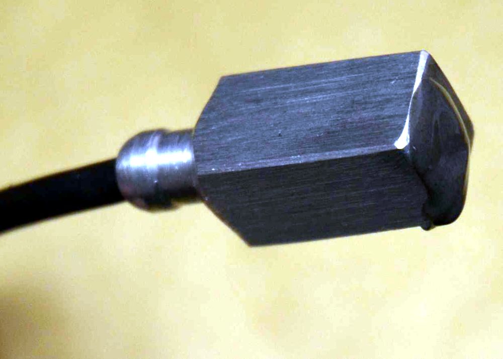

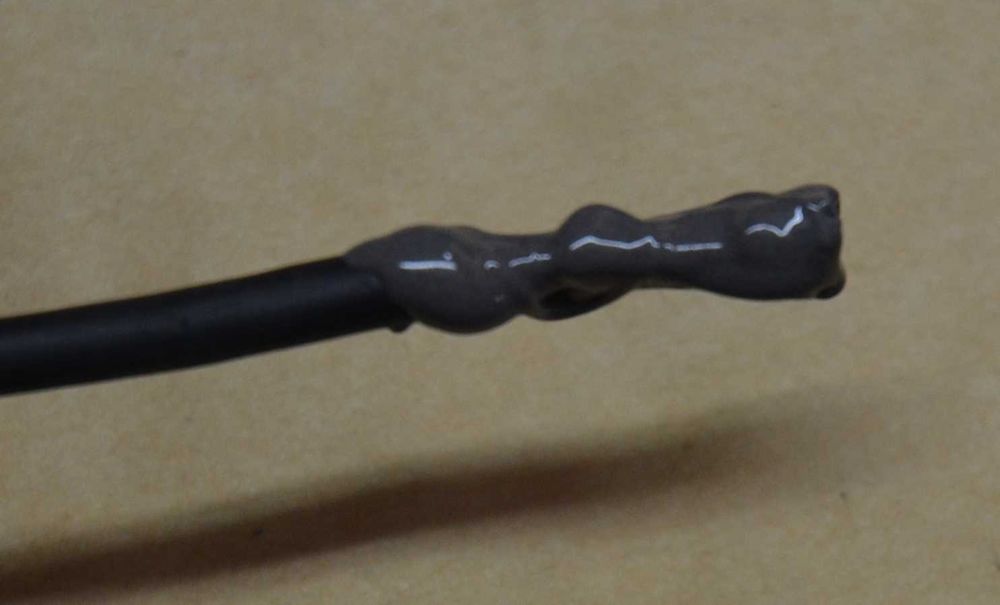

    Ruggedised temperature sensors-temperature_04.jpg Ruggedised temperature sensors-temperature_05.jpg
    On the left the sensor and soldered cable encased in wet epoxy, next we see the sensor potted in the housing.
    Some heat shrink tubing over the cable entrance is used to seal it and provide support for the cable. This finishes the assembly and makes it suitable for harsh environments.

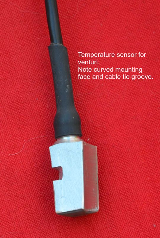

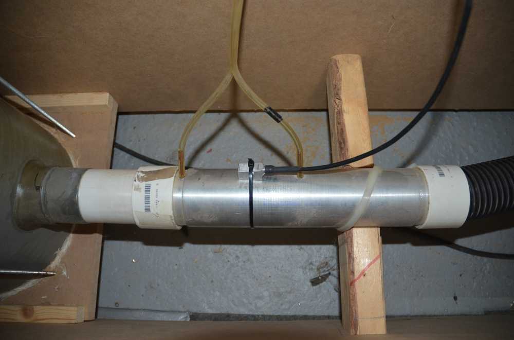

    Here is an example showing a sensor fitted to a venturi used for flow measurement.
    I'll go into more detail of how I deal with the output signals when I make the post on the flow bench.
