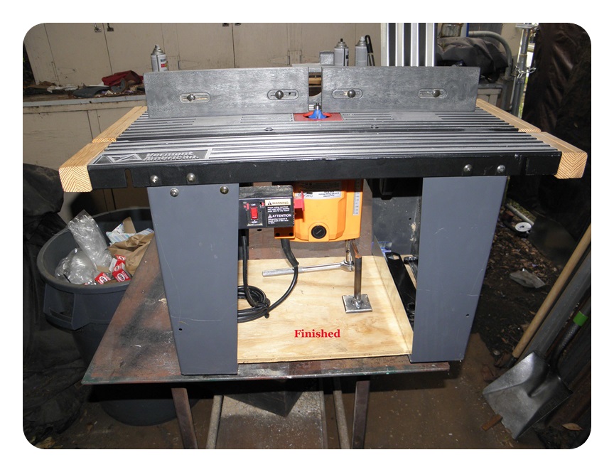

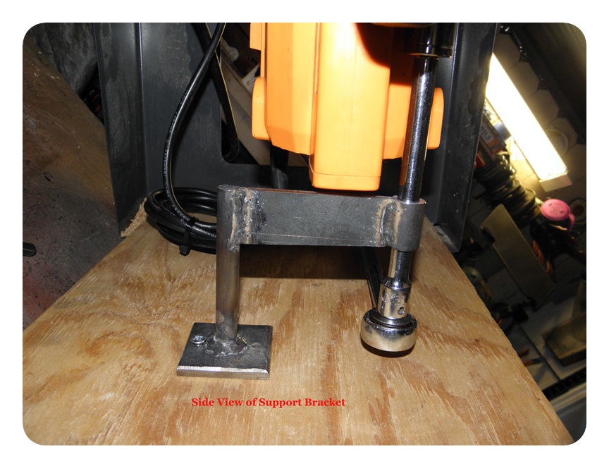

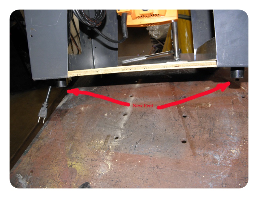

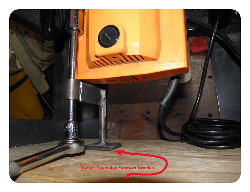

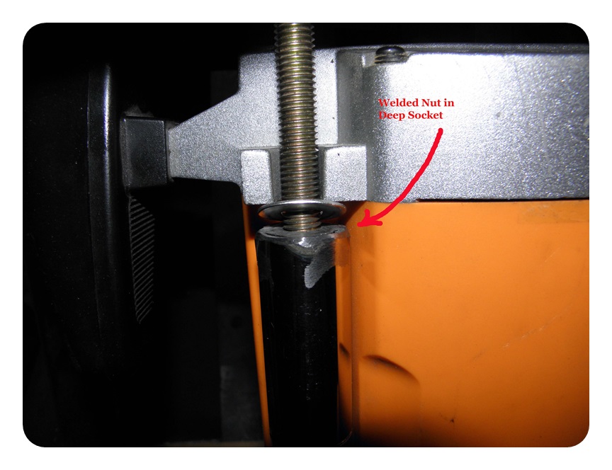

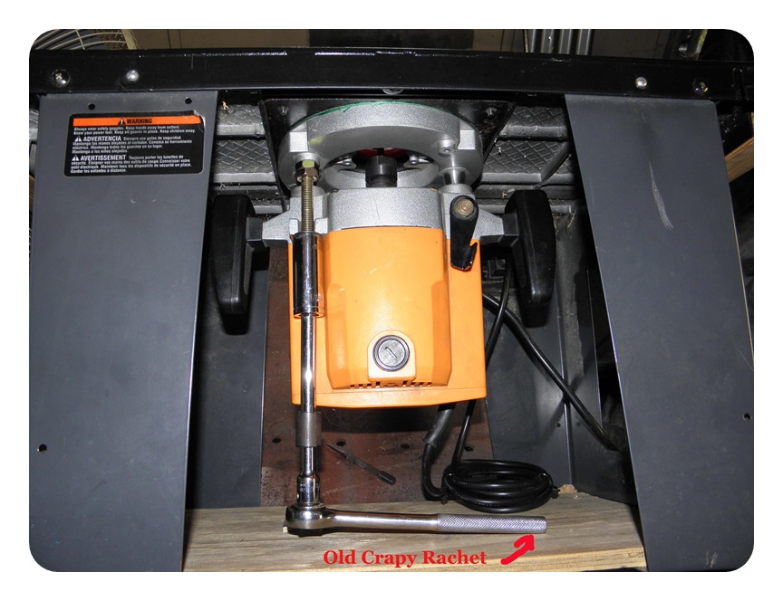

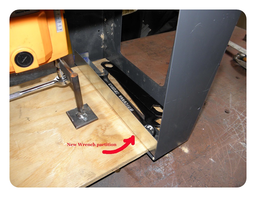

    The other day I was routing some boards for my tool boxes and it took me 15 minutes to get the Vertical depth of the router bit adjusted just right, up and down it went never ending up where I wanted it to be hence this Router Mod. This Mod took 2 1/2 hours to make.
    Router Table Quick Height Adjuster Modification. Made from 1/4 " steel plate, 3/4 " Round stock, Ratchet, extension, Deep Socket and large Nut.

    Hi Captain !
    I like this one, I have exactly the same router, but mine is blue and branded by Ryobi. (750 W)
    I also use it under the table, and I like your simple lift. I have personally a lift made by a simple screw that pushed upward, applying the tip on the plastic carter, but I think your system is better.
    One day or the other, I will do something like this.
    Thanks ! (and thanks for the documentation, very clear)
    Christophe
