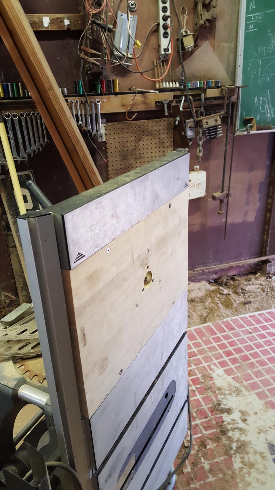

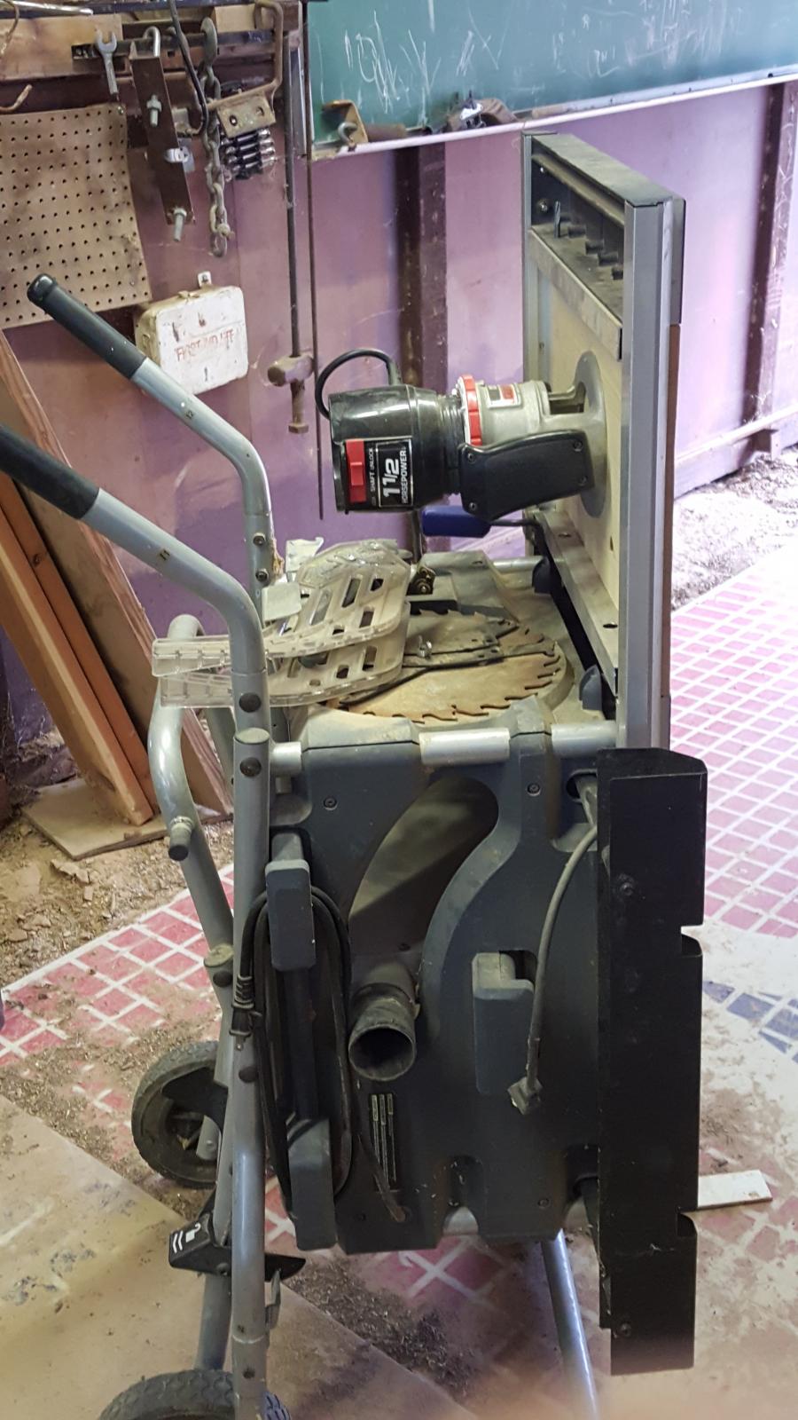

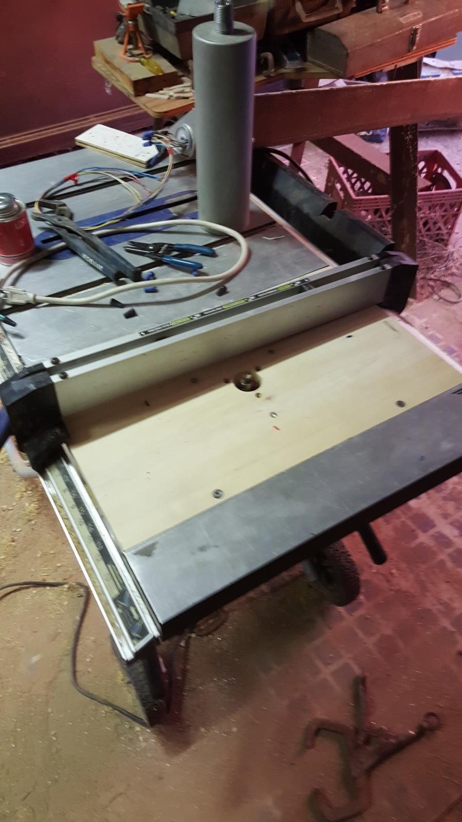

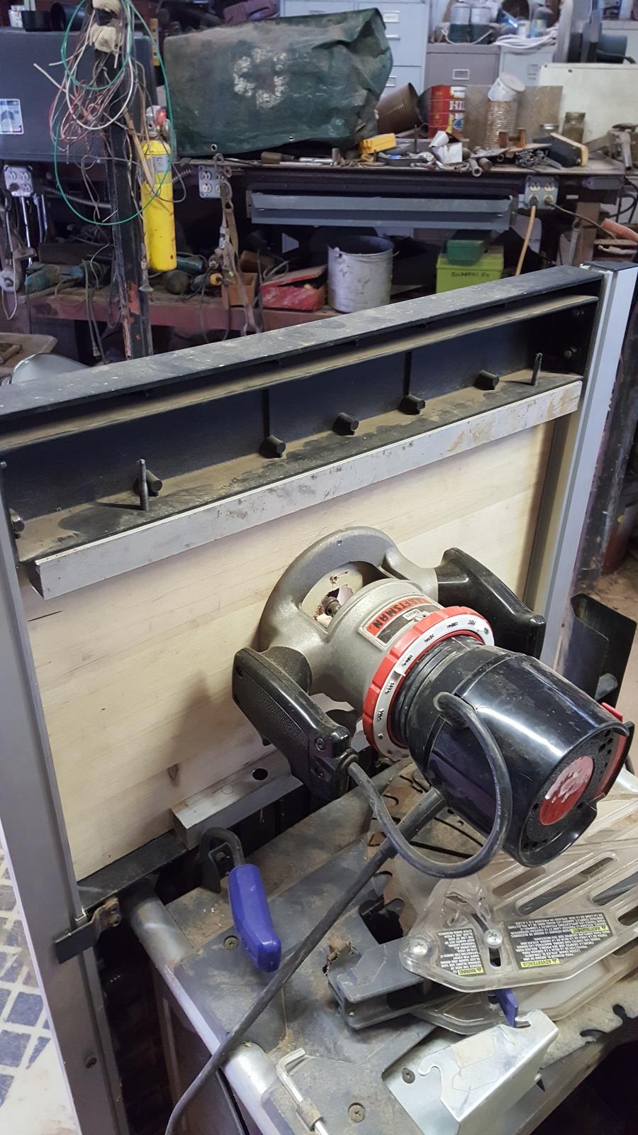

    Router stand from cheap table saw
    This works out very well as the table saw has a fence that works with the router too. The router doesn`t have to be removed to use the table saw in most cases but is easily removed by taking out the four countersunk screws that mount the router table to the aluminum square tube that is attached to the table. The saw folds up easily to adjust the router depth and for storage.
