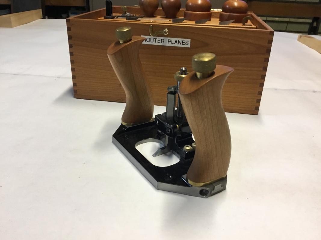

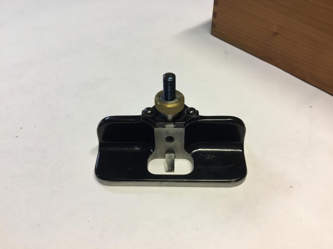

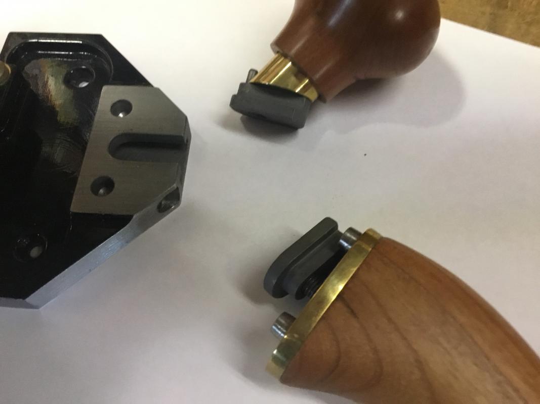

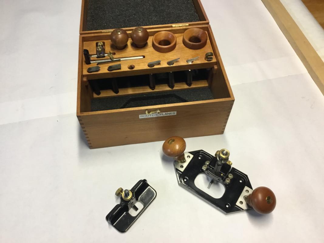

    Router plane-cda0f5ef-7762-4857-9293-1379dee1f520.jpgI decided to make a router plane or two. Router plane-751e304a-3b18-4530-99e8-e4ce02b65d9b.jpgand this is what I ended up with. I use the small one often on hinges and the like and even made the cutter but I could not decide on a handle configuration for the large one. So to eliminate my indecision I made two different “ball styles and another tote style. The larger one has purchased cutters because I was getting lazy.Router plane-eb32aa46-e609-44a1-9c09-c6475e2bbee5.jpgClick image for larger version.
ID:	26634Router plane-010004f8-e1e0-424b-8567-2834a7dee6f9.jpgPlease excuse the pic arrangement??

    Beautiful work Englewood! The shapes and grain of the handles are real eye candy! I'm curious also where you got the castings? And I'm assuming you made the beautiful box for them as well?
    Thanks very much for sharing this with us. Craftsmanship at it's best.

    Thank you very much. These are not castings the small one is a structural T and the large one is a hog out from .5 plate. And yes I made the box from scrapes from the handles��
