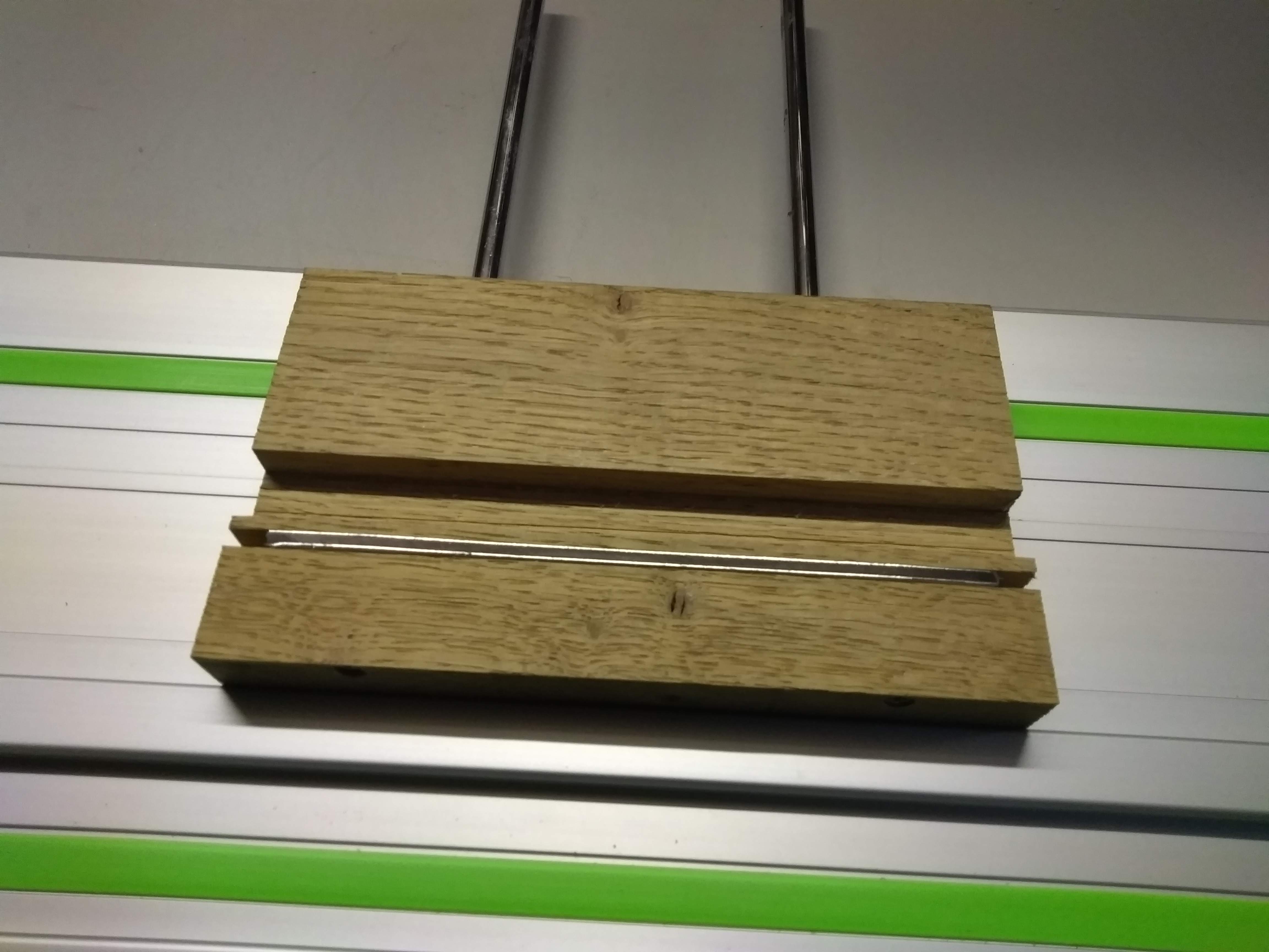

    Since I have been fiddling around a new mini router I decided I would have a go at a jig to allow use of the router on the tracksaw track. I know you can buy these but they seemed expensive for what they are and I wanted one with more adjustability than I had seen.
    I already had all the parts and it took me less than an hour to put together. I now just need to make some stops to slide in the t-slots on the track to complete the build.

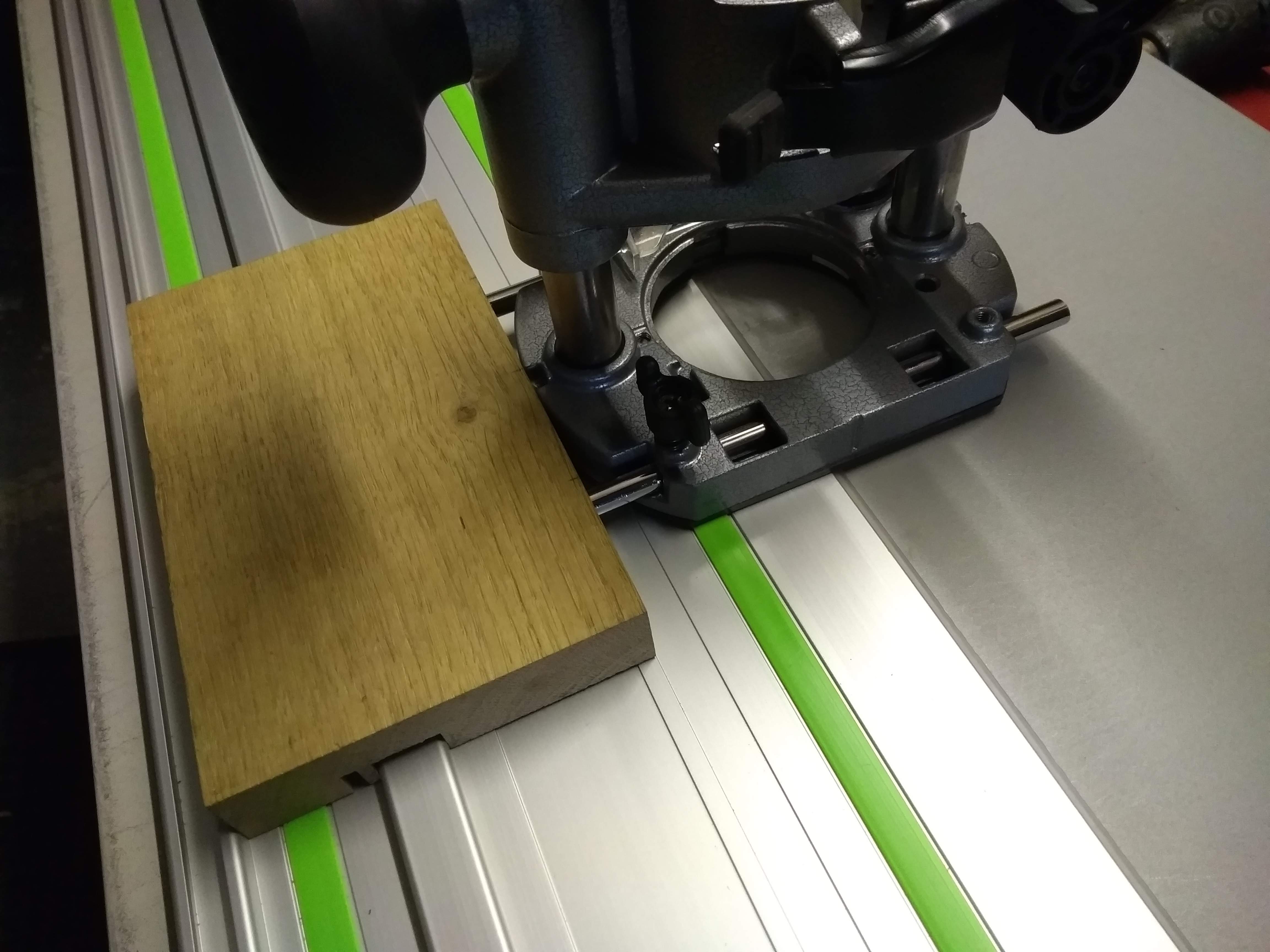

    The guide block is a piece of Oak. I cut the slot on the table saw and purposely made it just a touch over size (less than 0.5mm). I then cut another kerf to the side of the slot and made what is essentially a gib strip. Two screws allow me to adjust the width of slot so I can get either a nice snug fit for doing something like shelf pin holes, or an easy sliding fit for doing long slots or edge trimming. It also allows me to take up any wear in the slot or seasonal movement.
    The guide has two 8mm rods that fit into the plunge router base, they are simply a press fit, no glue in case I want to change them for shorter or longer rods in the future. The plunge base will have a shim piece added to keep it level. I can adjust the base in an out from the track edge either for doing parallel cuts or to make use of the splinter strip.
    As I say it took me less than an hour of work and would have been less if I wasn't making it up as I went along. The guide block was made from a larger piece which was then cut down so I can either make another guide block if I break this one or use it for another track based project.
    My next job, after I finish my tool post grinder, is to take a 1/4" drill bit and grind it down to 5mm at the tip so I can fit it into my router collet. Then I need to come up with a way to index the shelf pin holes.

    Thanks. I am really glad I went with the gib strip idea. A couple of days after making this I went to try it out for fit with the shim for the router base, the guide was too tight on the track and needed a bit of adjustment. So in just a few days the moisture content in the wood had changed enough to make a difference. Having made this in winter, I bet in summer it would be unusable without the adjustment feature.
