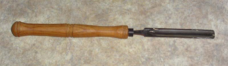

    I present here a roughing gouge homemade made ​​in an old metal file.

    Did you soften the file? There have been cases of tools made from (especially long ones like this) shattering into sharp shards. Given the forces that come into play with a roughing gouge, I'd want the metal to be quite different than in an unchanged file.

    That the steel is not too hard, I soaked in part. This file now has the same consistency as HSS4.
