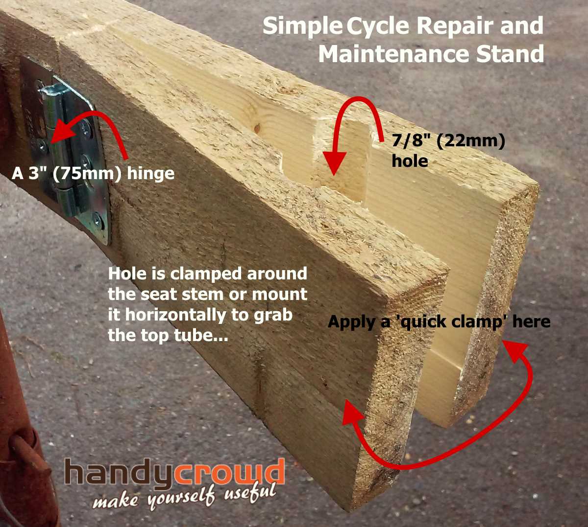

    This is what I came up with using a pallet bearer (2"x4") a hinge, a 22mm drill and a quick clamp (or three!)...

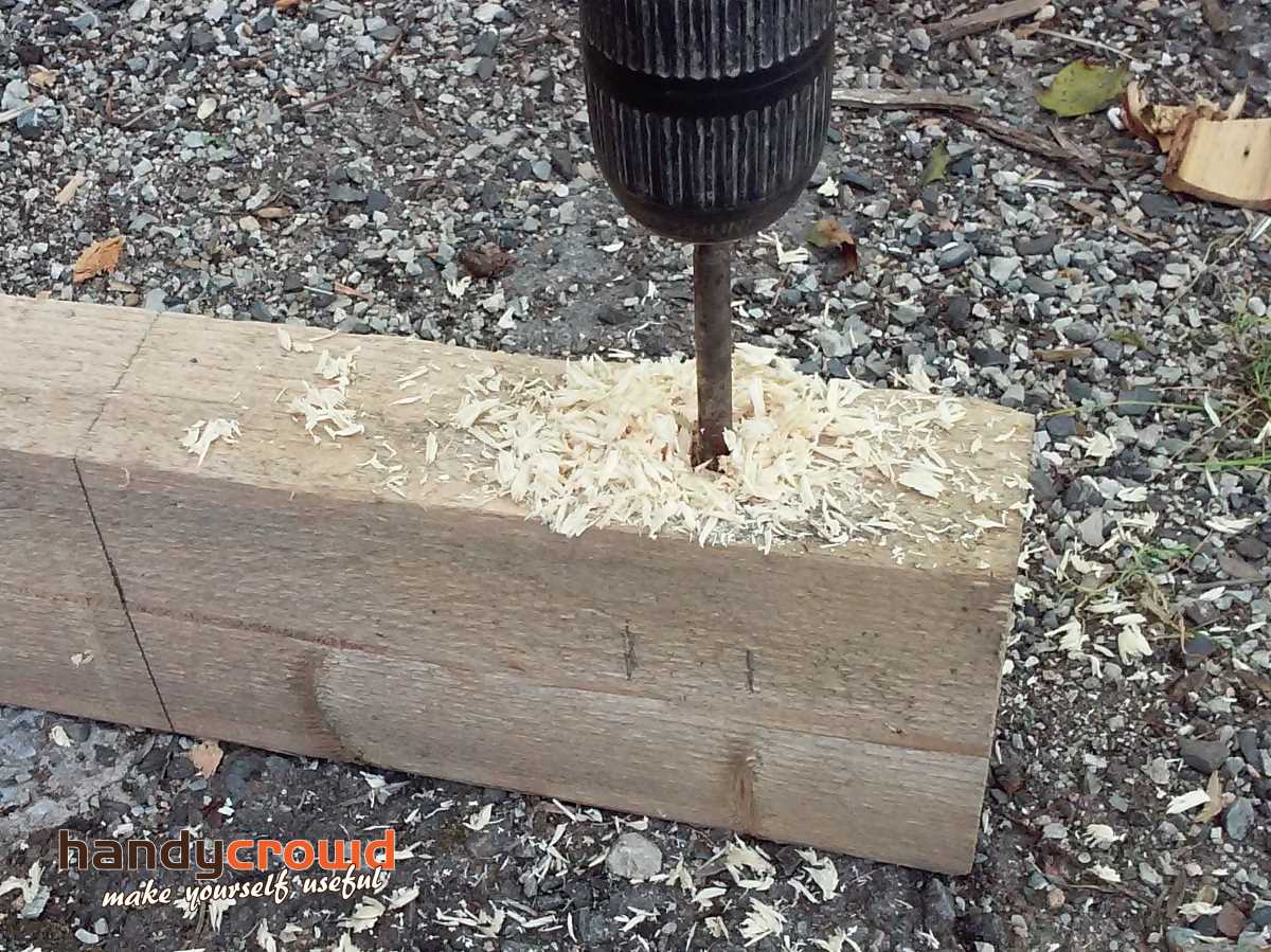

    Rough and Ready Bicycle Stand for Repairs and Maintenance.-drill-hole.jpg Drill a 22mm hole all the way through the long side.

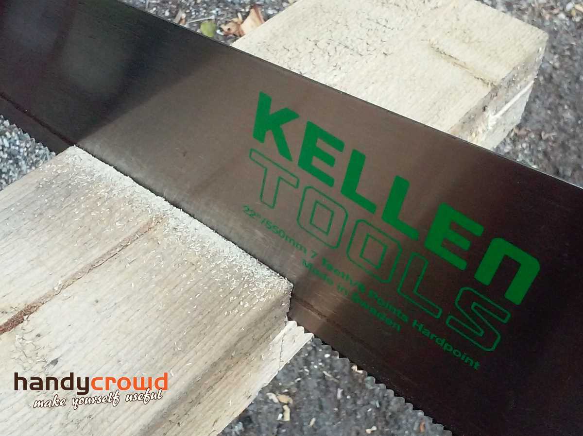

    Rough and Ready Bicycle Stand for Repairs and Maintenance.-saw-down-timber.jpg Saw down the middle about 8" or so, through the centre of your new hole.

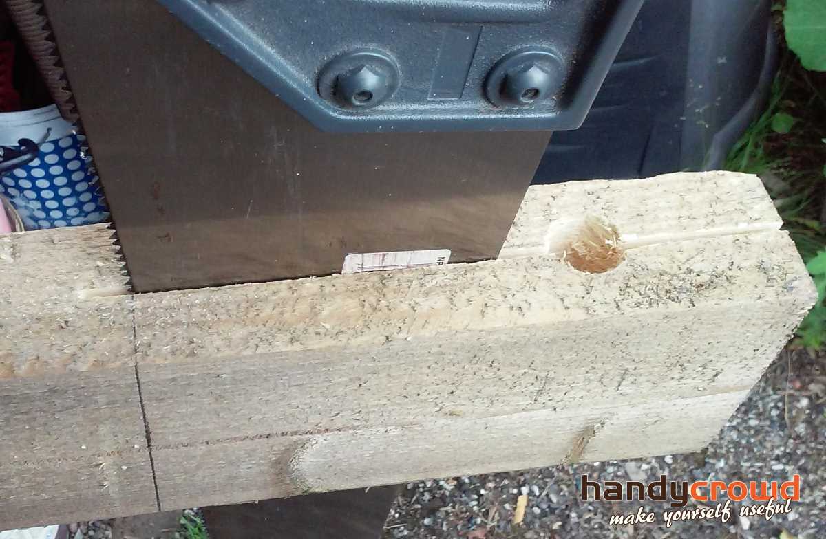

    Rough and Ready Bicycle Stand for Repairs and Maintenance.-crosscut.jpg Cross cut it off and screw a hinge over the cut, reattaching it.
    Rough and Ready Bicycle Stand for Repairs and Maintenance.-stand-details.jpg The details (if you can call them that!)

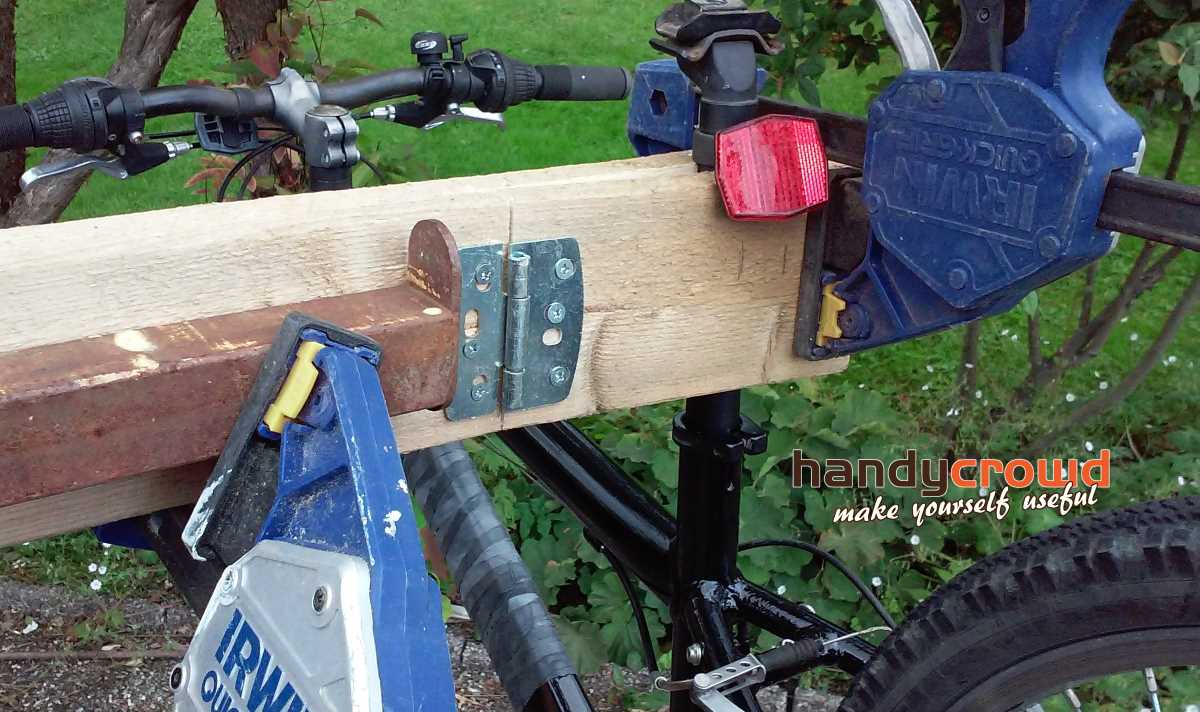

    Rough and Ready Bicycle Stand for Repairs and Maintenance.-stand-use.jpg Bike stand in action on my lads 'rat bike' project....
    I then clamped my new cycle stand to an old builders trestle I had, but you could just as easily use a longer length of 2"x4" and screw it to a tree or the side of the shed etc. I'm going to screw mine to the wall in the garage on a bracket/hinge so that it can be stowed out of the way for the 99% of the time I don't use it lol!
