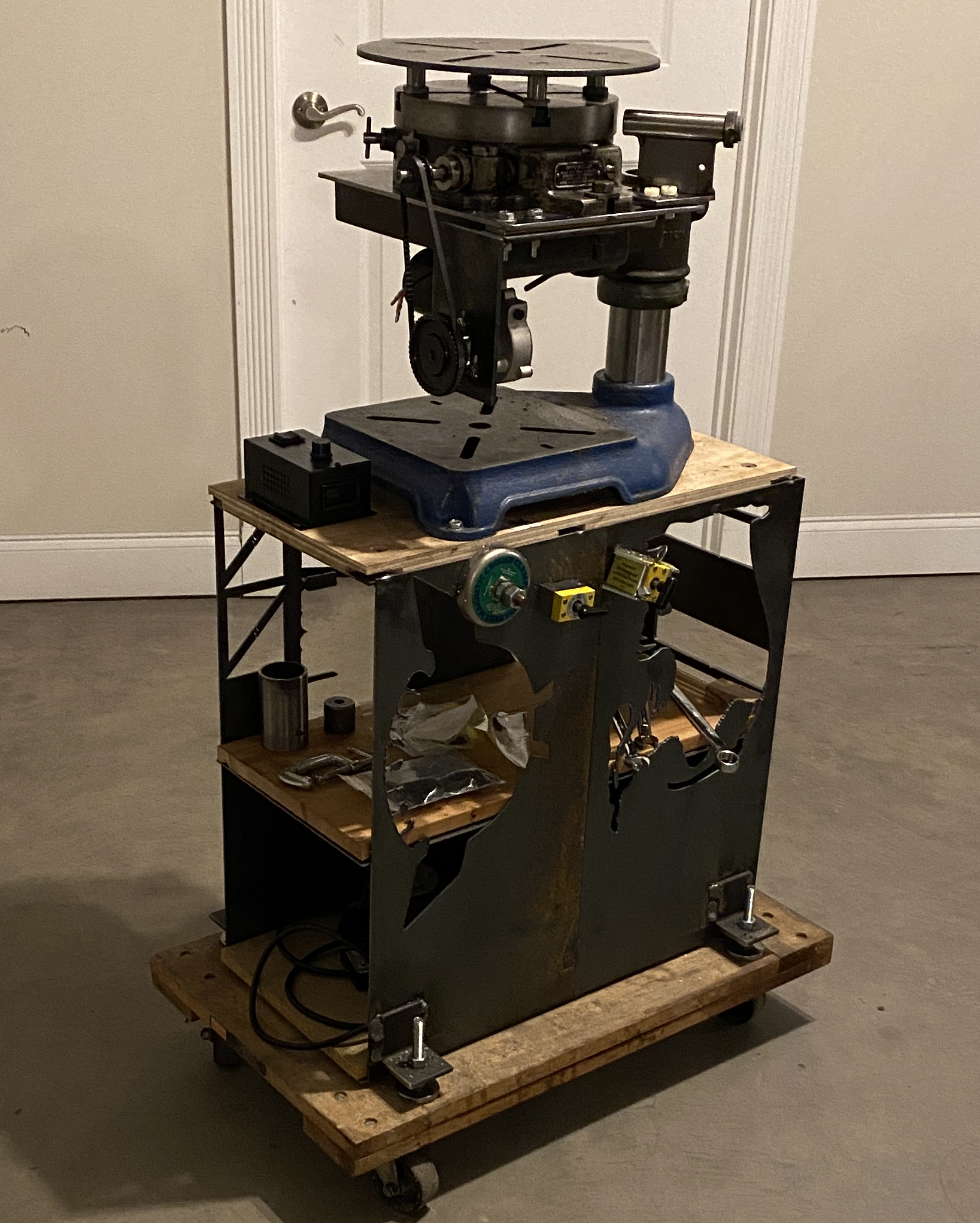

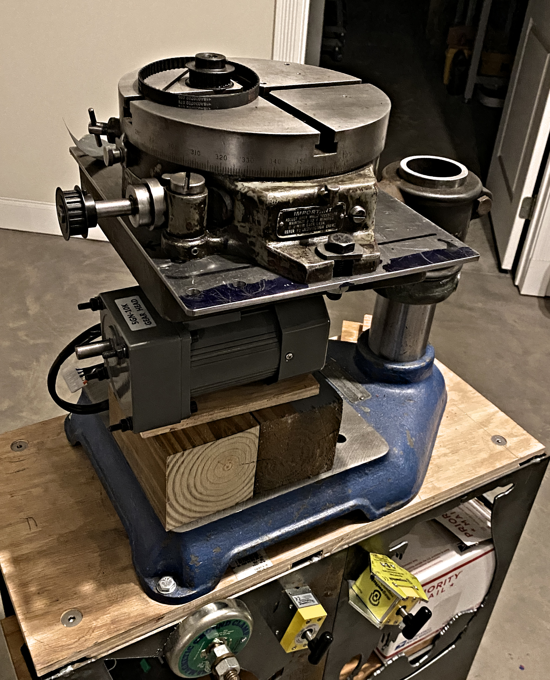

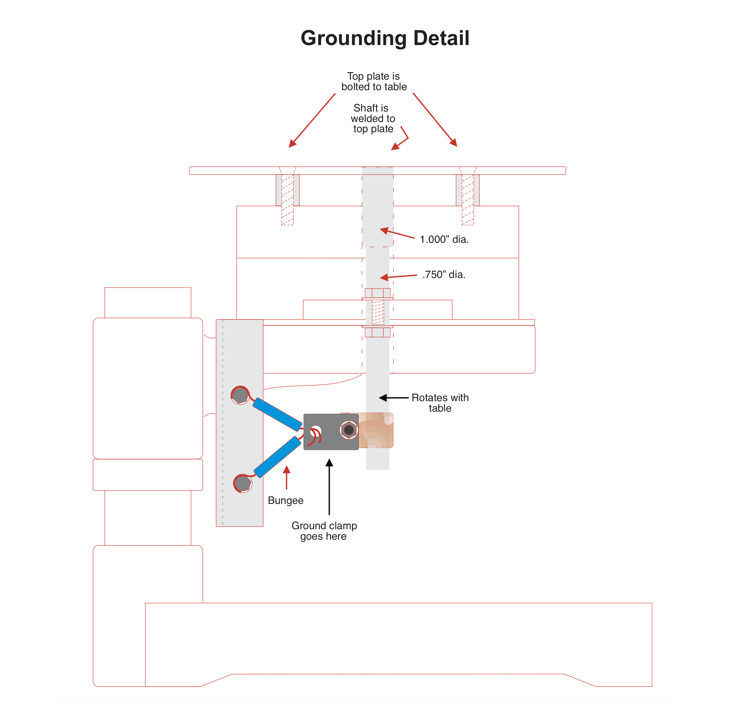

    Rotating Welding Positioner Project
    I decided to use an older Troyke 9" rotary table I had on hand as the basis for a welding positioner. I made an adaptor plate to mount it on a drill press rig with a 12" high column. This gives it the ability to tilt 90 degrees to either side, and swivel to either side as needed to distribute the weight.
    It will be driven by a variable speed gear motor through a timing belt and pulleys. If necessary, the speed range can be tweaked by changing the size of the timing pulleys.
    At present, I'm working on a mount that places the motor out of the way under the table. Waiting for some steel to arrive.

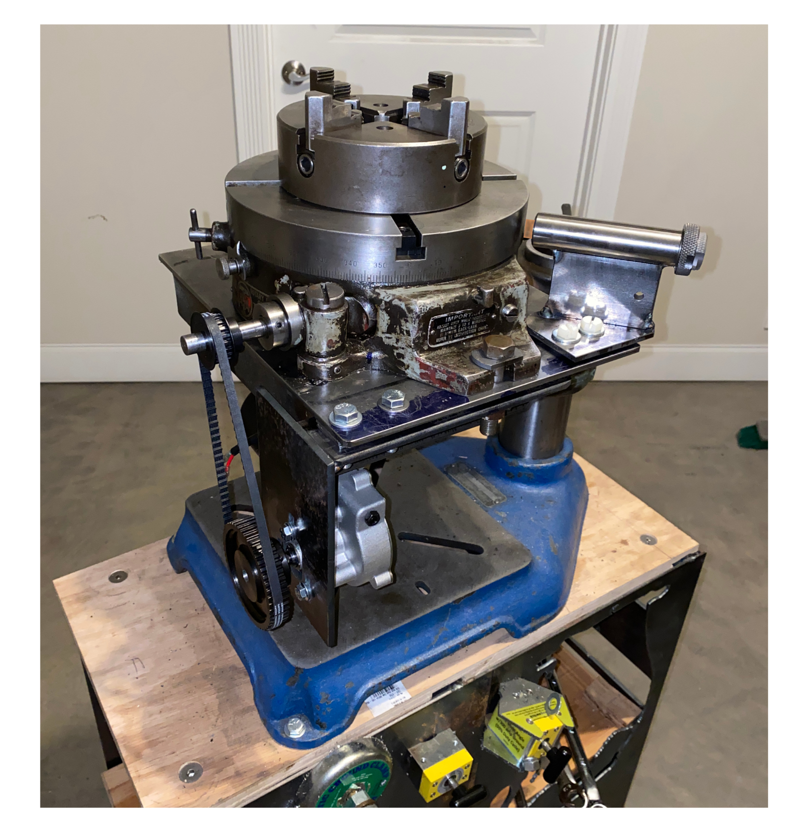

    All finished except for the grounding arrangement. Pic below shows how I plan to do that.
    Rotating Welding Positioner Project-positioner.jpg Rotating Welding Positioner Project-grounding-detail.jpg

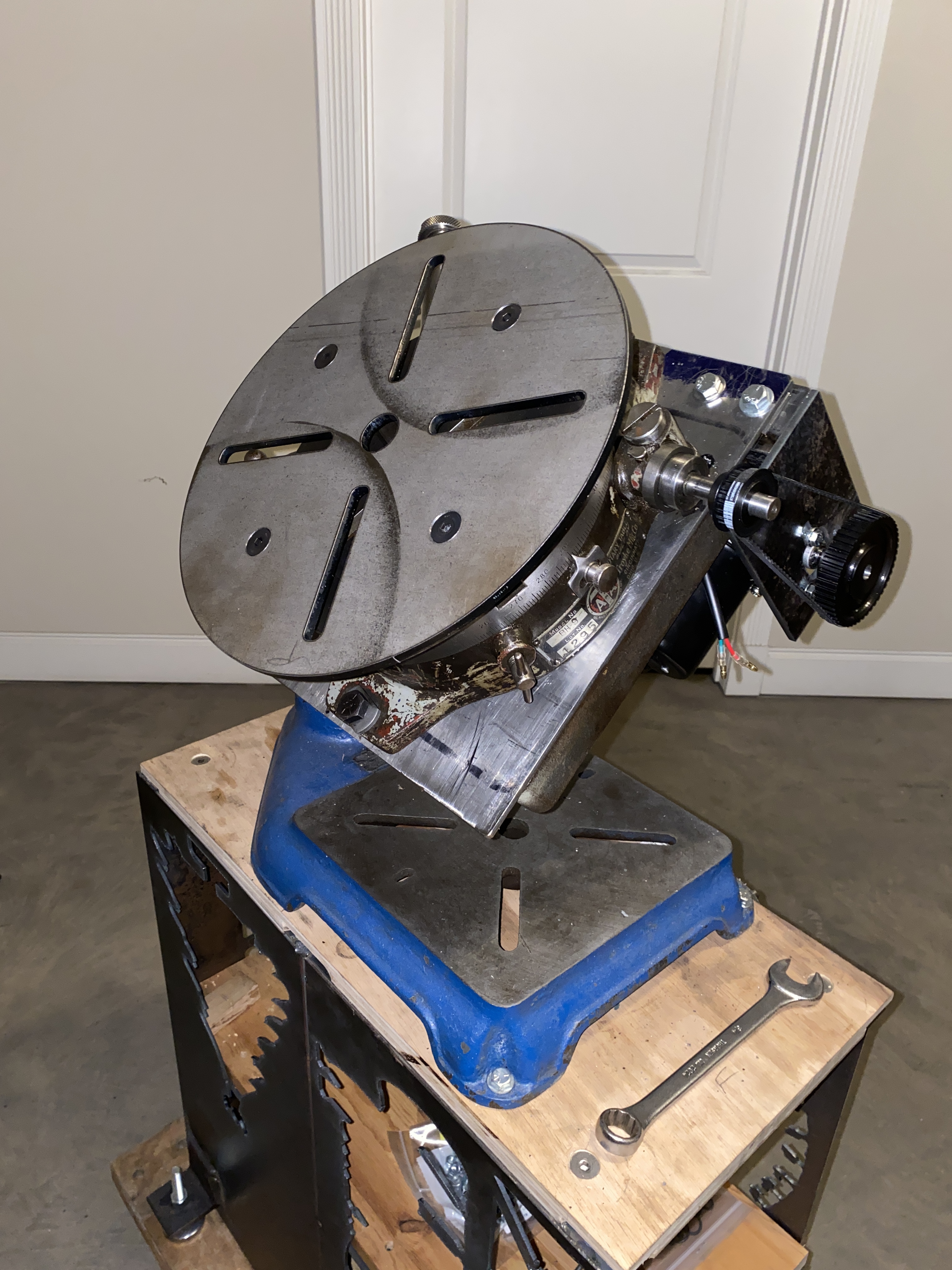

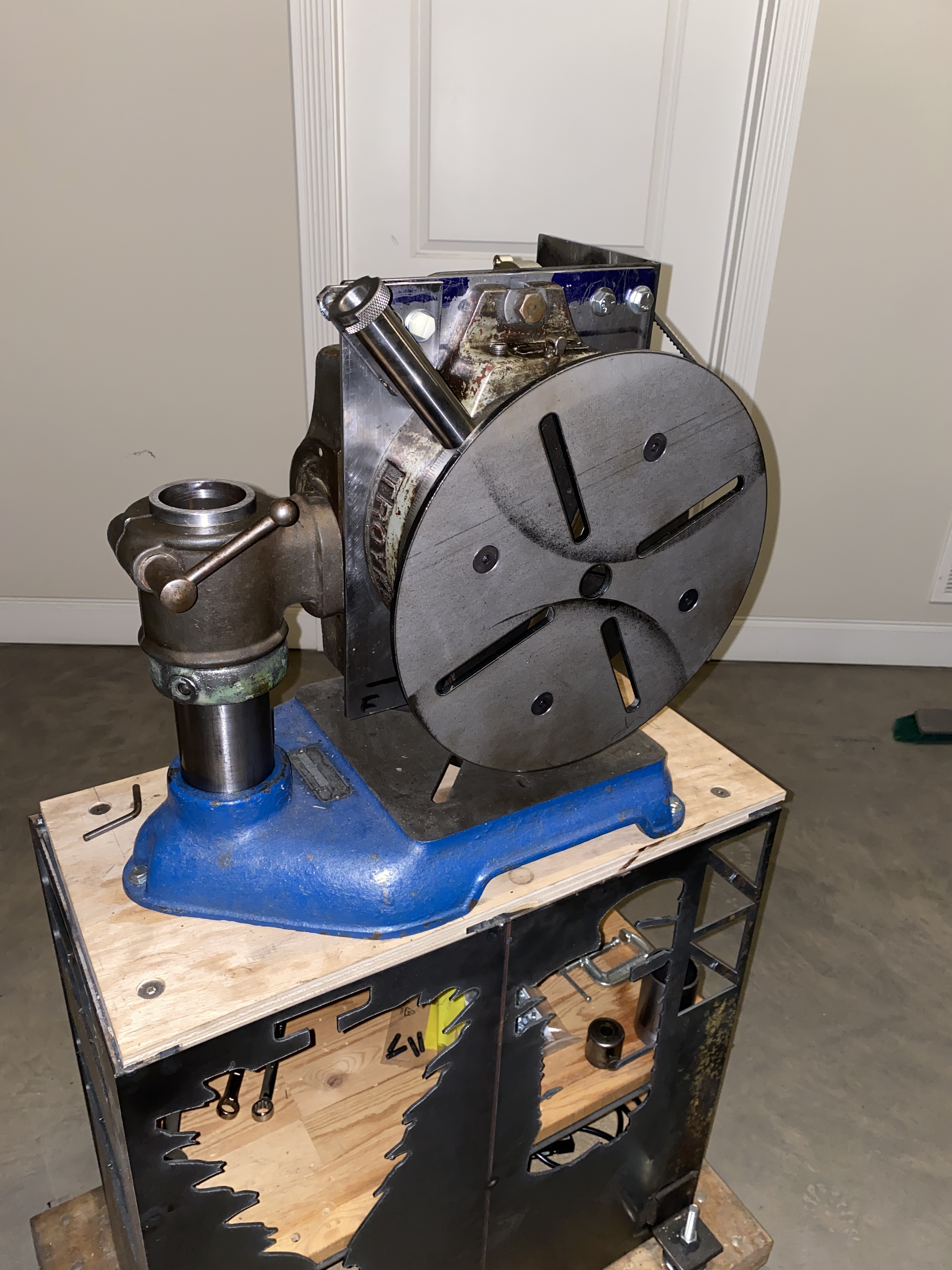

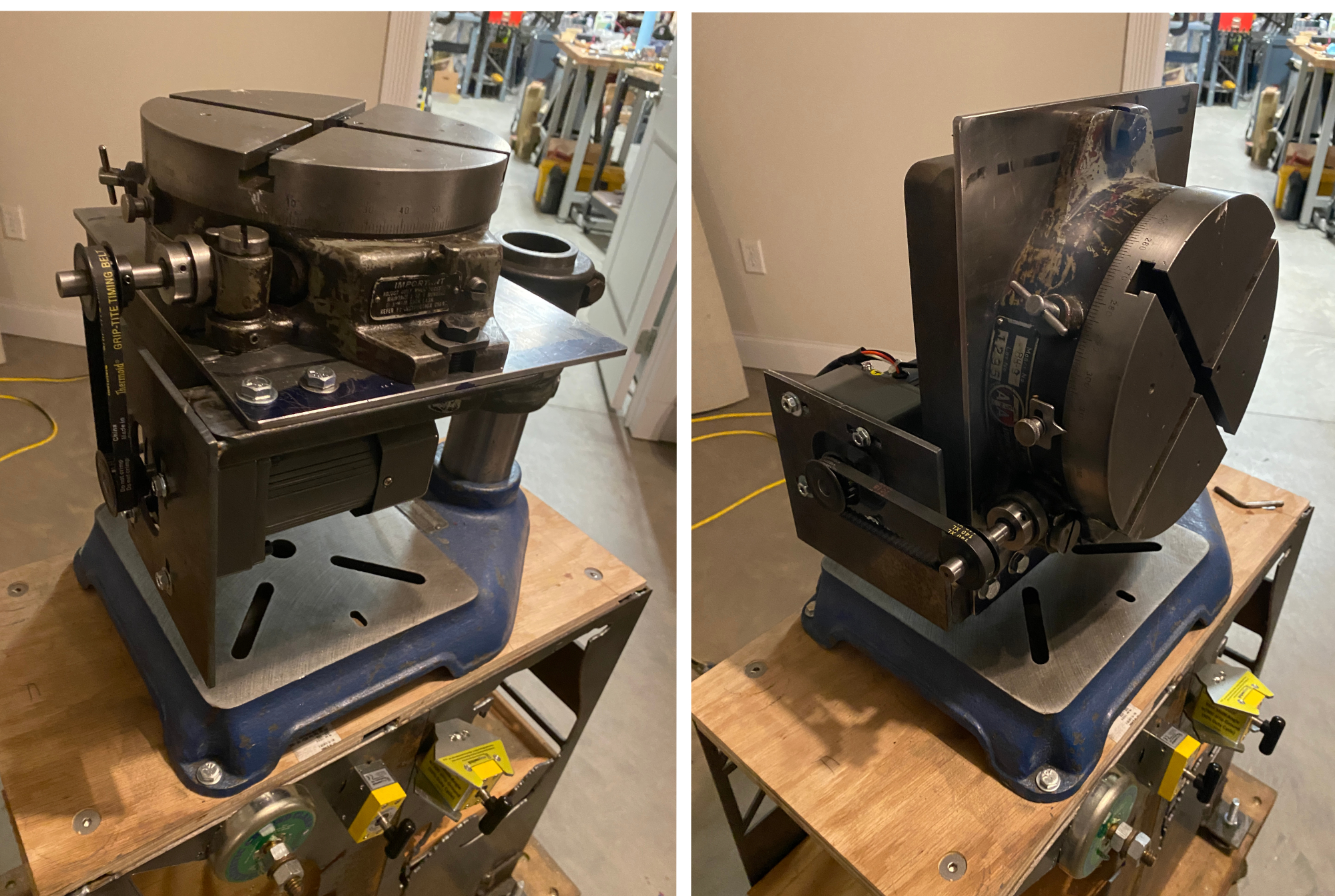

    Finished with welding positioner project:
    Rotating Welding Positioner Project-w-vise-1_75mb.jpg Rotating Welding Positioner Project-45-degrees.jpg Rotating Welding Positioner Project-90-degrees.jpg Rotating Welding Positioner Project-support-table.jpg

    IntheGroove's Tools
    You could make an apron from a welding blanket to keep splatter off...
