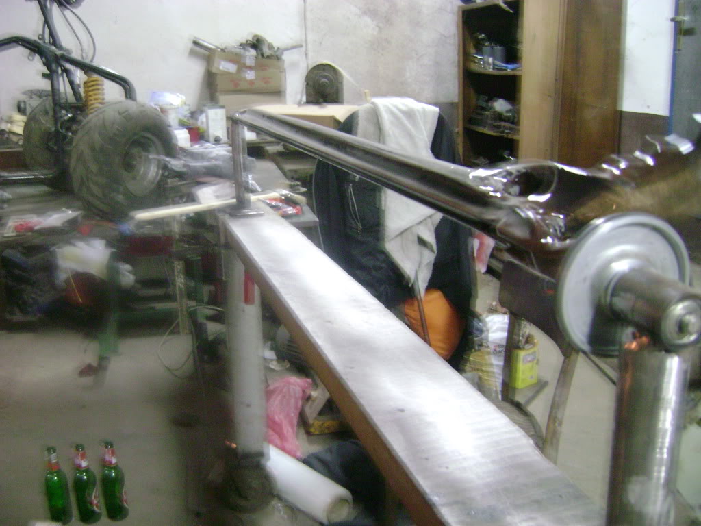

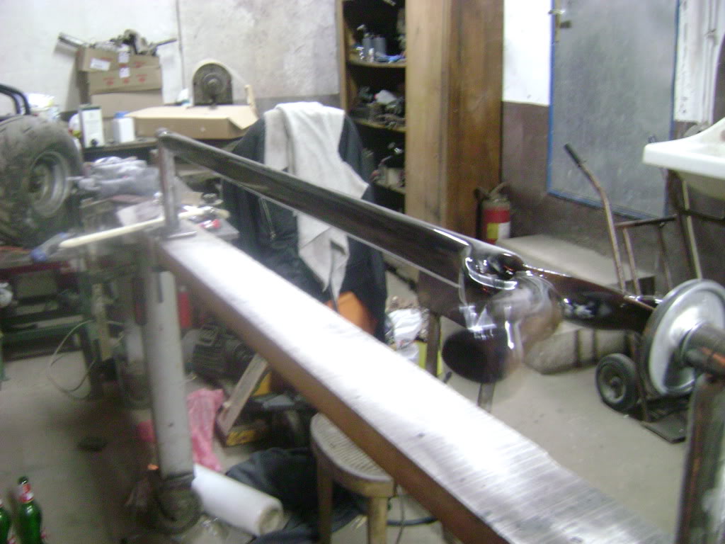

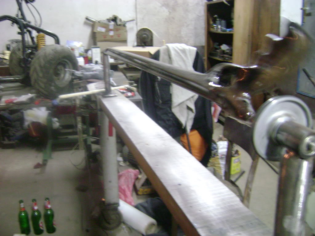

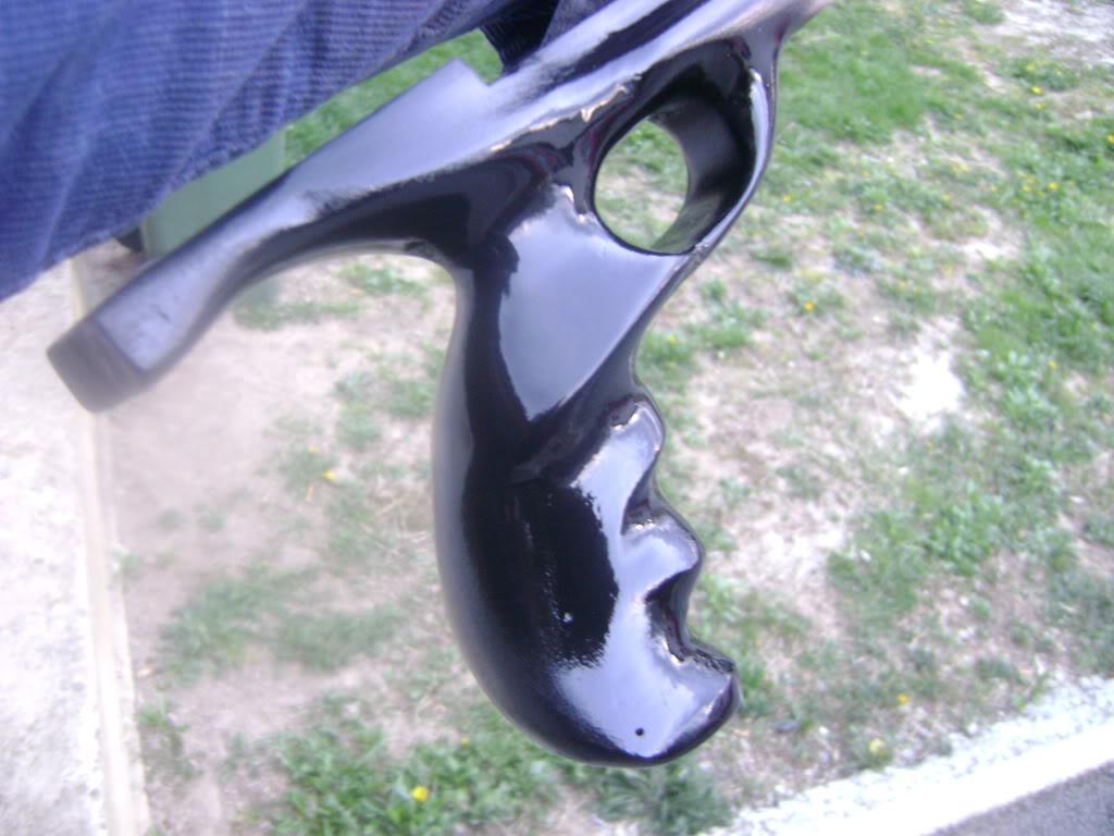

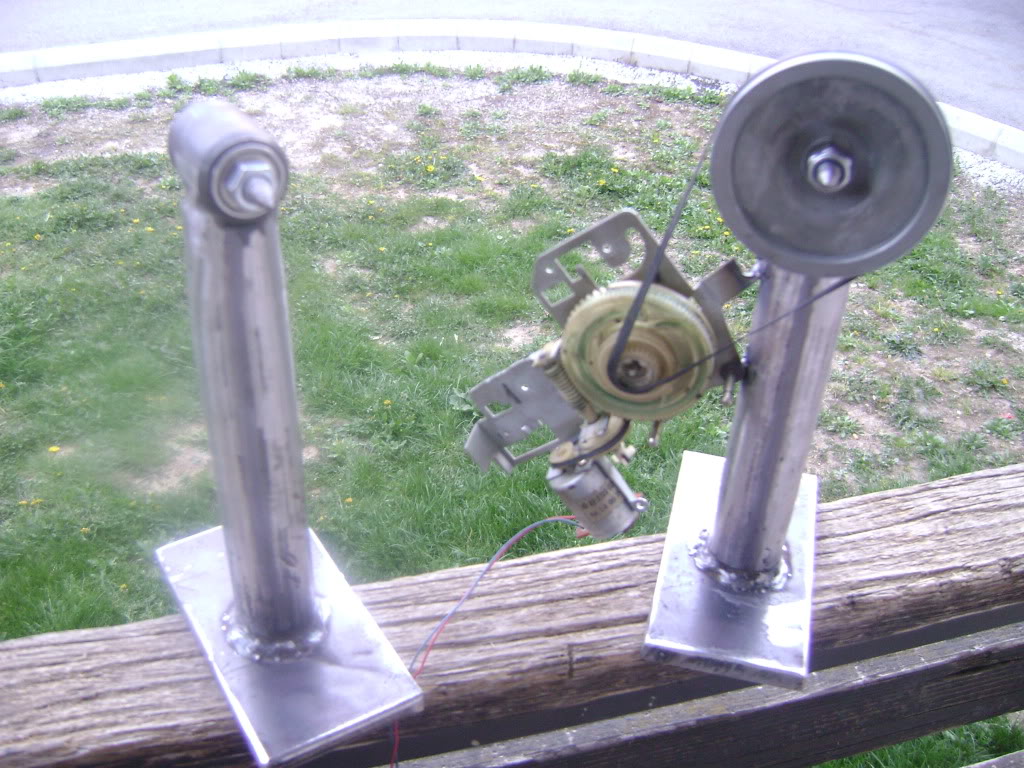

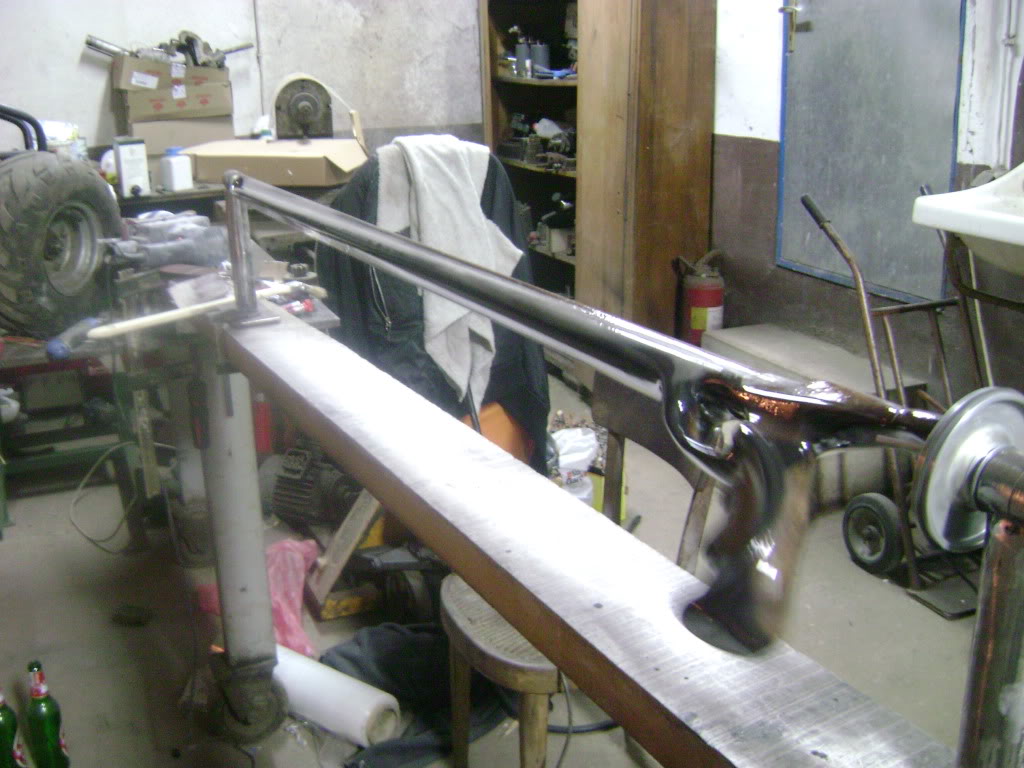

    Old VHS DC motor, small tubes, bearings and battery 12V:
    Rotating epoxy coating mechanism-1.jpgRotating epoxy coating mechanism-2.jpgRotating epoxy coating mechanism-3.jpgRotating epoxy coating mechanism-4.jpgRotating epoxy coating mechanism-5.jpg

    Not clear how do you apply a resin ??

    The epoxy resin is applied to the brush and the rotation creates an even layer of resin in circular shapes.

    I guess that rotational speed is low to avoid centrifugal forces impact on paint collecting on the tip.
    One short video would be helpful ...

    10 rpm is fast rotation.
