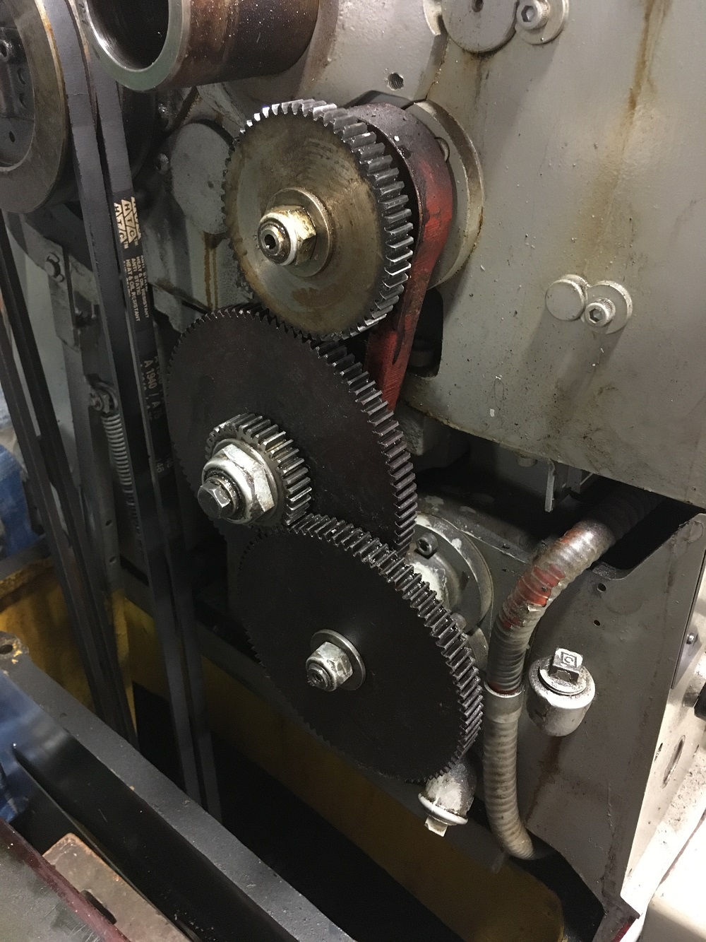

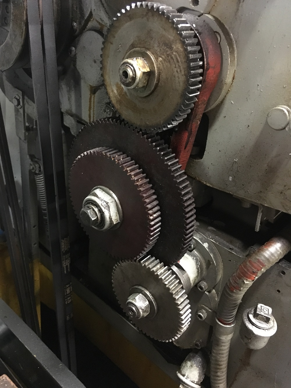

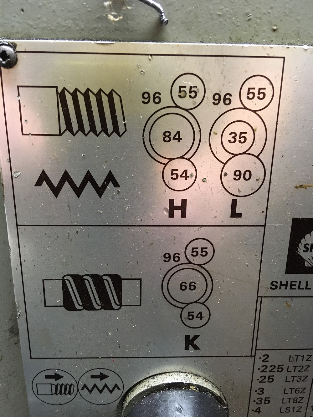

    The shaft blank was machined and the lathe gear box/gear train set to the Mod 2 mode.
    Gear selection chart
    Mod gear train
    Standard low range gear train I normally use

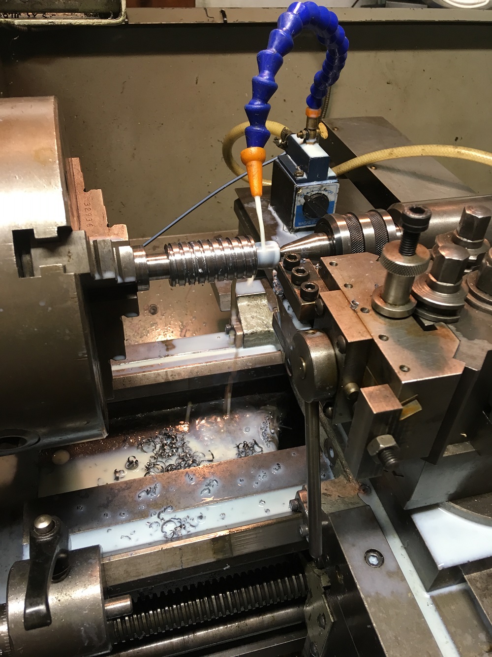

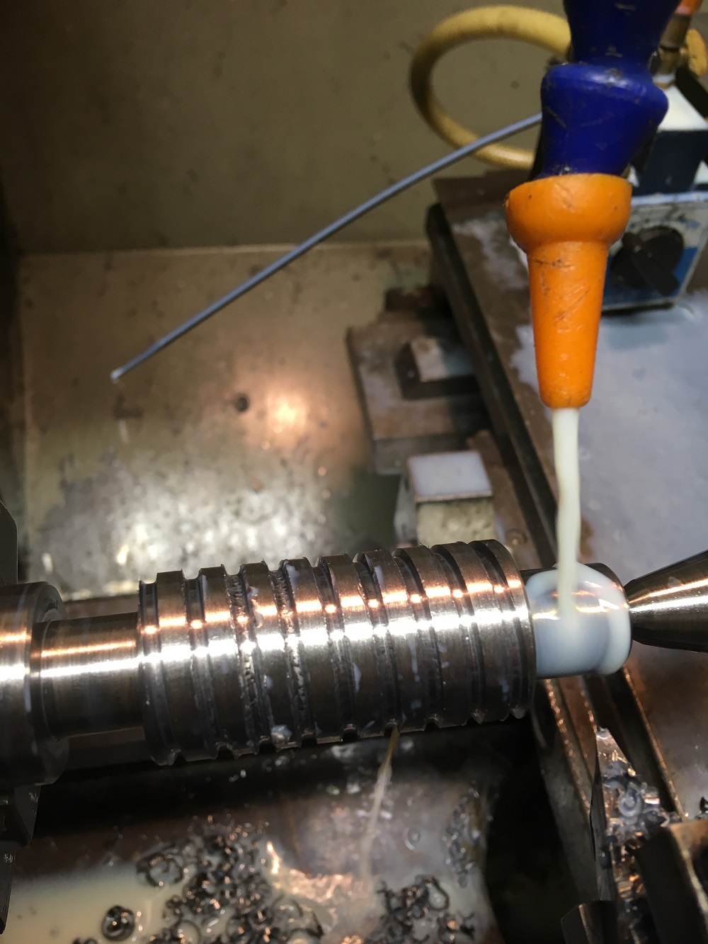

    First few passes.
    Retracting tool makes the process a lot easier

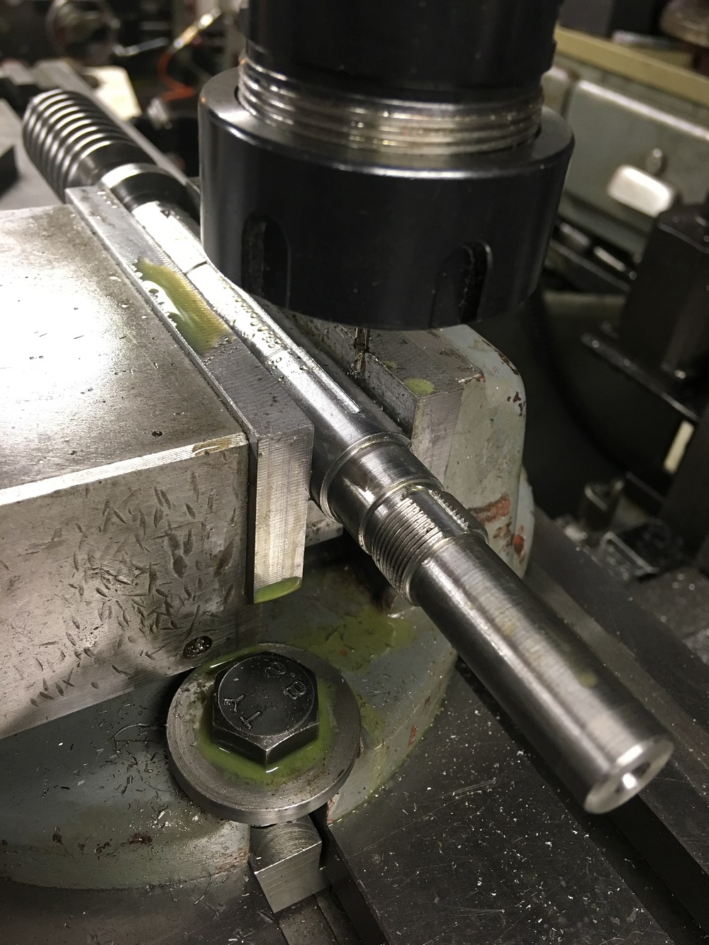

    Milling oilway and lock washer tab slot

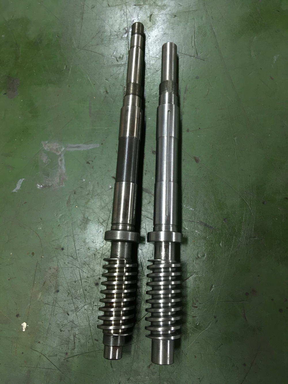

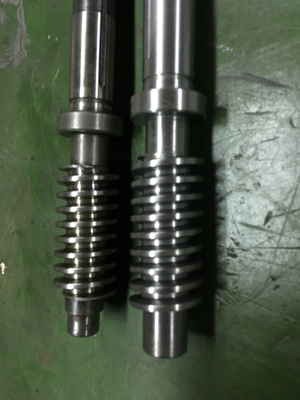

    Finished worm
    Both shafts

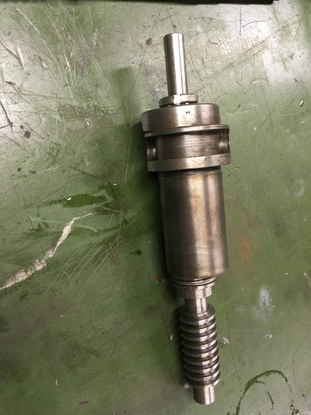

    Assembled new shaft assembly

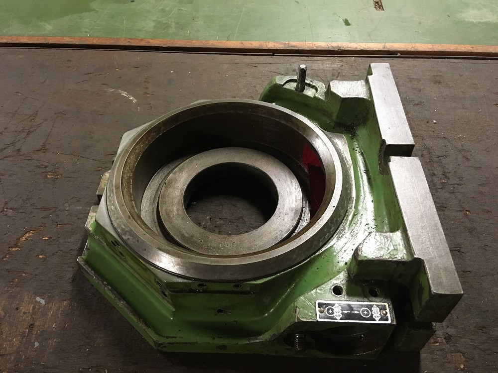

    Rotary table casting
