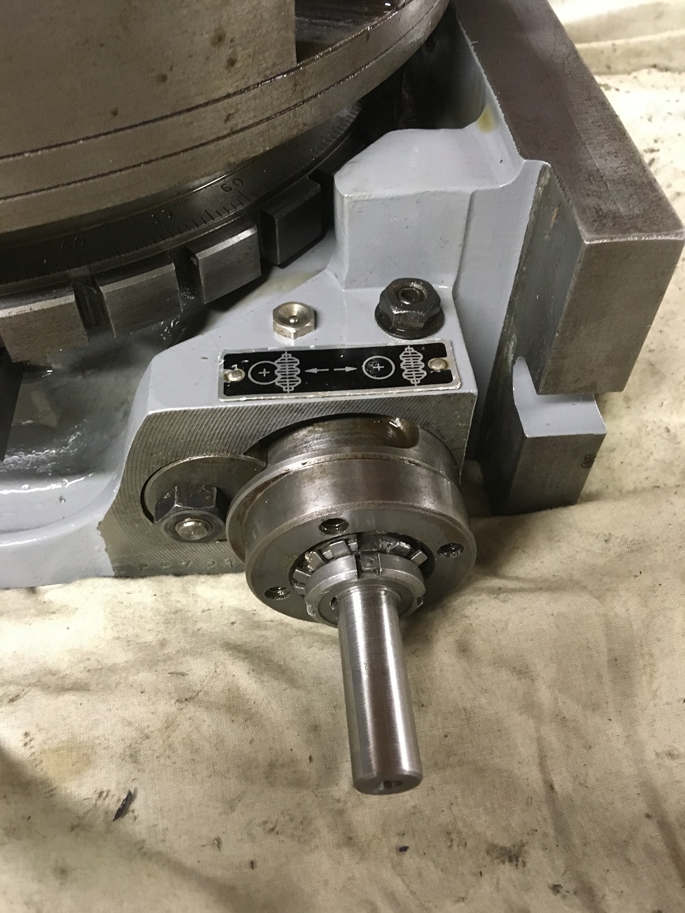

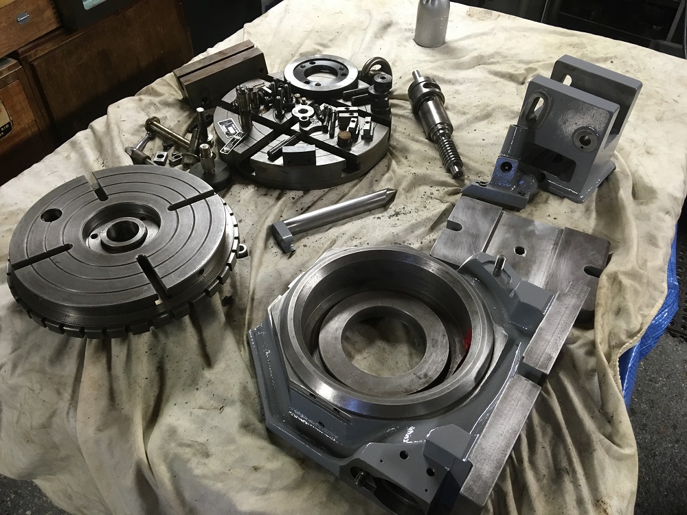

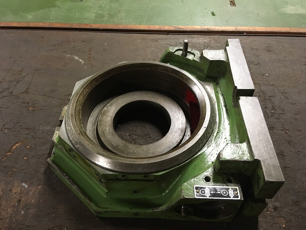

    This is the progress so far on the motorisation of my rotary table. Both the table and tail-stock were striped down for cleaning as I had to make a new modified worm shaft for 14mm Flexible Plum Coupling, so thought it would be a good idea as I had to take some of the table apart to get the old shaft out. rotary table worm shaft

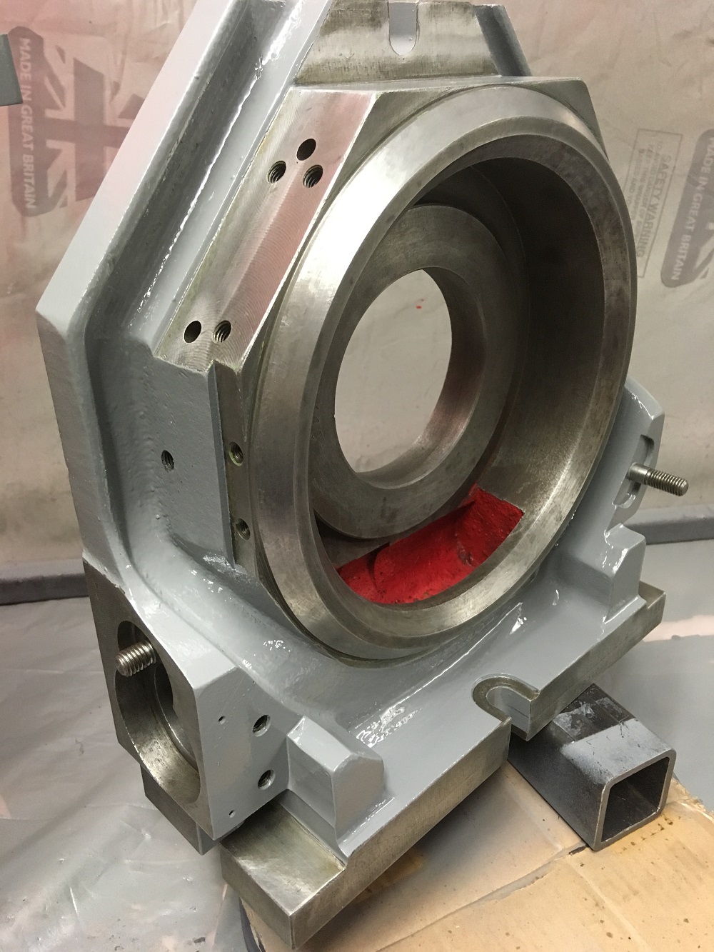

    Unfortunately I got a bit carried away and decided a re-paint would be a good idea

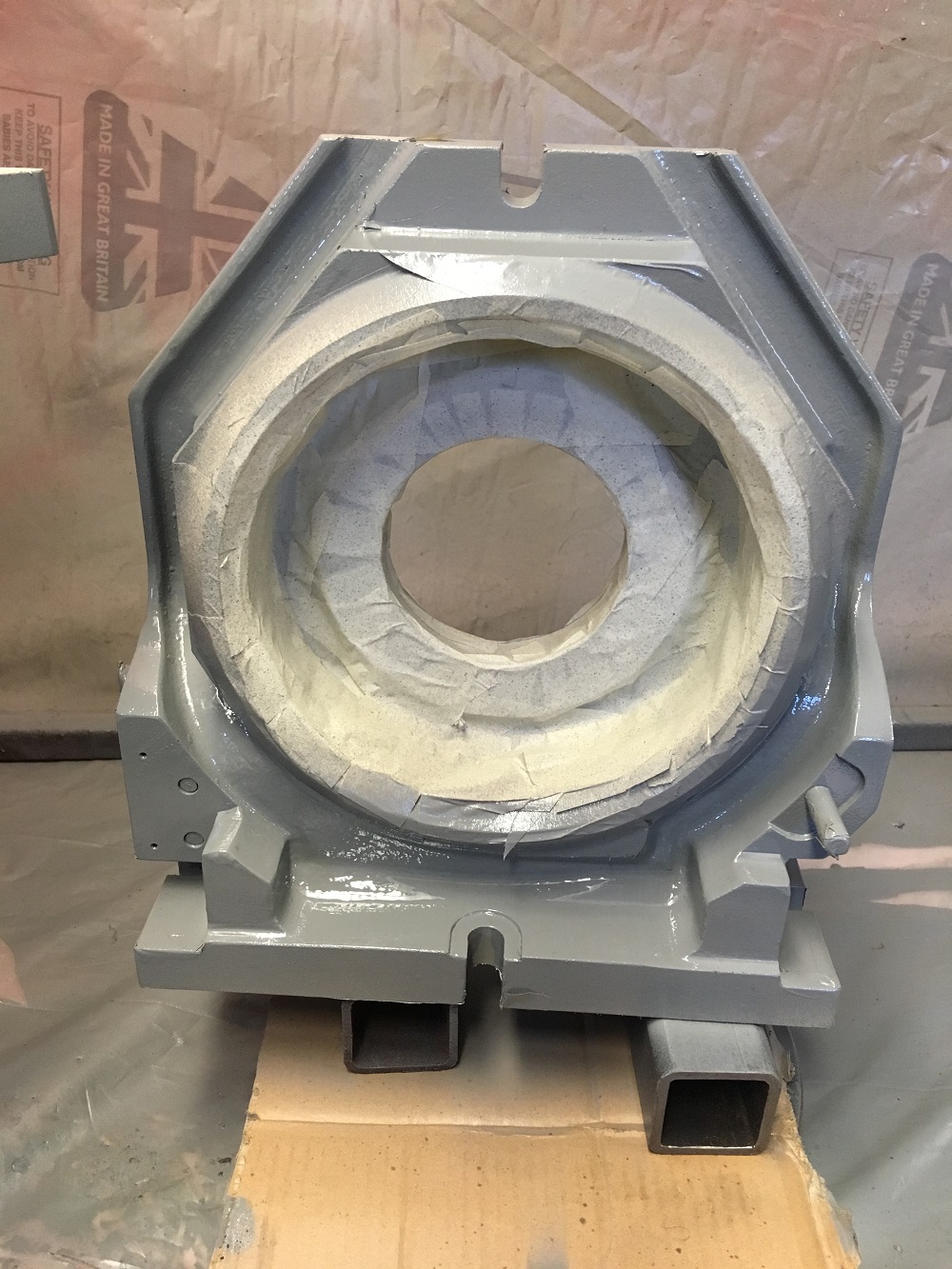

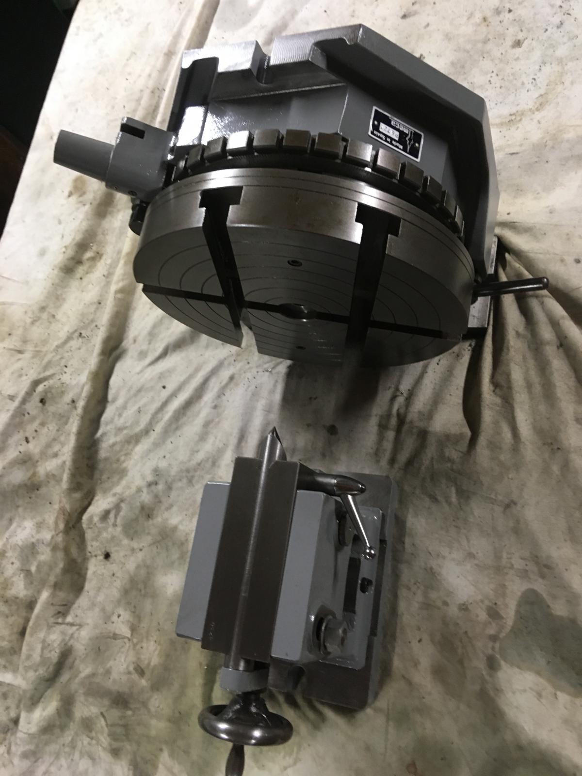

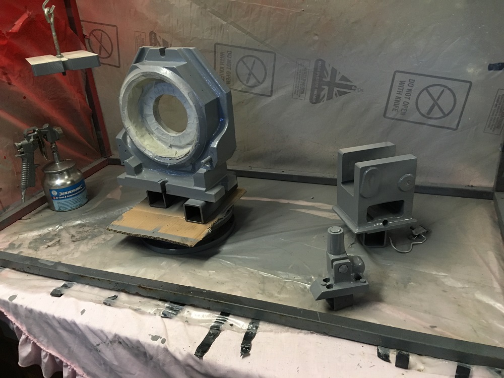

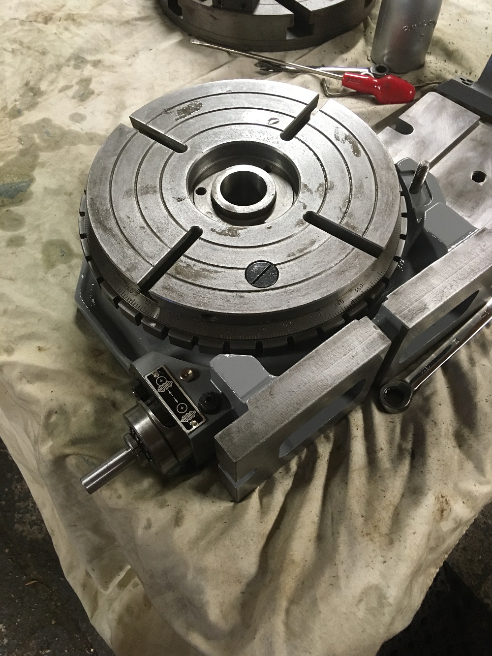

    So all the the castings were striped down to bear metal and sprayed. I have reassembled both table and tail-stock and I am happy with the result even though I did wonder if it was worth it at the start.
    The next part of the build will be a mounting bracket to go between the Nema 34 stepper motor and the table. Below are some photos of the project
    Rotary table re-ferb ready for stepper motor-old-painted-casting-striped-down-cleaning.jpg
    Old green painted casting striped down for cleaning
    Items sprayed incomplete scruffy spray booth
    Main Rotary Table casting

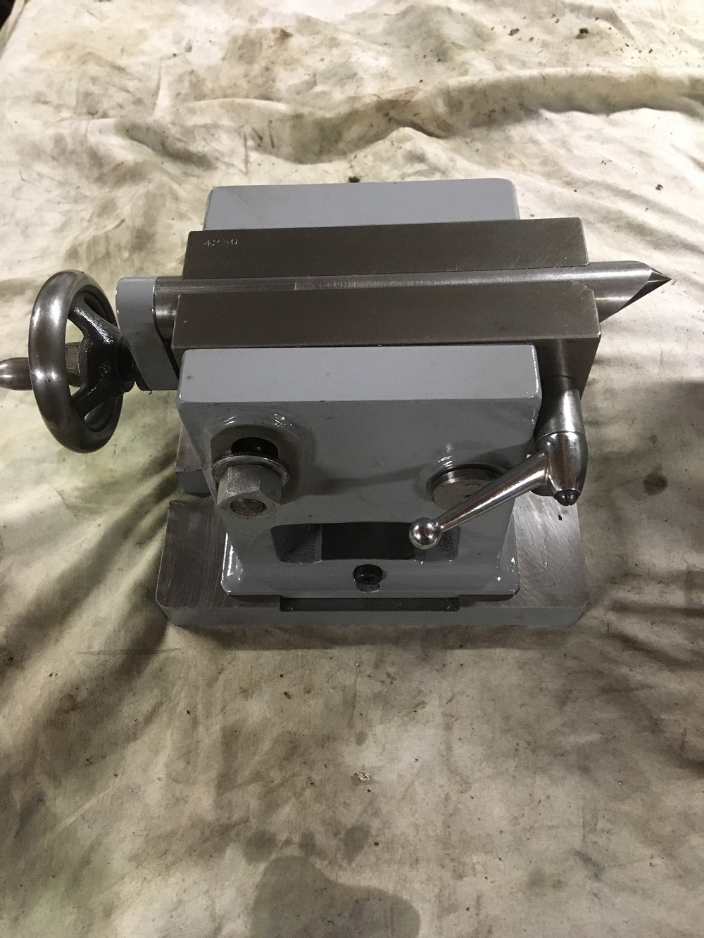

    Tail-stock
    Completed ready for stepper motor etc.
    14mm shaft for Flexible Plum Coupling

    I'm curious about how your going to mount the motor. I had to look up Flexible Plum Coupling, and I think this is called a Jaw coupling here in the states.
    Is that some sort of additional platen that you made that has the parallel T-slots? Seems that would be handy for some setups vs. the radial slots.

    Hi metrc_taper
    There is an additional plate on the table which is very handy for two reasons: like you have pointed out the additional tee-slots and secondly the increase in diameter significantly improving the clamping area. I would like to say it was my idea but I bought the table from a friend who was clearing his late fathers workshop and he made the plate. The tailstock was a good find that just happened to be the correct size. Can’t remember where I found it
    The motor I have is a Nema 34 and I will be making a adapter/housing to join both the table and motor but I am waiting on the coupler to arrive so I can ensure the dimensions etc are correct. I did order a coupling but somehow bought the wrong bore size.
