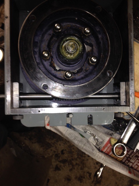

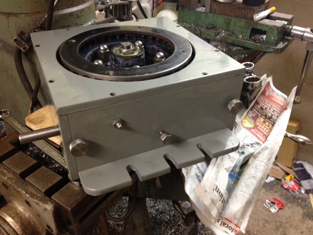

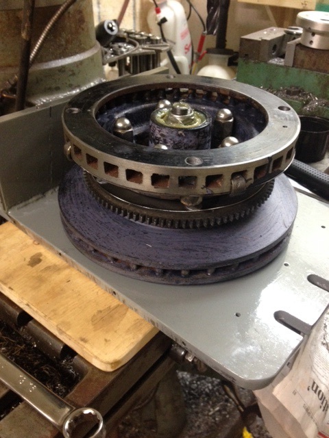

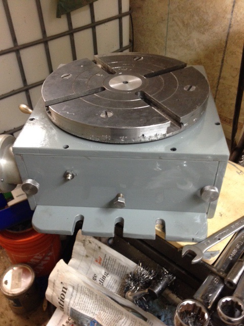

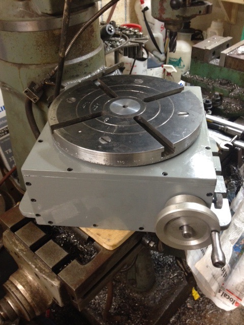

    I wanted a rotary table for my mill but didn't want to have to pay big money for a decent sized one so I made my own 11" table. It's made out of 1/2" plate, 2 brake rotors and a ring gear off a lawnmower engine. I turned a spindle on the lathe and welded it to the bottom plate. A brake rotor is mounted on the spindle. Another brake rotor with the hub cut out is mounted upside down on the lower one. The ring gear is riveted to a piece of 16 gauge sheet metal and sandwiched between the two rotors. I made a worm gear on the lathe. Two thumb screws adjust the worm gear against the ring gear to eliminate backlash. There is a bolt on either side that can be screwed in against the lower brake rotor to lock the table in place. The gear ratio is a bit odd at 97:1. The whole thing weighs 123 lbs.

    Nice job! How did you mark the rotary table tick marks with..out...a ......rotary.........table?

    Quote Originally Posted by mudnducs View Post
    Thanks.
    I printed out a 11" degree wheel off the Internet and glued it to the bottom of the table and then used a punch set to make the degree marks.

    Nice work. Would love to see some of the worm gear turning? Also how you got the lawn mower ring gear mounted and in mesh with the home built worm?

    Nice looking!. Where did you get the actual table portion? Did you machine it yourself?
    And how much rocking deflection do you get under a heavy load? It seems like three roller bearings mounted underneath the perimeter of the lower rotor would prevent it from rocking.
