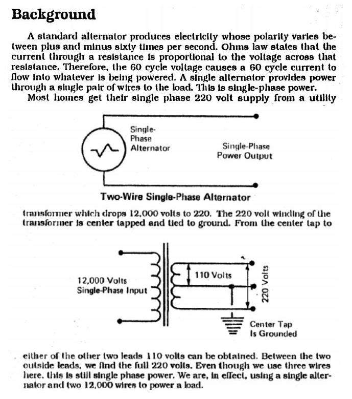

    Smithdoor, your comments questioning the integrity of the Internet are not groundless. However, I have found yet another text and drawing NOT from the internet but from a 40-year-old publication that is in FULL agreement with the previous text and drawing that I submitted a few days ago.
    Rotary Phase Converter (Create 3-phase power from a single phase source)-lindsayschematic.jpg
    What say you now?

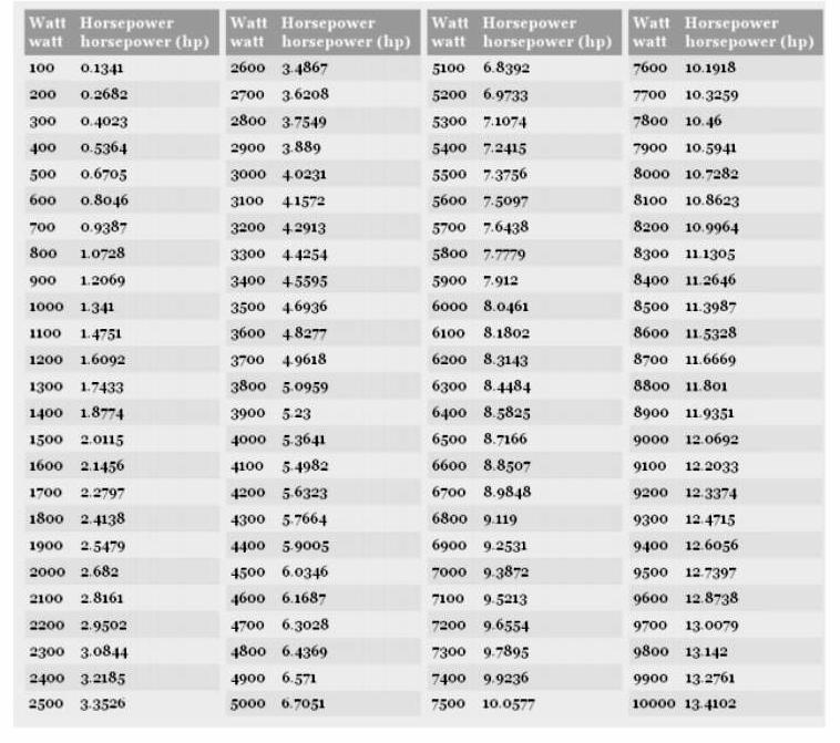

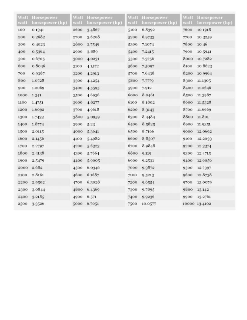

    After sleeping on it for a bit, I believe an isolation transformer transformer may (or may not) be your wisest choice. Immediately below is a watts to HP chart which should be useful in sourcing a proper transformer.
    Rotary Phase Converter (Create 3-phase power from a single phase source)-wattstohpchart.jpg

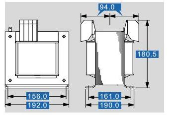

    Next is finding a transformer with the proper KVA rating. For 3HP you'd need about 2400Watts so I quickly looked at the Newark catalog.
    http://www.farnell.com/datasheets/18...440.1484843408
    Rotary Phase Converter (Create 3-phase power from a single phase source)-nawarkisolationtransformer.jpg
    The cost is around $450 US plus shipping. The transformer above is NOT the exact one but it is representative of the device you'd need for 3.0HP. If you'd like for me to try and find the exact one let me know. It is not totally unlikely that you may need two transformers to do what you need to do.
