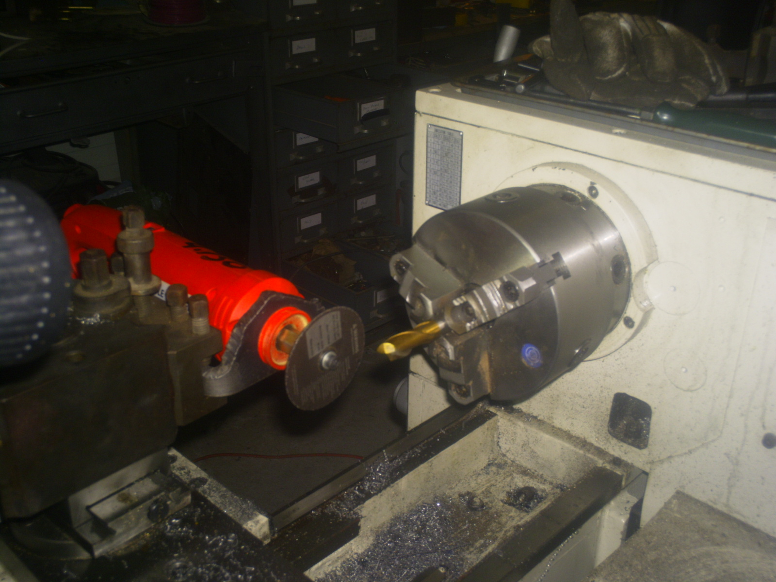

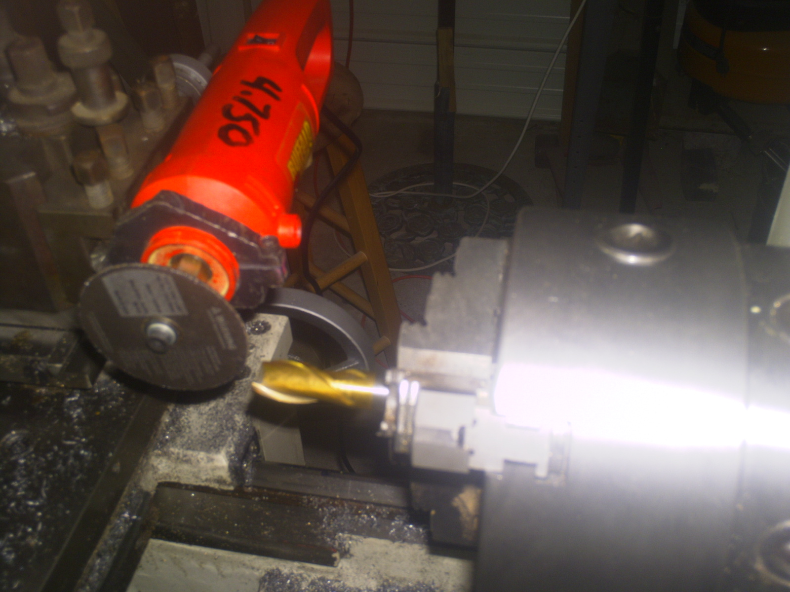

    rotary cutter tool post mount-pict0006-1-.jpg rotary cutter tool post mount-pict0007-1-.jpg built bracket to mount rotary cutter on toolpost mainly to sharpen end mills

    Is that simply an abrasive cutoff disc you are using to sharpen the end mills or is it something a bit more special ?

    just abrasive cut off disc. worked really good I was about .250 above center
