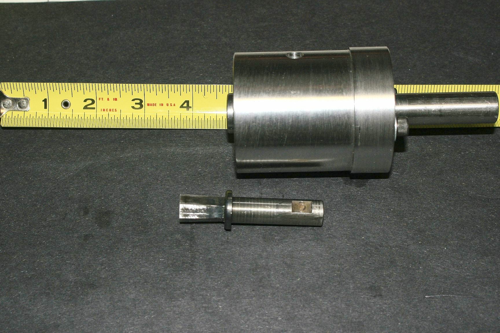

    This was my first simple Rotabroach.
    Shop Made Rotary Broach with plans

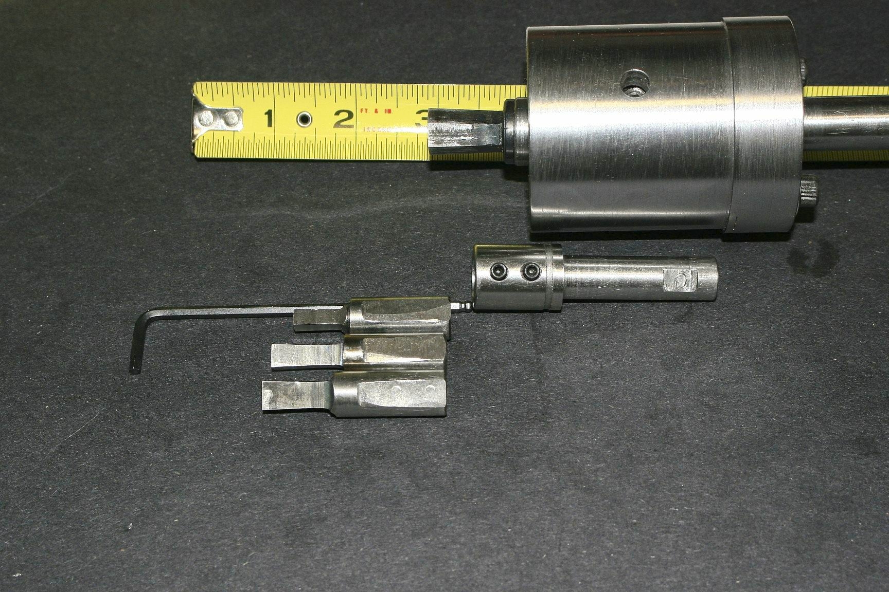

    I needed something heavier so I made a copy of Doug Ross's super broach:
    Rotary Broaching Tool
    Using annular and thrust bearings this one reduces much of the friction generated by the broaching action.
    In the second picture I have made an extra spindle that can hold my older rotary broach cutters.
    I wanted to be able to use the smaller tools in my new broaching tool.
    This tool cuts like butter. I ran it thru a 3/4" thick piece of aluminum and it ran smooth as silk. Keeping cutting oil on the broach the entire way.
    Here are a couple of pics of my copy of Rossbotics broach:
    Cheers, JR
