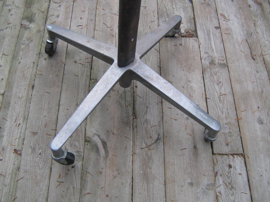

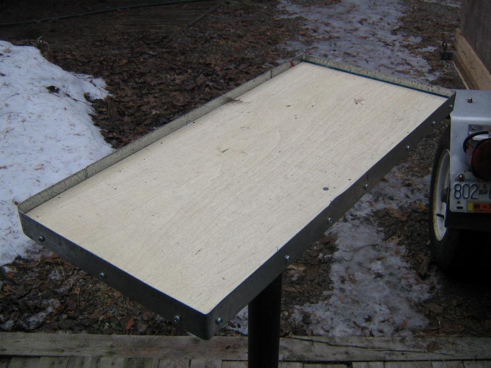

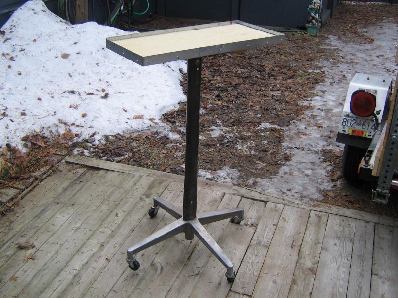

    Since I don't use a rollerchest around the shop I've found this lightweight rolling table perfect for holding tools & supplies while working on vehicles, or for doing projects around the yard, it's height is the same as my shop benches at 40" so it can be used to support longer items I have on the bench, the base was from an old office chair, I cut the original seat mounting plate off leaving enough of it's shaft attached so it could be bolted to a length of thinwall 2½" pipe, the top is a ½" x 12" x 26" piece of hardwood shelf, it's edge wrapped with 1¼" strapping to keep items from rolling away.
