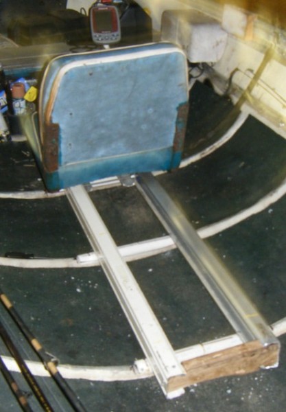

    I got some Awning struts after a Tornado came through here.

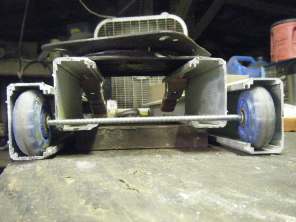

    From some Roller Blades, I got some nice durable Rubber (quiet) wheels with Roller Bearings inside. That's important, because you want this thing to be drag free.a Rolling Rowing seat for a small boat.-inline-3.jpg

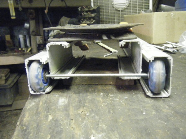

    From the Barn I got an old Lazy Susan for Boat seats. I mounted that Metal part on a couple of Axles made of 'allthread' and put that Carriage inside two lengths of Awning strut.
    a Rolling Rowing seat for a small boat.-all-front.jpg a Rolling Rowing seat for a small boat.-inline-skate-wheels.jpg
    Perfect those wheels just fit perfect!a Rolling Rowing seat for a small boat.-all-way-back-480-x-360-.jpg
