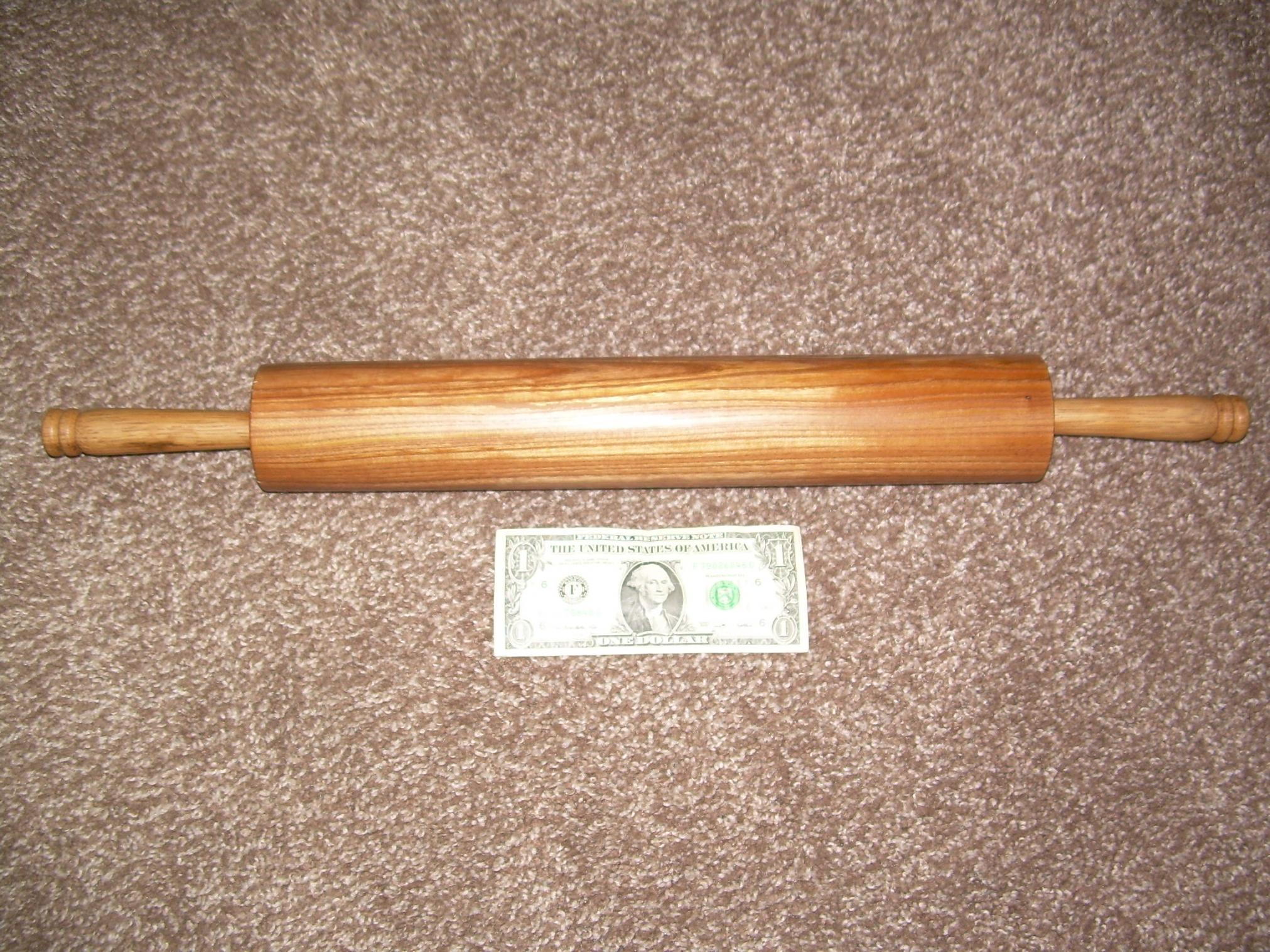

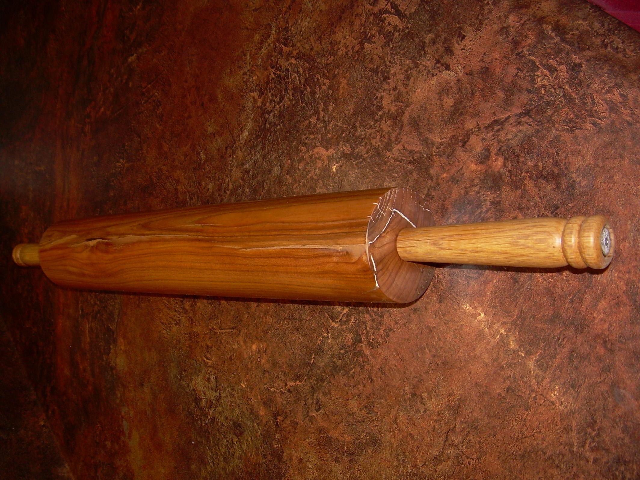

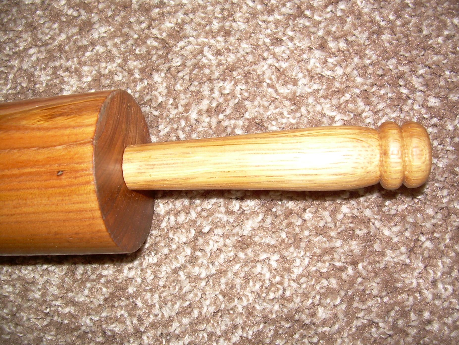

    This may not be a shop tool but it sure is a kitchen tool. Made this out of a red elm tree that had fell over in the timber close to my home.
    The handles are made out of oak chair spindles sanded down and drilled to accept a 5/16 bolt which then threads into the ends of the rolling pin. I try to keep this away from the wife anytime she gets a little annoyed at me which does not happen too often. I used a food safe oil on the wood. Rolling pin-rolling-pin-pup-005.jpgRolling pin-rolling-pin-pup-006.jpgRolling pin-rolling-pin-pup-007.jpg
