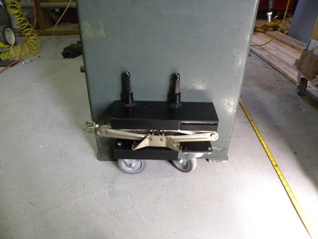

    I have finally got my Clausing 8520 Vertical Mill rolling!!Rolling Mill-dscn7737-1024x768.jpg
    My shop is relatively small, from my perspective so everything has to move.
    I have been working on this project for a year and a 1/2.
    Now I can easily move my mill, actually where it is now sitting might be it's permanent location.
    But I can move if necessary and lifting it will help me put shims under to level.
    Ralph

    I like this idea. What are the two vertical bits for? Nice to see more pics with it up and the lifter spread out
    Dec 2016
    1,743
    3,341
    Ralphxyz's Tools
    The two vertical bits are to keep the lower wheeled assemble in line.
    Without the two vertical bits the lower piece would travel out from under the top piece, with a horrible thud.
    This keeps everything aligned.
    I will post some pictures with the lifter spread out, but it really only needs to lift the mill a 1/4" at best, just so that there is ground clearance.
    The lifters are Honda car jacks, they easily lift the mill.
    The link to my website shows more pictures.
    Ralph

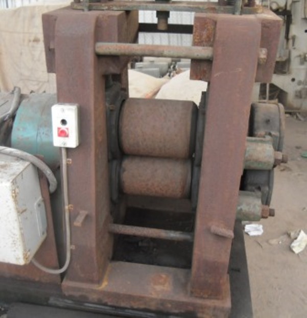

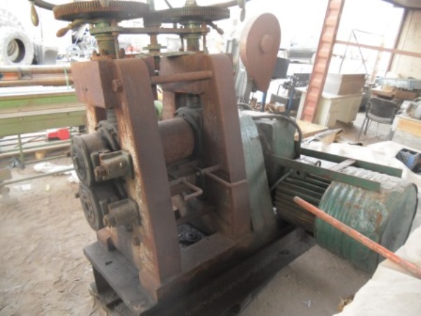

    When I first saw the thread name rolling mill my first thought was of the rolling mill I bought shortly before leaving Kuwait but was un able to ship it this is what I thought of
    It wasn't until I read your post that what It actually was was a means of rolling your mill around

    The screw jacks work well, there are things to watch out for, like the need for the vertical stiffeners.
    If you jack one side higher than the other it is surprising how much more torque is needed to to raise the jack further, you understand real fast that you are dealing with considerable weight.
    The channel iron is 4" x 12" x 3/8", 18"+ would be more stable, and with 6" channel you could get full swivel with the swiveling castor.
    Again one only needs 1/4" ground clearance but it can go higher, with caution when moving. If really jacked up I would only roll front to back and
    not try to make any turns.
    At 1/4" you can spin it around.
    I started think about doing this a year and a half ago, finally got to put it together.
    It was fun I got to use my Harbor freight Inverter welder, which was perfect for this job, I got it on sale for $99.99.
    I also learned the usage of a boring bar, that was something I had not yet gotten to so that was fun.
    I only ruined two carbide boring bars. Finally got the feel for it, I will be doing a lot more boring I am sure.
    Ralph
