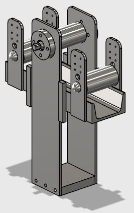

    Roller for square tube
    Above my idea for a roller-bender to bend square tube 25x25x1,5 mm.
    I'll use a small 2 ton hydraulic bottle jack as bending force.
    The parts are almost ready now so I hope to show the result in a few weeks.

    Hi Bullet500,
    Welcome!
    Looks like a solid roller design - let's see some pics of the fabrication process…
