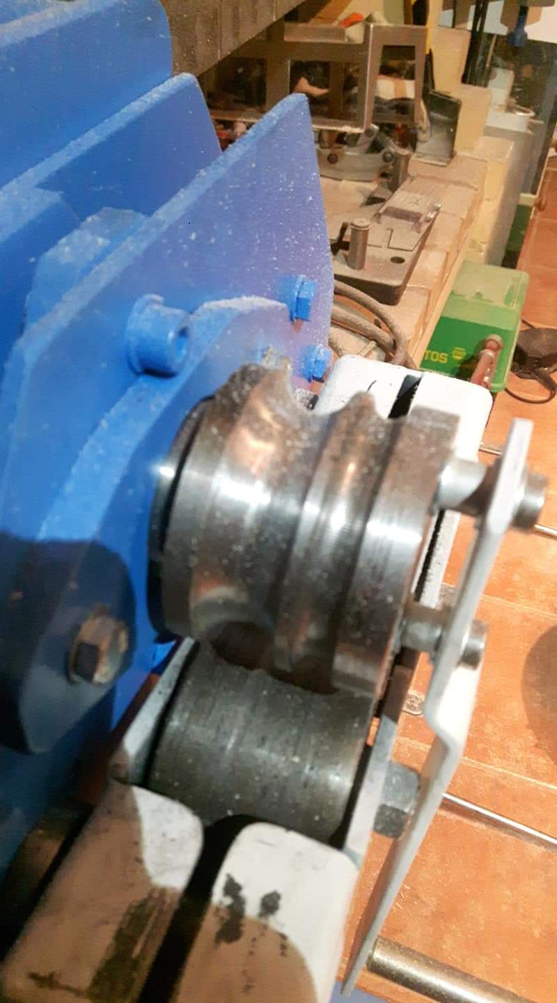

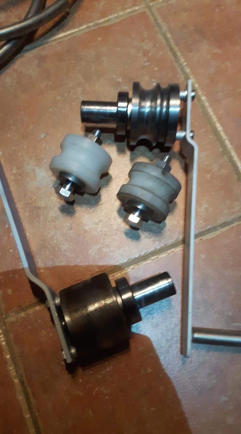

    Pictures from pipe rolling adds.
    When rolling 10-12mm pipes. Only "drive wheel" needs to be changed.

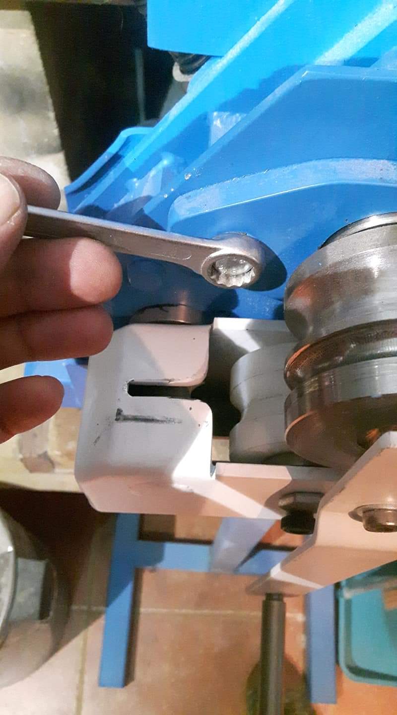

    Changing wheels..

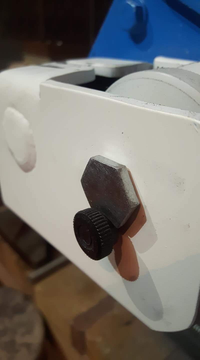

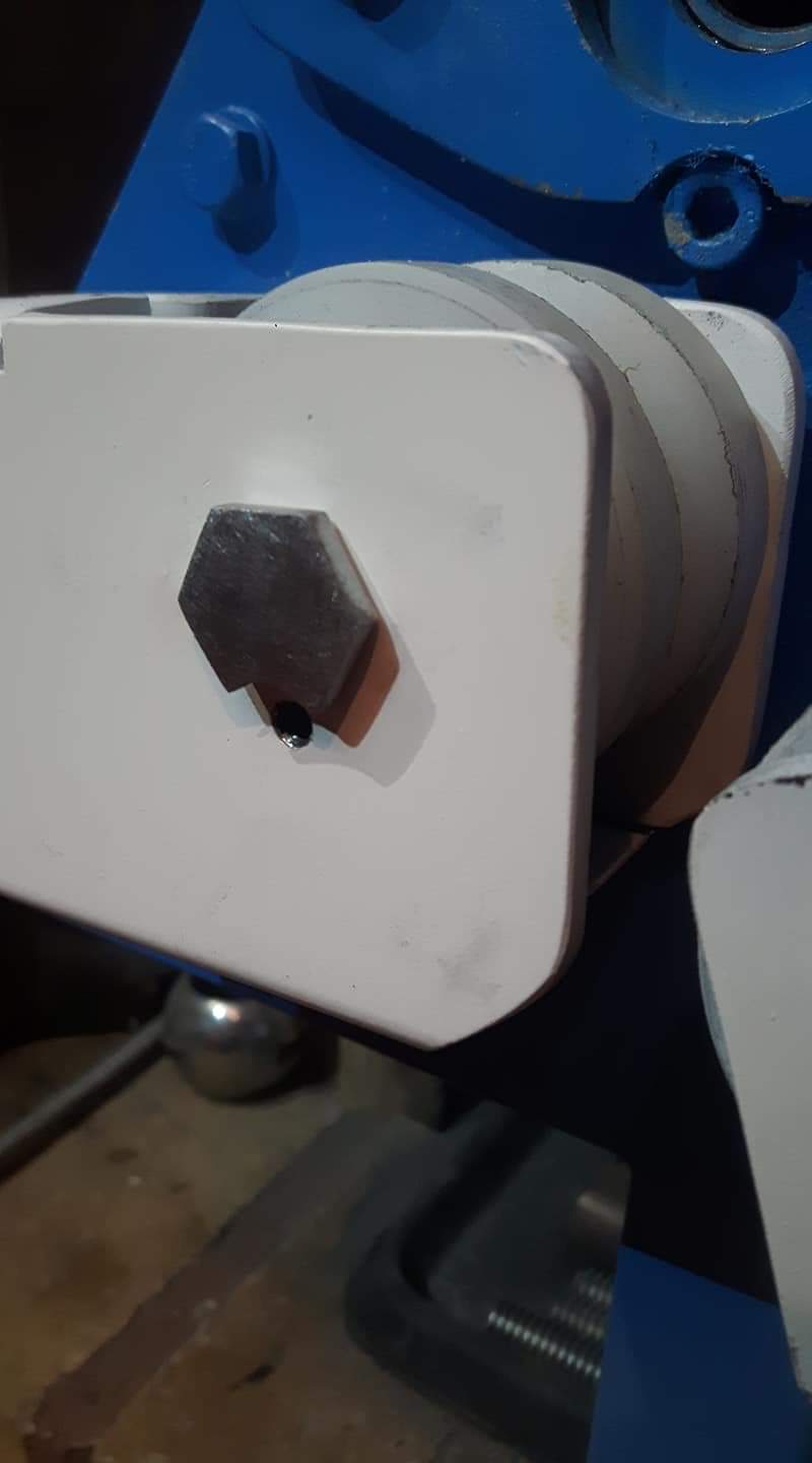

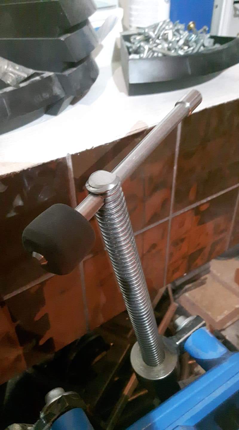

    Also made more userfriendly handles.

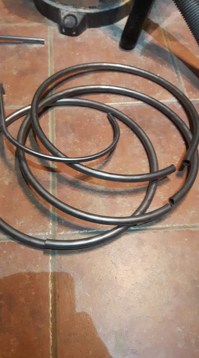

    And rolled pipes.
