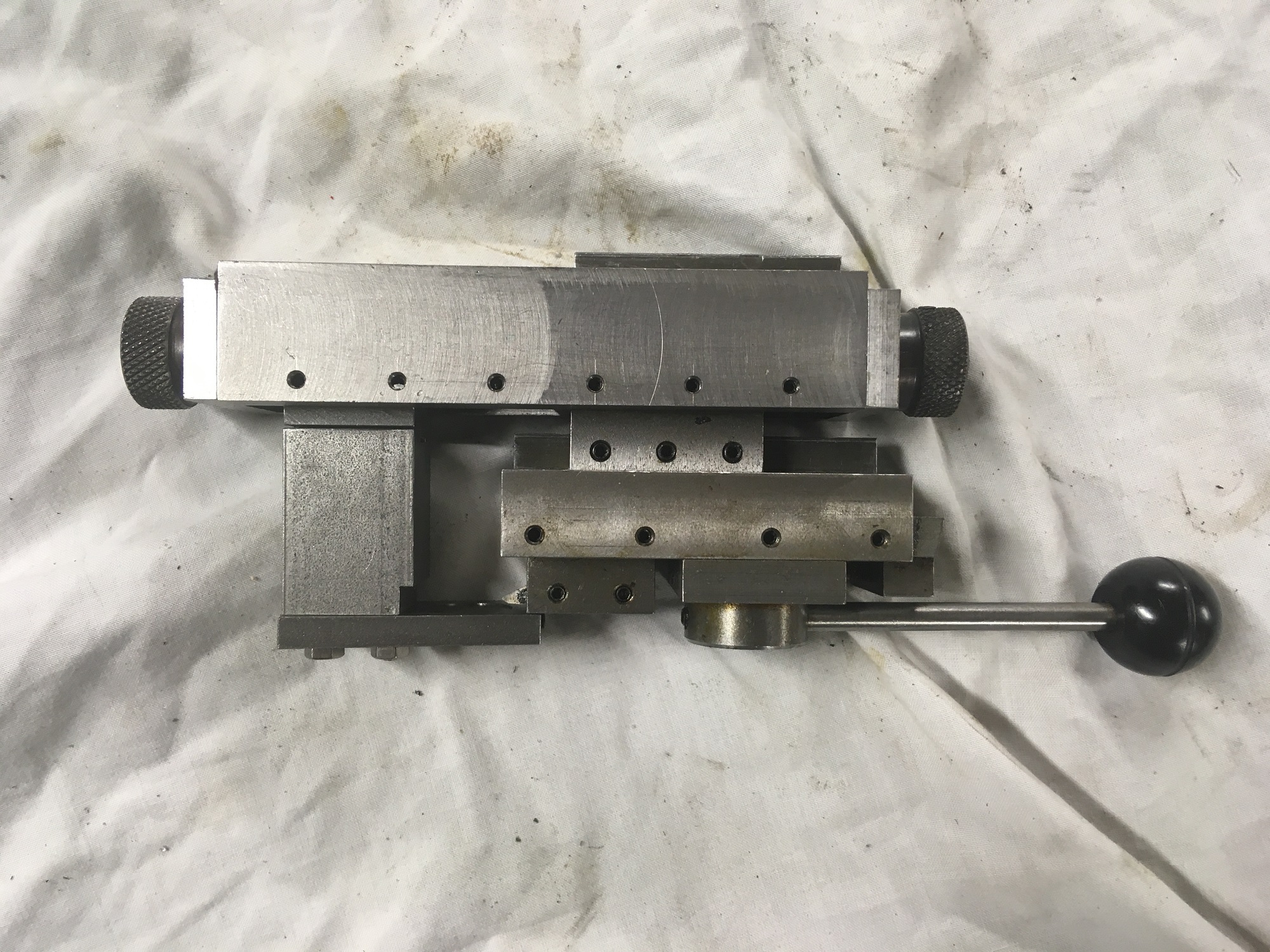

    This tool can be used to cut several different diameters and also be used to screw cut small diameters. The retracting screw cutting tool is adapted from a designed by G.H. Thomas to suit my roller box.
    Modified retracting tool (original design by:G.H Thomas)

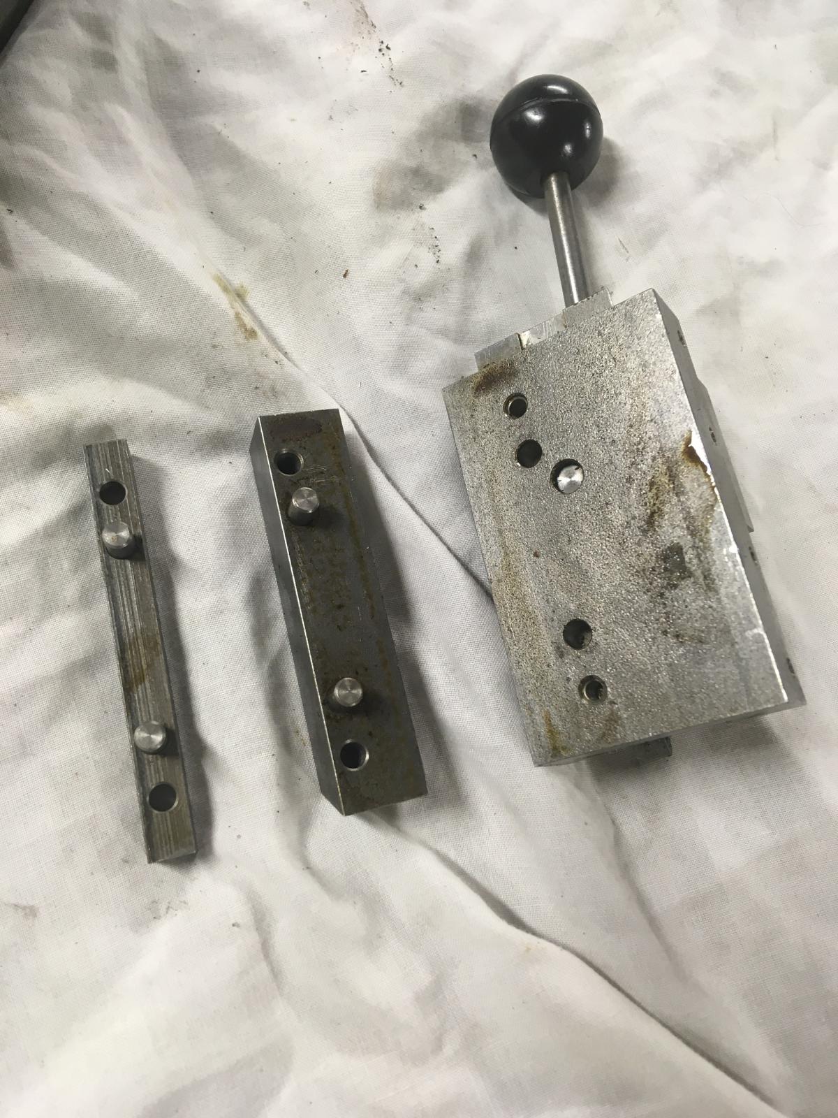

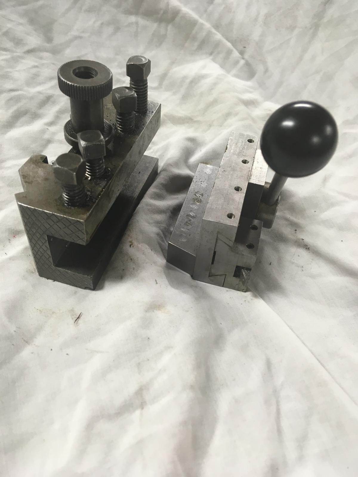

    Tool clamping stock can be changed on the back of the retracting tool so it can be used in a standard tool holder, small tool holder or the roller box. The roller box can also be used in the Myford or the much larger Colchester by changing the clamping stock on the back of the roller box.

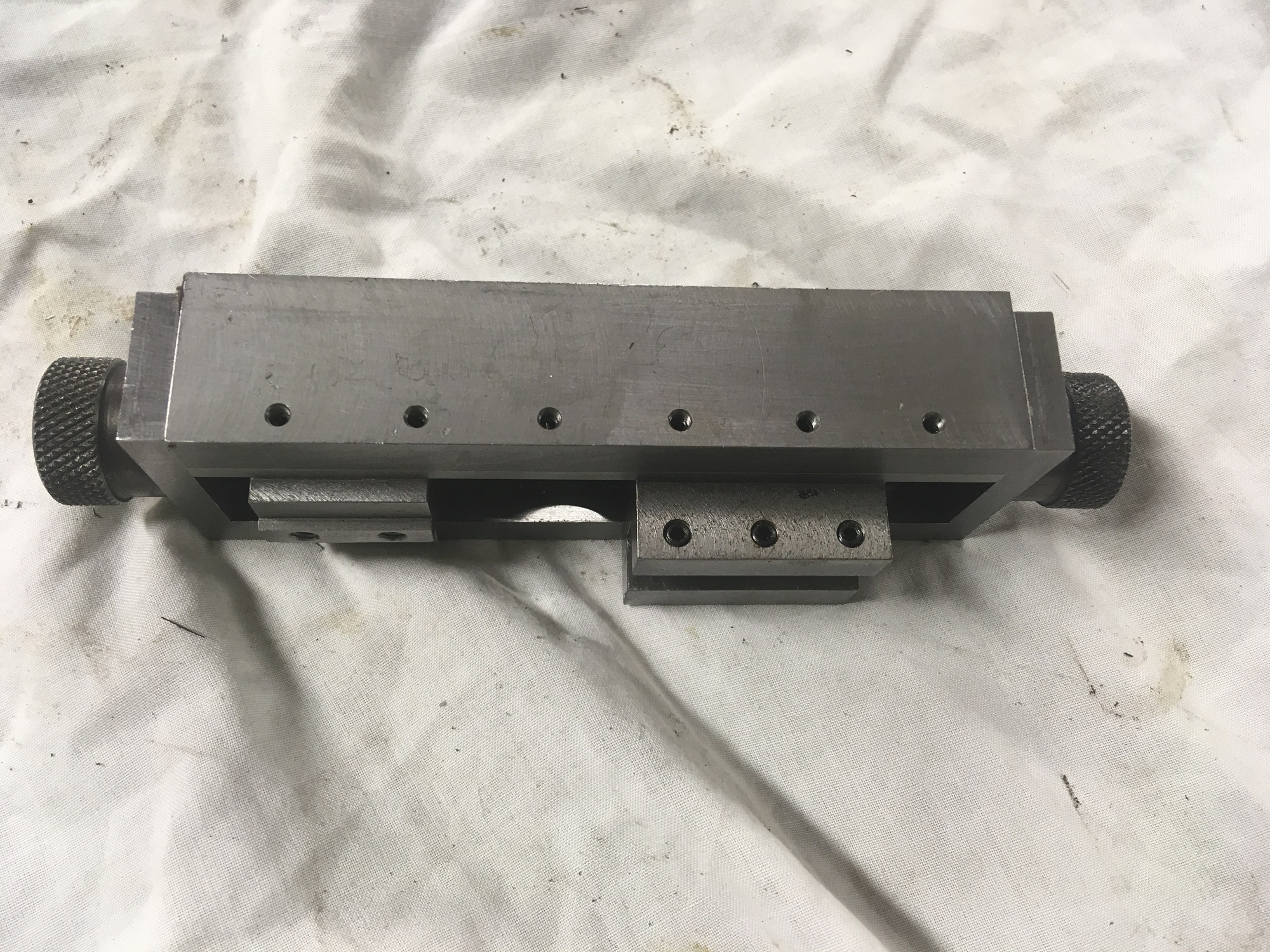

    Roller box main body without tool or steady fitted

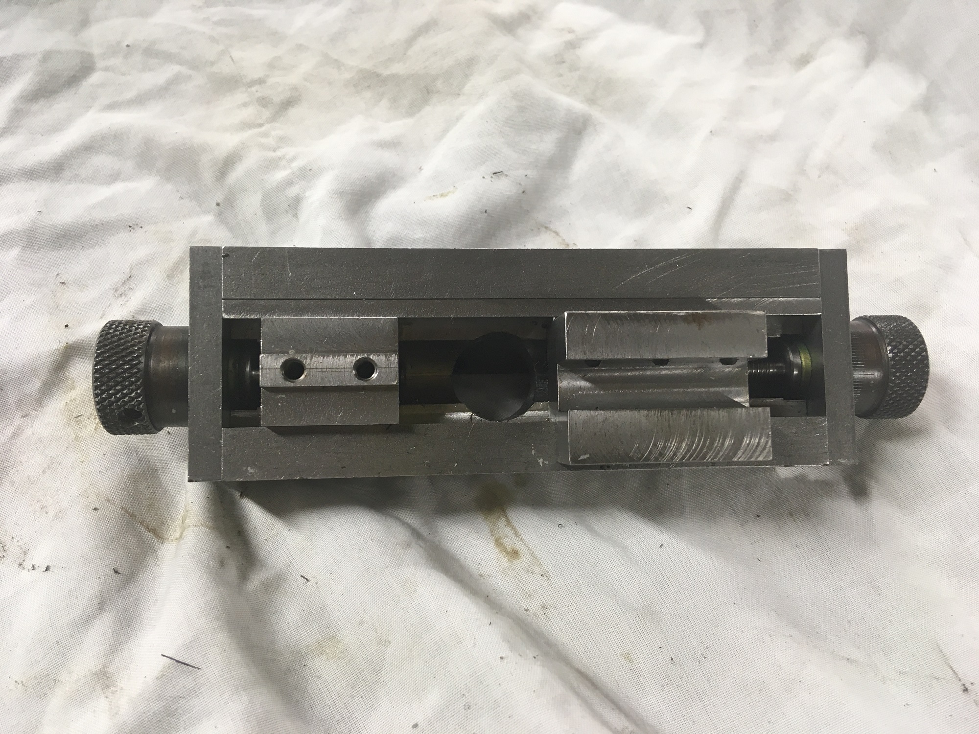

    Roller Box with adjustable in feed for screw cutting-roller-box-top-view.jpg
    Top view

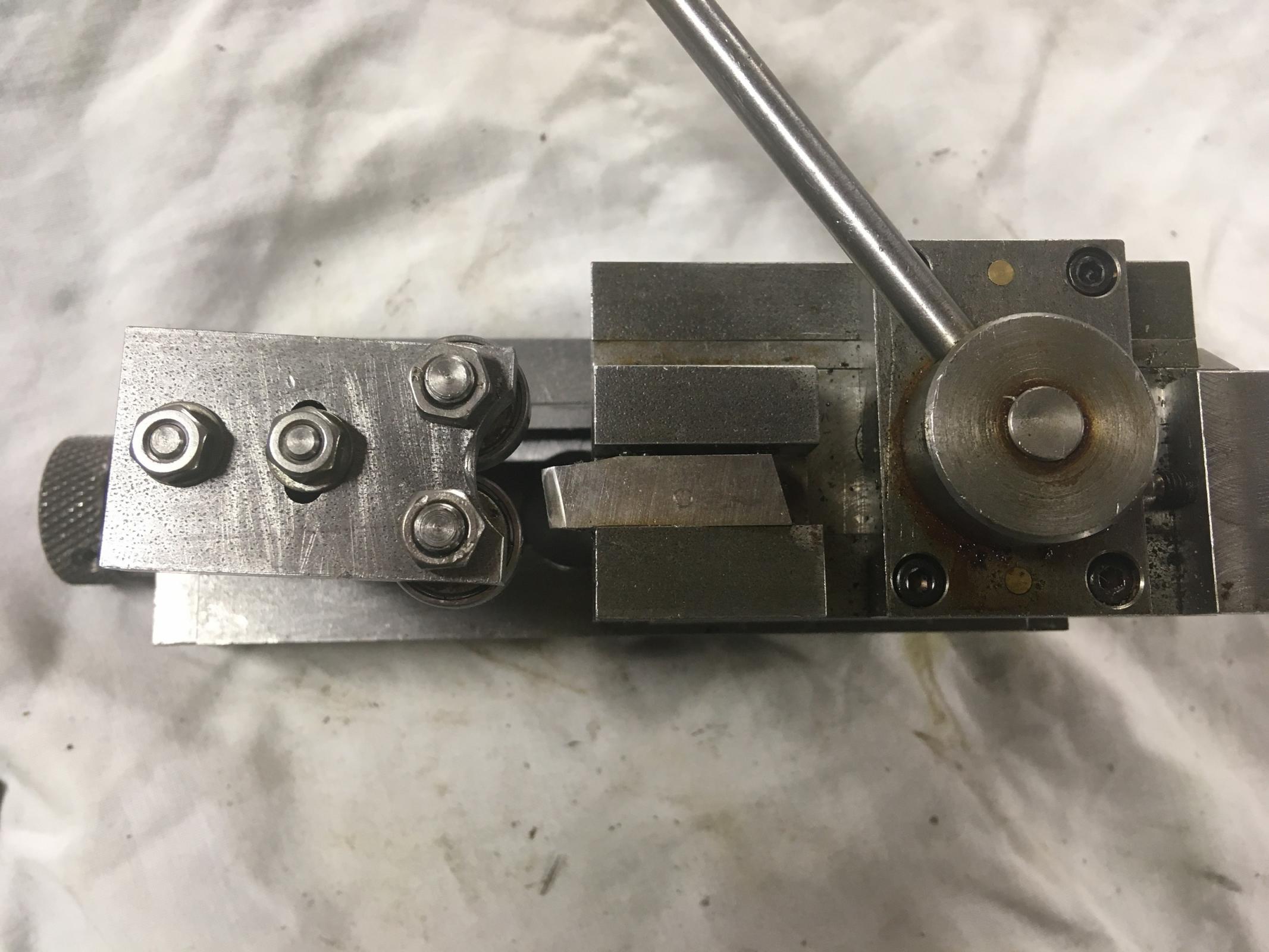

    Roller Box with adjustable in feed for screw cutting-tool-set-screw-cutting.jpg
    Retracting screw cutting tool fitted and 360 button steady. A spacer is used to position steady at correct position relevant to cutting tool. I have several spacers for different cutting tools.
