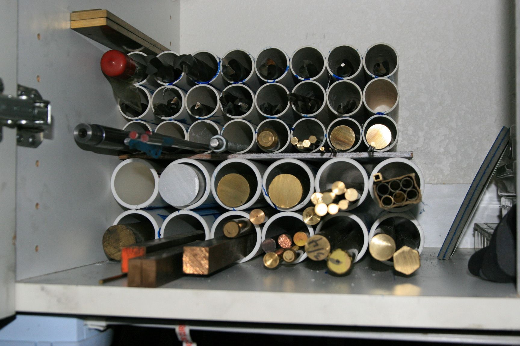

    I needed a place to keep 12" long or so pieces of brass and some MT2 drill bits.
    Pvc pipe seemed like a good idea but making a face with all the holes for the tubes
    seemed like a lot of work. So, I simply used pvc cement and glued them into a group
    putting a bead of glue on the point of contact of the tubes. Stronger than I could
    imagine and fast to put together. Here is a picture of it all assembled and loaded.
    Two different sizes of pipe were used for the various items to be stored.
    They are separated by a piece of plywood.

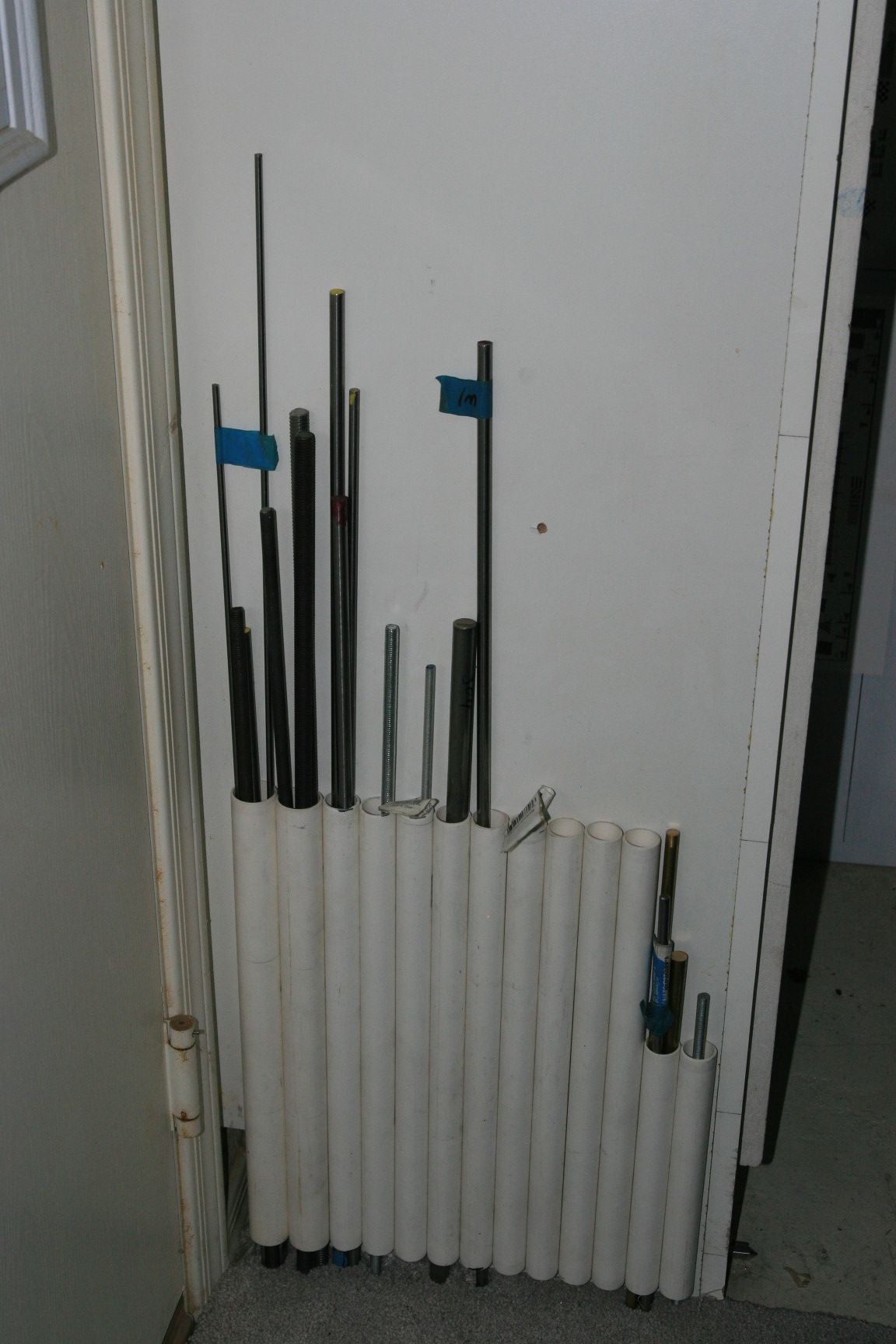

    The next picture is the vertical rack attached to the cabinet with "Goop". Really good stuff.
