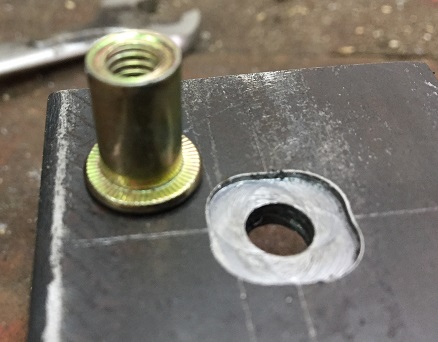

    Had to fit a few riv nuts to my kit car chassis. So dug out the old one...home made...very simple.
    Then I remembered that I did not like this one very much as you were actually using the "nut's" threads to collapse the shoulder.

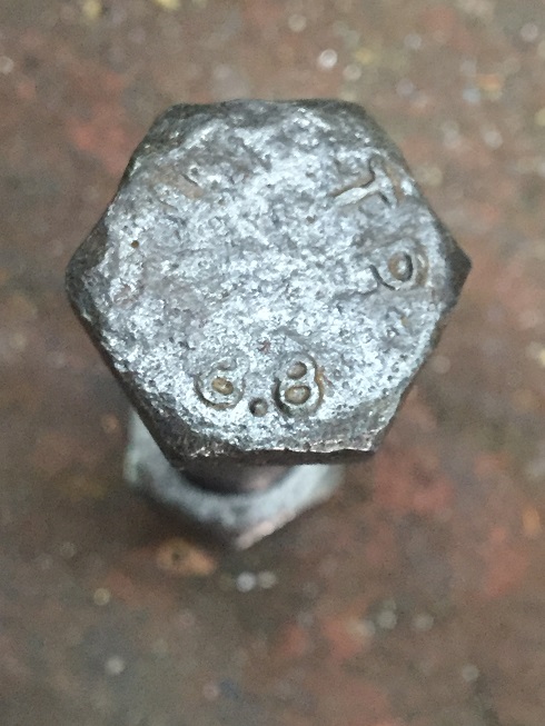

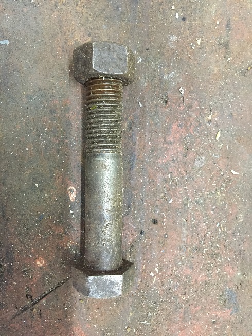

    I had an idea in my head since the day I made the old one. So a quick dig in the Scarp Bin and this old timer was found.
    Riv Nut Tool - Rises from the Scrap Bin-old-bolt.jpg Riv Nut Tool - Rises from the Scrap Bin-8point8.jpg
    Nice soft M16.

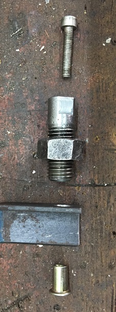

    The idea was to drill it out to accept a M6 cap screw to butt up against a shoulder at the bottom and then use the M16 nut to collapse the riv nut shoulder. the bits I wanted.

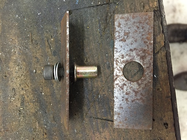

    I ended up making this modification after the first try with the new tool. A small recess for the riv nut's flange.

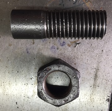

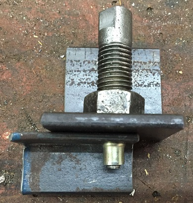

    The complete assembly before tightening the M16 Nut. The friction was more from the M16 nut to the angle iron base plate so I ended up turning the bolt part of the tool. I machined 2 flats on it to accept a 14mm spanner.
    Riv Nut Tool - Rises from the Scrap Bin-assembly.jpg Riv Nut Tool - Rises from the Scrap Bin-assembly-2.jpg

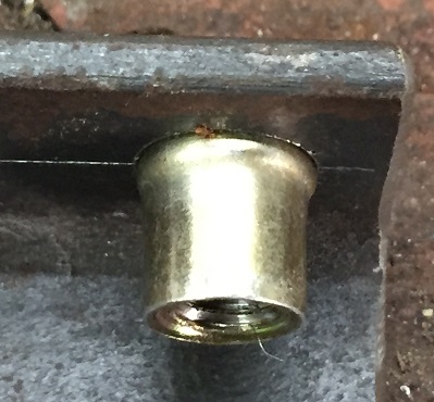

    And to show it works...Take note of the number of turns required for the desired end result. Turn toooooo much and the whole thing just collapses in a skew mess. This was after 2 full turns.

    Just to clarify... The M16 bolt is drilled through for the M6 bolt, and counterbored not quite all the way so that the M6's head rests on a shoulder near the bottom of the tool, yes?

    That is correct.
    So first drilled it with a 6.5mm all the way through and then 11mm and leave a 5 to 8mm shoulder at the bottom for the cap screw to but up against.
    Nice thing is you can modify the base plate to fit over a specific square tube and then use it as a drilling guide or if you have lots of riv nuts to fit at a set spacing,make it long enough to mark the next hole while fitting the first one.
