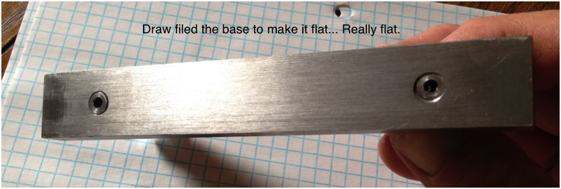

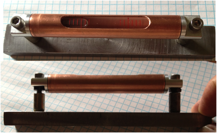

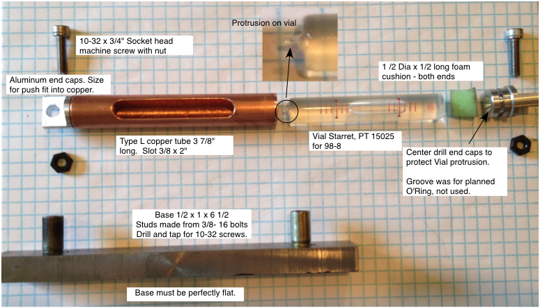

    The base was a chunk of hot rolled steel, 1/2 x 1 I cut off a piece about 6 1/2” long, the longest I can fit in my 4 jaw chuck. I “faced” the 4 sides, to clean up piece and flatten the base.
    The vial holder is a piece of type L copper plumbing pipe. If you choose to make one I recommend type K or L copper, type M has a very thin wall. I wish I had a piece of K to use. I cut a slot in that with my lathe using the compound rest mounted vertical on an adapter I made a while ago after seeing one on HomemadeTools.net - More Than 30,000 Homemade Tools - HomemadeTools.net Since I do not have milling cutters, I used a large center drill held in my collet chuck. It actually worked very well. The biggest problem was holding the tube securely enough without crushing it as the slot made the tube weaker. I ended up making aluminum “plugs” to slip inside the tube to prevent the vise from crushing it. I “honed” the inside with sand paper on a dowel, both before and after milling the slot.
    The end caps for the vial holder are aluminum. The small end is sized to be a snug push fit into the copper tube. The small ends are center drilled just a little, because the vial has a little glass tip on one end from the manufacturing process. I had intended to use O’RIngs to make a tight fit with the copper tube, but they work fine without them. The large end is sized to match the OD of the copper tube. Flats on the large end were milled using a 1/2” carbide router bit in the collet chuck along with my “milling adapter”.
    The posts to hold the vial assembly are made from 3/8-16 bolts. They are cut to length so the threaded end will not stick out the bottom and the unthreaded part is long enough to hold in the collet. The posts are drilled thru and tapped for 10-32.
    The vial is cushioned in the tube with 1/2” thick foam “plugs” that were cut using a “sharpened” piece of copper tube. This is not the best solution. The vial needs to be more secure than the foam makes it. I do not want to make the installation permanent by using something more secure until I am sure the design is good. On another forum, suggested using DAP 33 window glazing compound to seat a replacement vial in their Starrett level. I may try that later.
    The vial assembly went together well, the vial is held snug, but it can move, being held in place with only the friction from the foam cushions. Simply cleaning the glass with a tissue knocked the level out of adjustment.

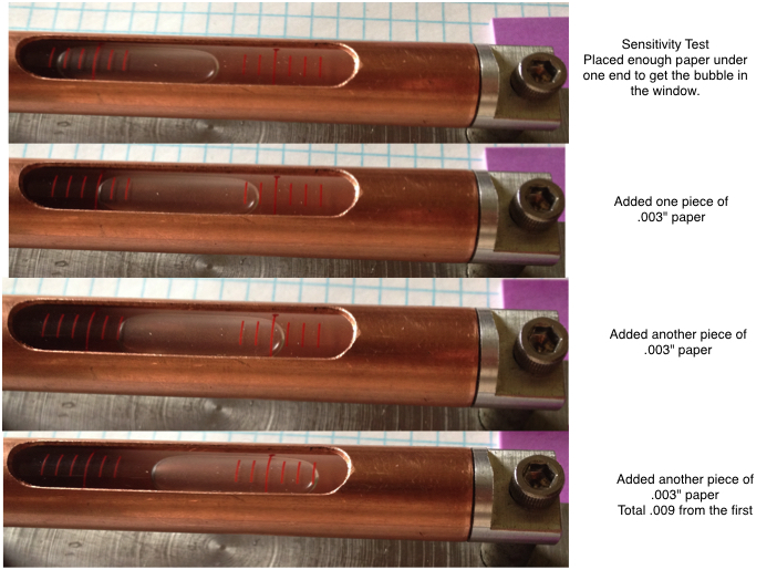

    This is how you calibrate the level. Starrett 98-12 Level
    During testing I discovered that the bottom was not flat. It was tapered from the center toward the ends about .001” so, pressing down one end, made the other end, .002” high. (each time I try to get more and more precise, I learn my lathe needs a tune up) I corrected this by draw filing the base and checking with my best straight edge. Of course I never noticed this taper when facing small parts, but over the 6 “ length of this bar, it sure did show up.

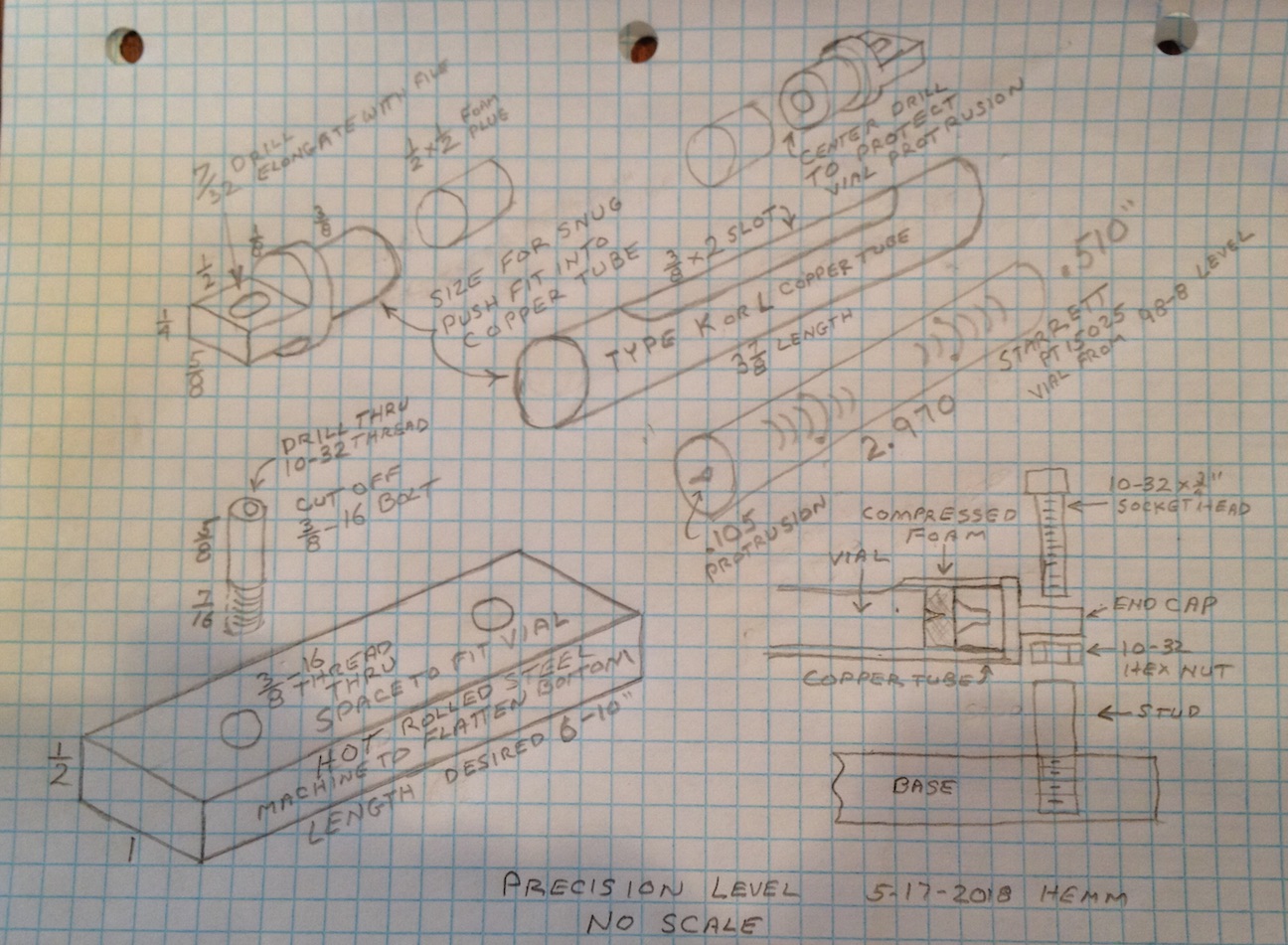

    Attached are photos and a sketch of the level if you want to try it. I can promise it will bring your understanding of level to a whole new level, unless of course, you are already….. on the level

    Just a useful thought though, each graduation on the vial of the level represents .005", beings you made the base of your level 6" long and your using a vial that is made and graduated for a 8" level your error would nearly double, Example:when you put a piece of paper under the level that was .003" thick it would move your bubble about .005"- .006" meaning you couldn't use the level for precise work, just as reference, look at your last photo and it shows how much the bubble moved every time you added .003"
    You did a beautiful job though !

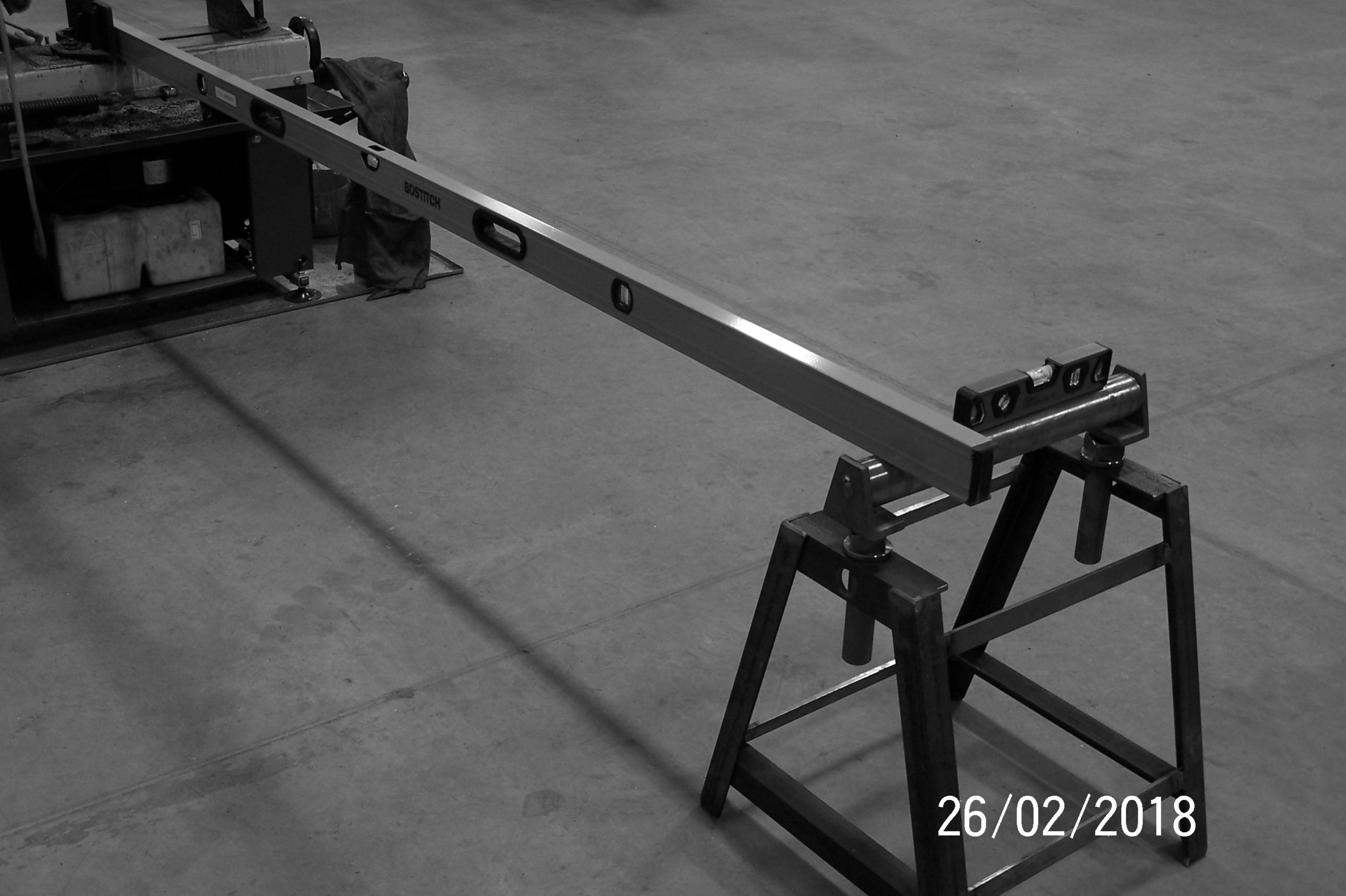

    While base of a precision level can support itself decently in full contact or at its ends, I use that second tendency in leveling machine tools. I suspend the level on good 1-2-3 blocks or reamer blanks. With the spacers separated by a known distance, it is quite simple to better estimate what amount [and direction] of movement is needed to get a machine on two [X & Y] truly horizontal planes.
    I used 2 levels, an 8' carpenter for X and 12'' magnetic torpedo for Y on the bandsaw support. To get accurate cuts for long material used in machine frames, this and improved leveling of the saw itself had to occur.
    As no table connects machine and support there likely is a sag in the level, regarded negligible by reversing level for the same reading. I found imperfections in the concrete floor experimenting with the distance and approximating the Airy Points https://en.wikipedia.org/wiki/Airy_points
