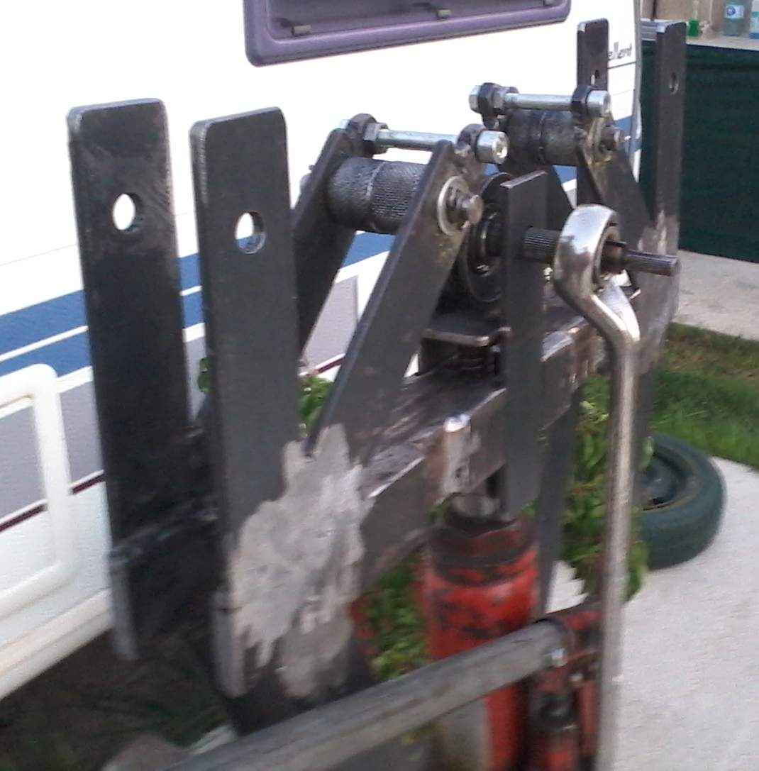

    When I decided to make a roller, my initial thought was for a very simple tool
    and only for the bending of two arcs for my need to make two trusses to reinforce my sheet metal brake,
    and nothing more.
    But after I had finished with my sheet metal brake modifications,
    I decided to add a second set roller-bases closer to the center roller,
    so my tool to be able to bend circles at smaller diameters.

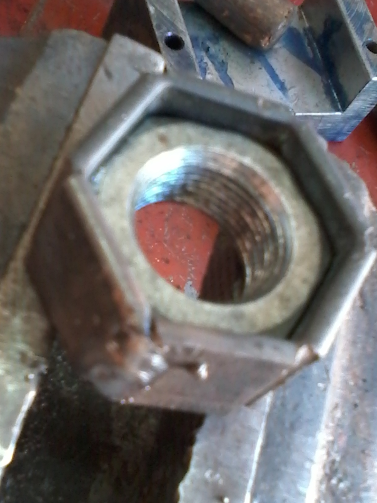

    And after that, I said to myself, why not and a removable wheel handle for the rotation,
    it is easy to made it now.

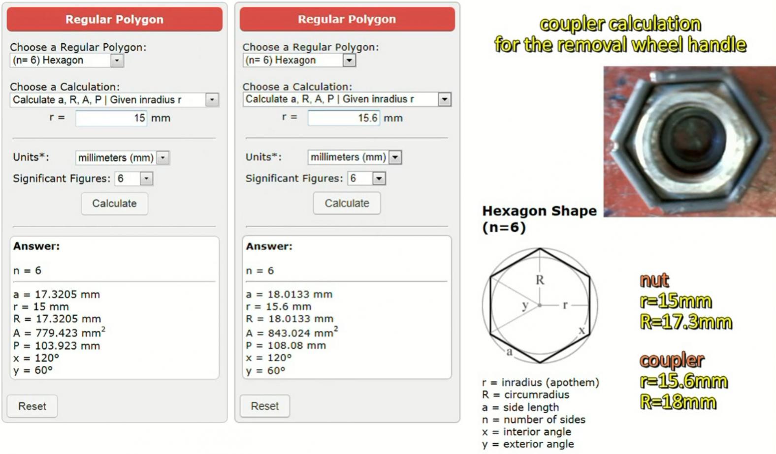

    Coupler Calculation
    Ring Roller Bender with Hydraulic Assist (DIY) [last Part2]-02.jpg Ring Roller Bender with Hydraulic Assist (DIY) [last Part2]-03.jpg
