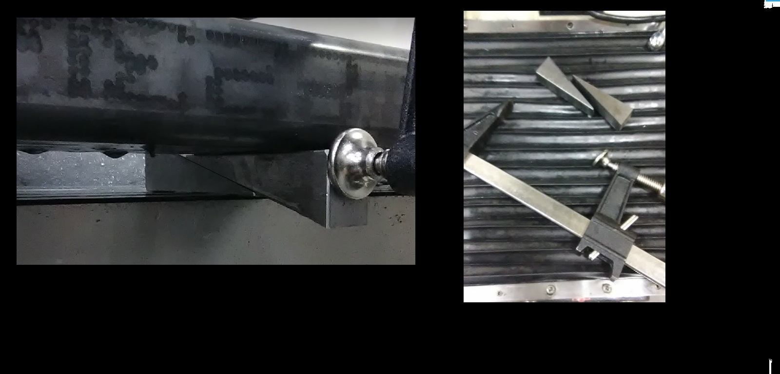

    All this drilling work brings new set-up fixes. Most aren't through holes, but necessary on this 1.5" x 3.0" x 10' tube. So, can't rest on table.
    Ends are elevated on 3/4" flat bar, under clamps in free area. 3" wide makes it difficult to open an adjustable parallel, not only being 'too valued' for such application. 1-1/2" drill will apply considerable pressure.
    To alleviate flex in middle of tube, a quick bit of diagonal sawing rendered these opposing wedges. Used bar clamp to set and hold position.

    I have become a firm believer in rotobroach bits. my little 1-1/2 HP drill press struggles with any twist drill above 1" but has no problem drilling a 2" hole through 1 1/2" plate with the rotobroaches.
    Using tapered wedges under the edge of a tube is something I have often done to keep the end level while the tube is clamped in a vice I also have several pieces of scrap laying around the drill press that have become dedicated height supports. and don't dare think your are going to clean around it and huck my scrap bits of metal in the bin.
