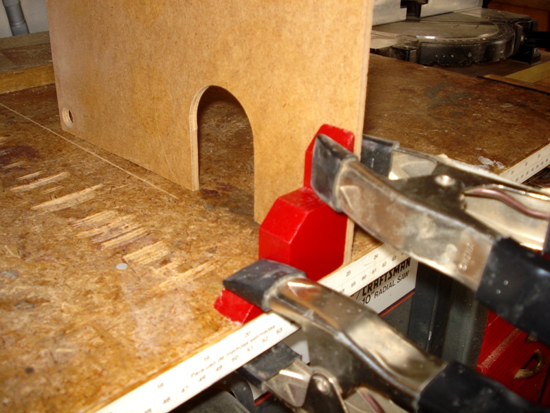

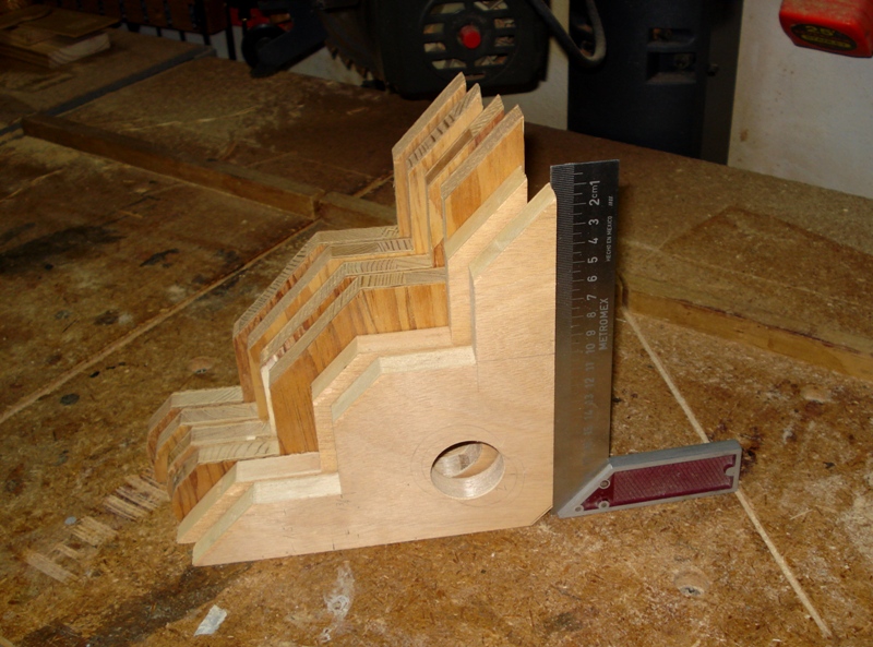

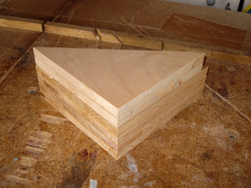

    Here are three jigs:

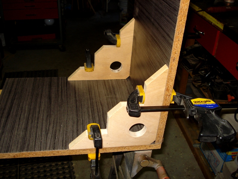

    1- These jigs, as designed by WOOD Magazine (Wood Magazine – Shop Tip of the Day ), are useful to clamp pieces at right angles for gluing or fastening; they are made with scrap wood.

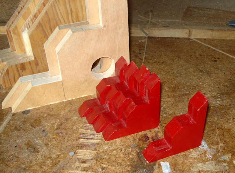

    2- The small jigs, painted in red, are also made from scrap wood, and are useful to clamp small pieces.

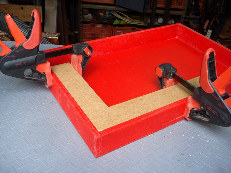

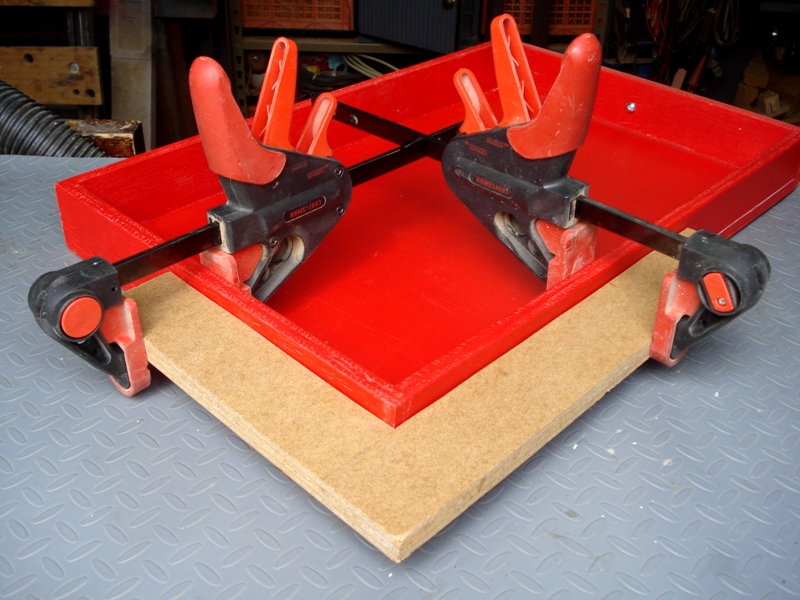

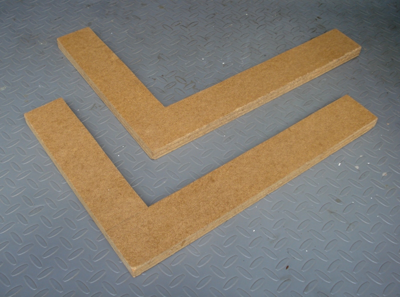

    3- The L-shaped jigs, made from leftover 1/2" MDF, are useful to align both interior as exterior corners.
    Regards, morsa.

    I have several similar sets, though much smaller and done in aluminum, that I use when gluing models. Builders who copy your design are reminded to pay close attention to the relief on the 90 degree corner, there so irregularities won't affect the orthogonality and so glue squeeze-out at the joint won't glue the jig to the structure.
    A liberal coat of floor wax on the jig will prevent any glue squeeze-out from sticking to the jig.

    Thanks, mklotz. Excellent tips; by the way, I’ll have to make that relief in the L-shaped jig, both in the inside, as in the outside corners. Although obvious, another recommendation when making jigs like these is to take care that the angle is exactly 90º.

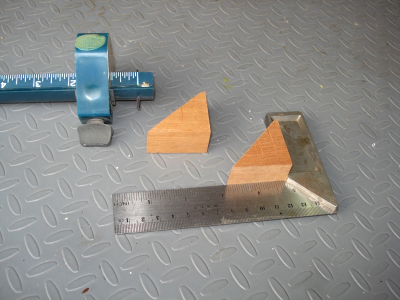

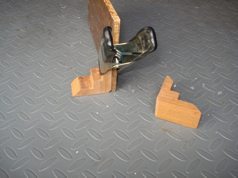

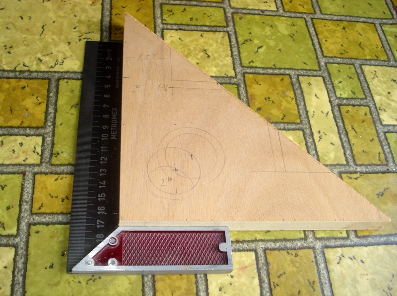

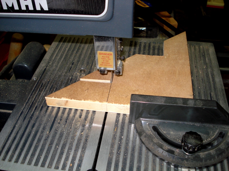

    Yesterday I found these triangular cut-offs, and decided to make a pair of clamping jigs for small projects. The sides of the right angle are 1-3/4” (1.75”) long.

    Your clamping arrangement dictates that the angle jigs be at the end of the board. A jig in the middle of the board is impossible unless you have a clamp with enough depth of throat to reach down from the top of the board.
    One way to solve that problem would be to make one angle jig with two neodymium magnets embedded in its vertical face. Then a small ferrous plate stuck to the outside of the board would act as a clamp. The size of the jigs suggests that this device would be used for rather thin boards so the board thickness wouldn't diminish the magnetic force too much.
    Something to keep in mind if you ever run into the situation described.

    Good point.
    This is like a brainstorming, where every idea is followed by several others, and each one improves the whole concept.
    I wonder if a magnetic welding square could work instead of a wooden square with neodymium magnets, or if sticking the ferrous plate by the inside, with double-sided tape, could make that function. Anyway, most of this clamping jigs use is at the edge of boards.

    Welding squares would not only work; in the middle of the board they have the advantage of being able to magnetically clamp both to the horizontal board and the vertical one. This eliminates the need for deep-throat conventional clamps in both locations.
    Drawing on a history of building ship models, I can say that thin boards are very prone to warpage during gluing. They'll warp if you look at them the wrong way. Anything that improves the ability to clamp is golden.
