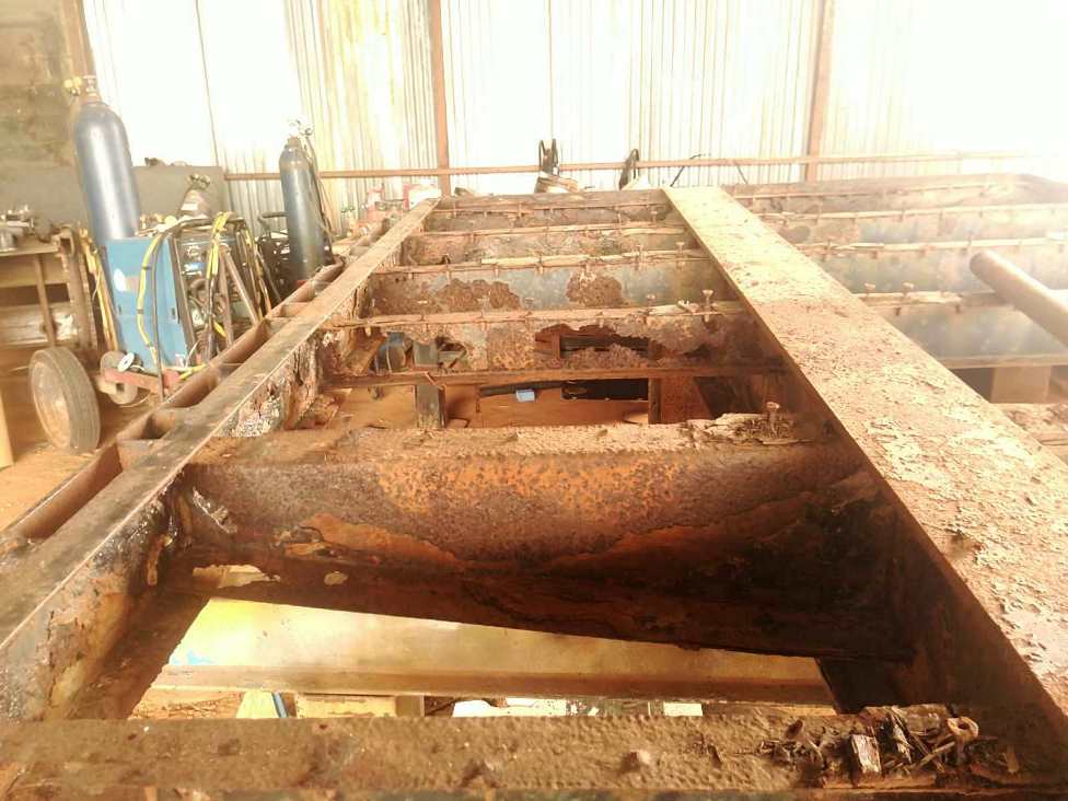

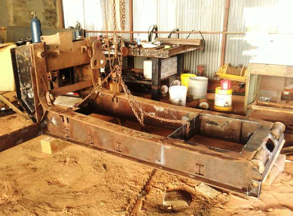

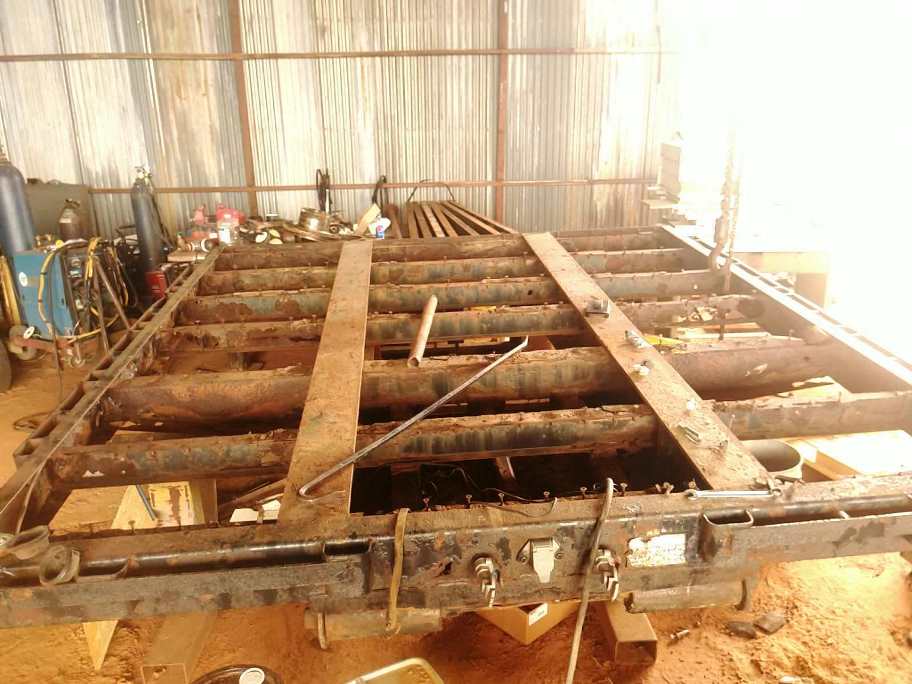

    Me and a friend of mine bought a 2 axle RGN trailer with a 3rd flip axle about a year ago then sold the flip axle for nearly as much as we paid for the trailer. So it came down to either scrap it for about as much as we sold the flip axle for or rebuild the neck then determine how much we want to spend on the trailer itself
    What it started out as

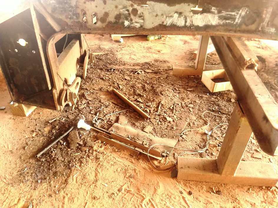

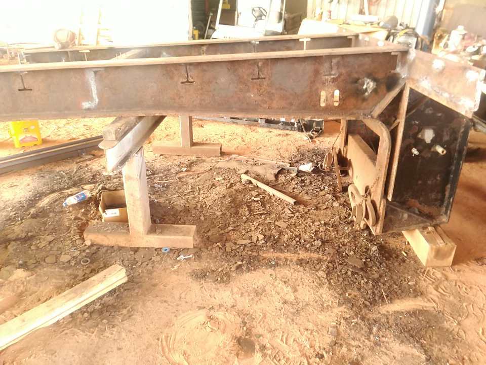

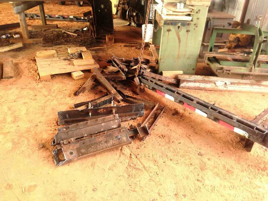

    some of the scrap removed

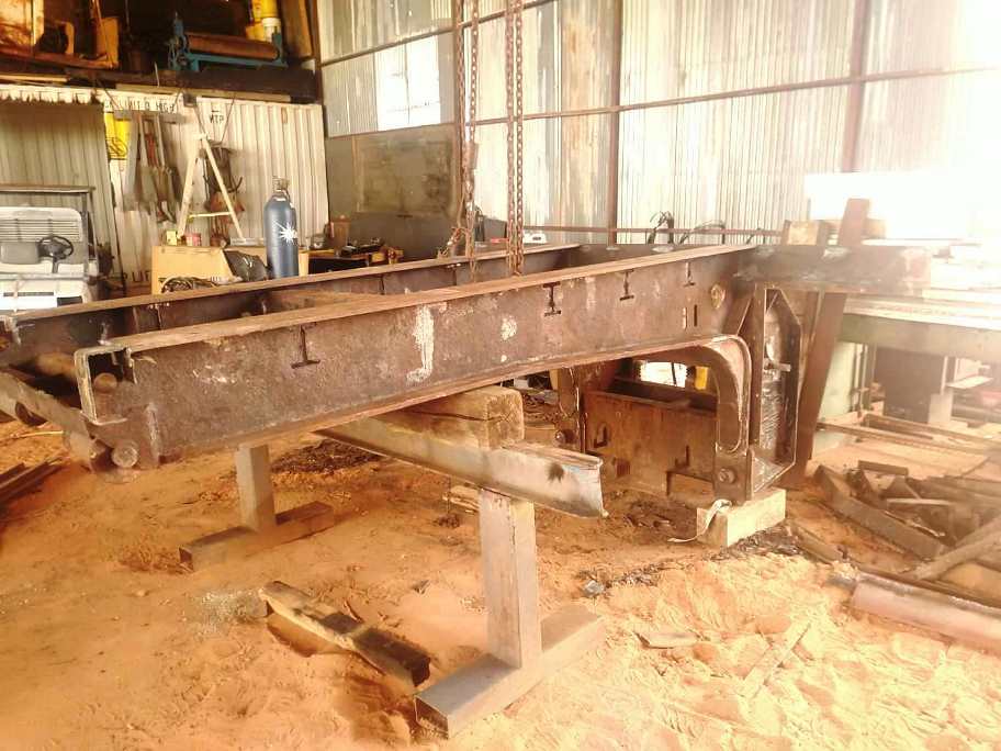

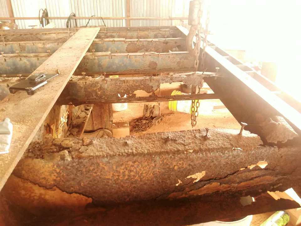

    nearly 400 lbs of rust was beat off with a needle gun

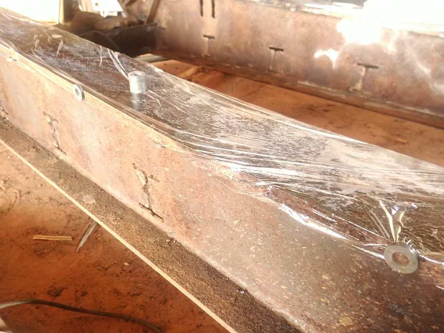

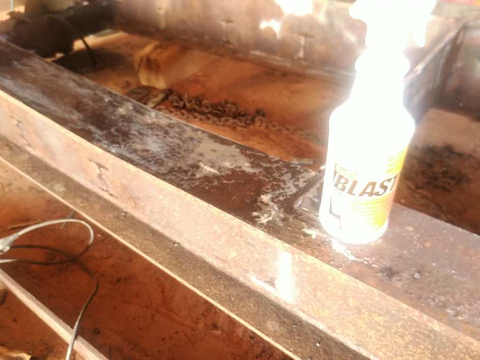

    more rust removed chemically
    wrapped in plastic to allow the chemical to work over night

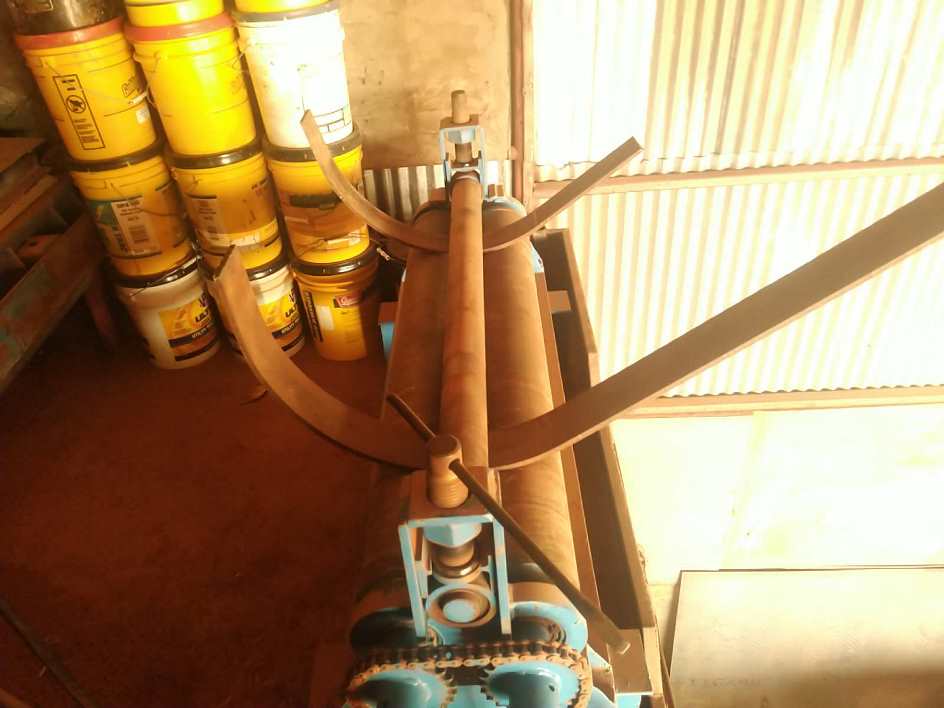

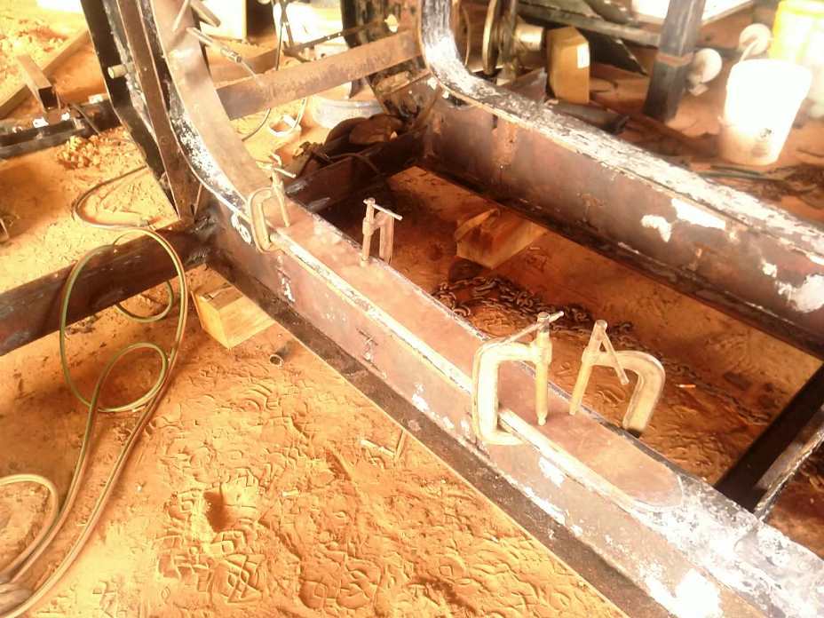

    rolling 2 pieces of 3/8x 4 1/2 T1 steel in my homemade plate roll

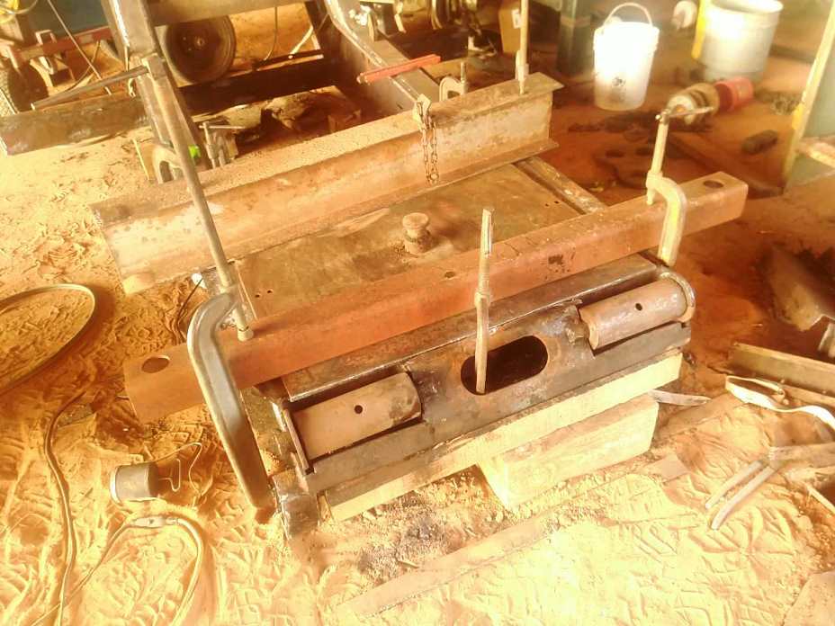

    strapping the neck

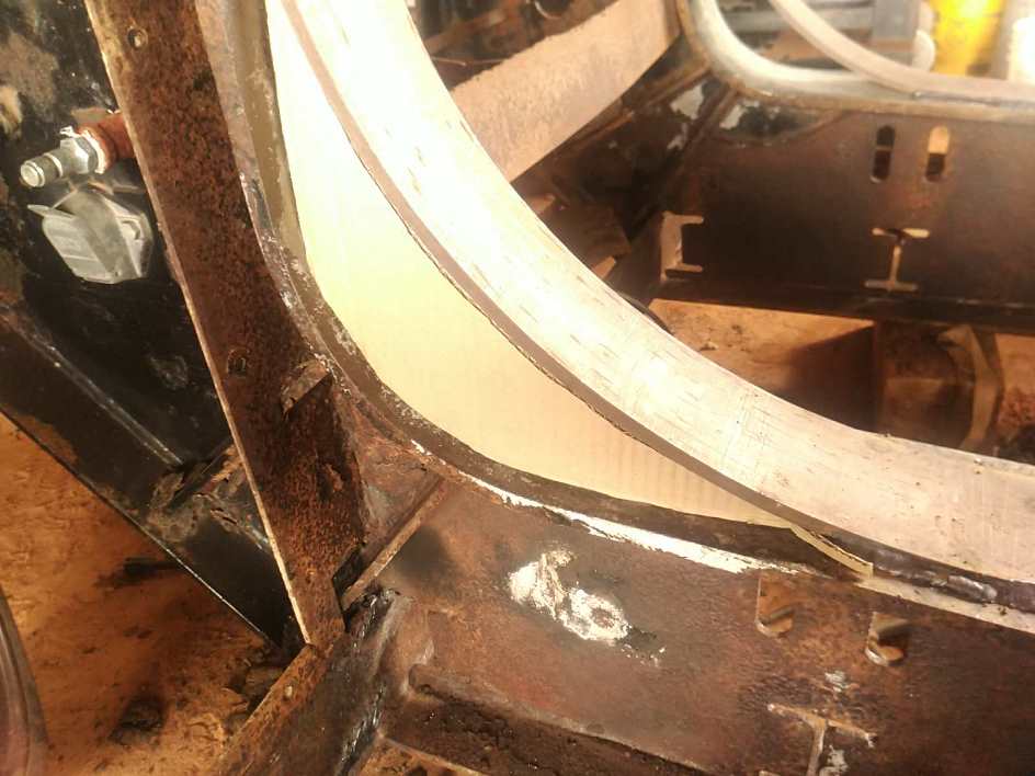

    Making cardboard patterns for the webs

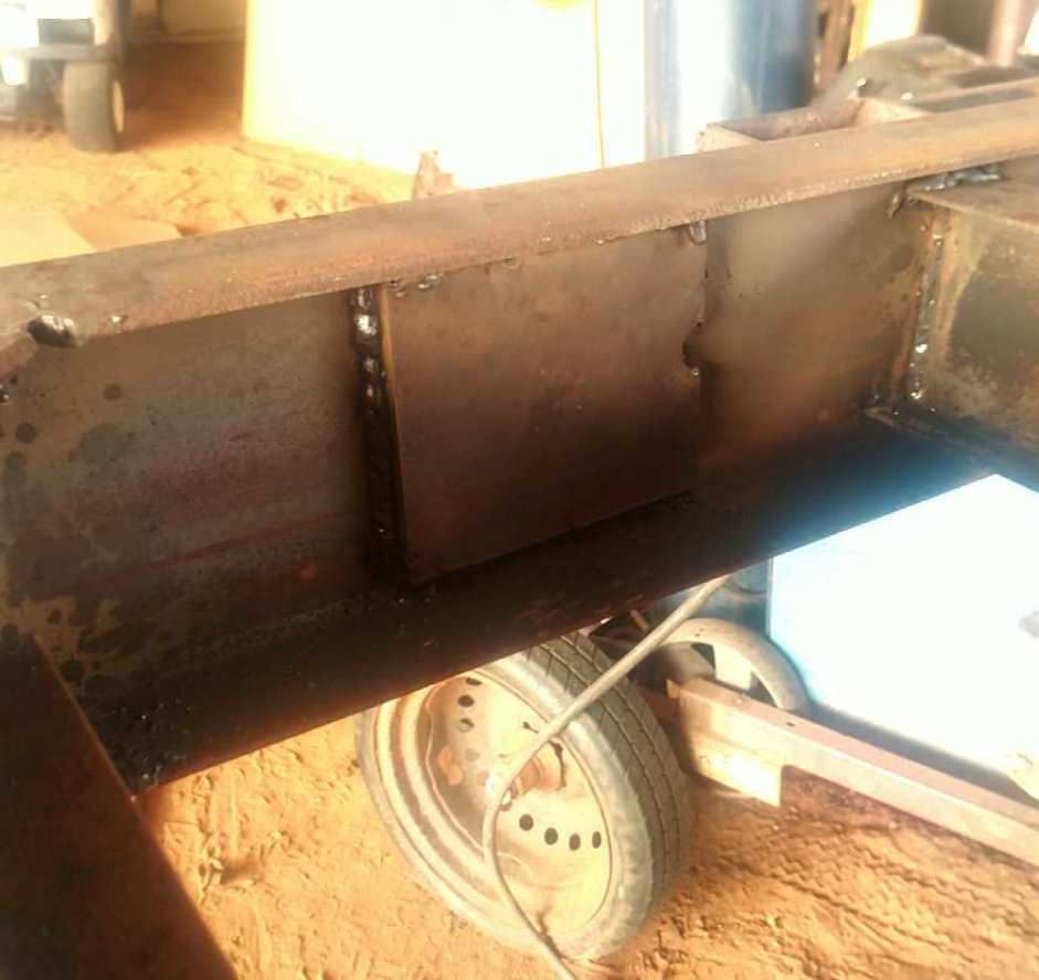

    webs welded in place

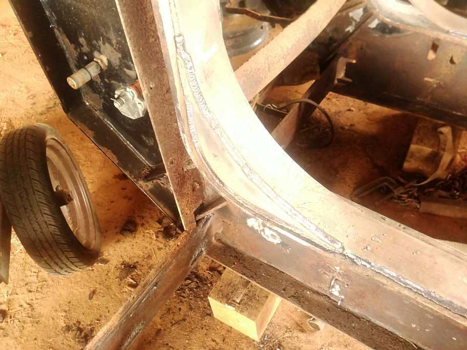

    installing replacement king pin and plate

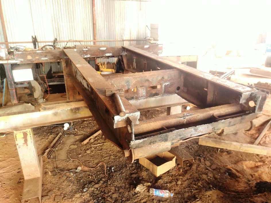

    ready to go back together

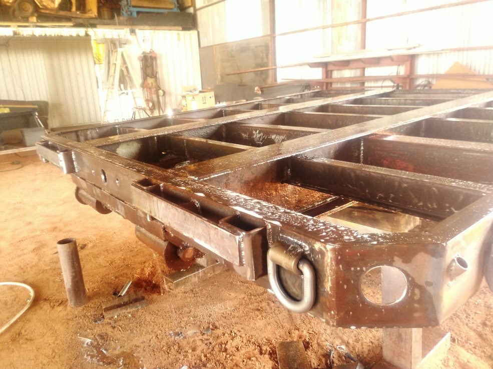

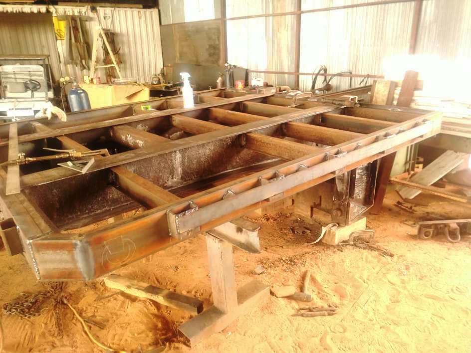

    new cross members and side rails

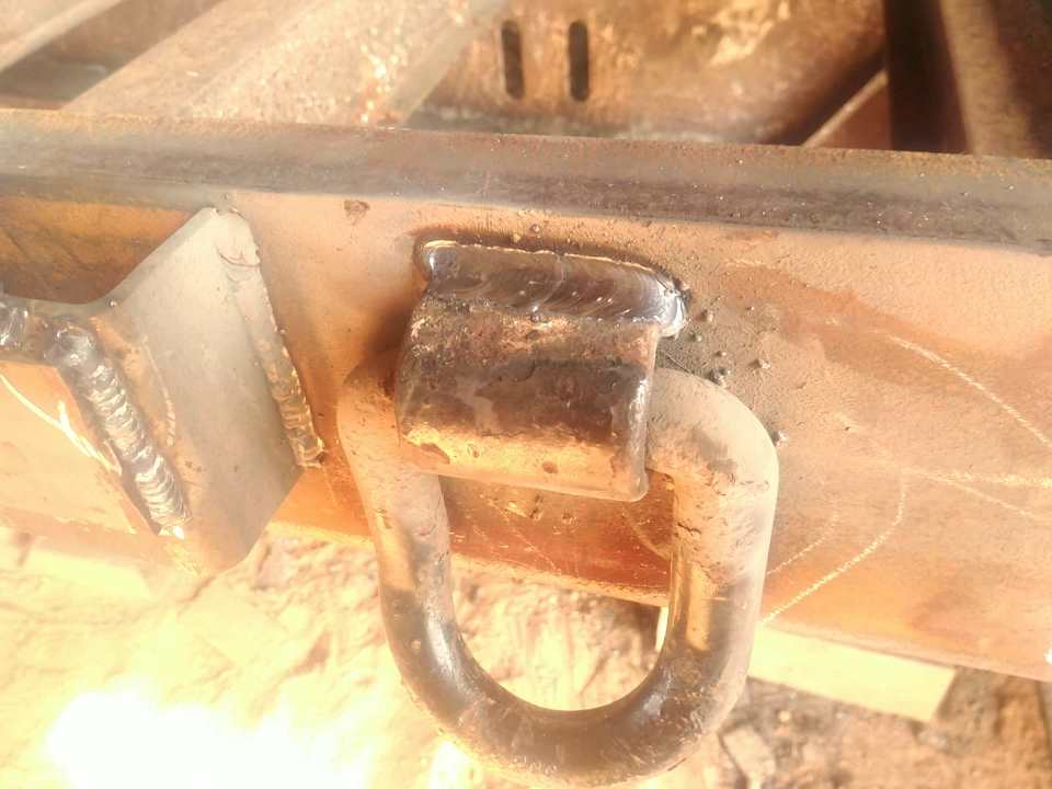

    web stiffeners for D rings

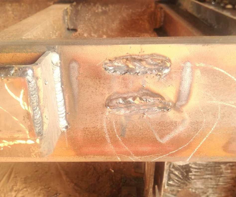

    Welds in slots cut through side rails
    D ring mounts welded over slot welds tying the loop to the stiffener

    ground sanded washed with a solution ready for rinsing drying and painting

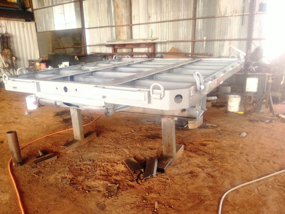

    first coat of paint after being dusted with an etching primer for the hard to reach areas is could not sand very well

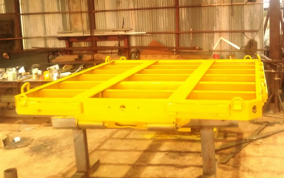

    Well I now have the final color on the neck and it is so yellow it hurts my eyes and my camera to look at

    Wow! I know a guy that dipped an entire mini body in acid to lighten it for a race car he was building but leaving something to rust and then knocking the rust off, Brilliant! No hydrogen embitterment from the acid reaction either.
    Pure genius Frank, pure genius. Learn something new everyday.
    At least you won't forget where you parked it. Just look for the yellow glow.
    We NEVER saw anyone weld cardboard before!
    Safety yellow.
