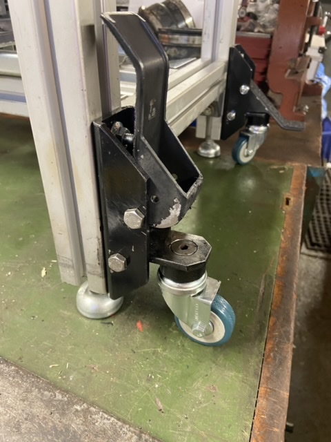

    thehomeengineer,
    First post here, long-time lurker. Could you post pics of the lifting lever? It appears to have a curve that is used to rotate the caster downwards. Do these lock into place via friction alone?
    A few final questions: 1) What is the mass of the object that you are lifting? 2) How much force is necessary to push the caster into the engaged mode? Need to rock object to lift? 3) Does it take much force to release the lever from the down position (or do you rock the object backwards to release)?
    I have a welding table that I would like to be able to move around and these would appear to be a good solution...
    Thanks for any response!
    Keith

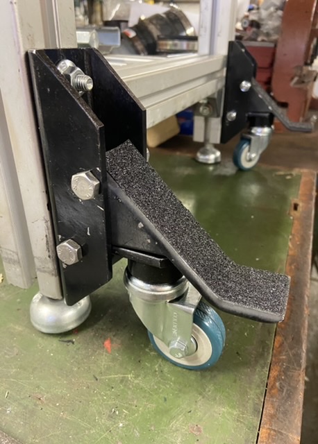

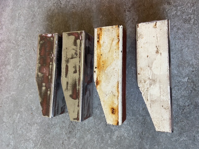

    Quote Originally Posted by thehomeengineer View Post
    Hi All
    Been a while since I last posted. Busy on a couple of construction jobs over the year so little workshop time. But at last I have got one project finished and decided to fit some retractable castors. Nothing new I know. I was surprised at the cost to buy so decided to make some from scrap box section. The final result works a treat but buying against making is questionable. There was unite a bit of cutting and machining and the cost in items I bought was £6.50 Wheels E-bay £4.50 and cheap spray paint £2.00 so 10% of cost of buying complete set. The material I used is more substantial than the commercially available. But time to manufacture was longer than anticipated so £68 to buy is probably a cheap price but I guess I still have £61.50 in my pocket I can spend on something else, and I did enjoy making them.
    Below is a few photos of the castors in place.
    Attachment 38704Scrap box cut to very rough shape for foot lever
    Attachment 38708Castor in closed mobile position
    Attachment 38709Castor in the lifted position.
    many thanks for looking
    The Home Engineer
    Are there any plans how to make these?

    Hi Keith
    the wheels are rated at 50kg so depending on the load rating of the wheels you purchase will determine what weight can be moved. There is nothing stopping you making the mechanism larger to take a larger wheel and load capacity. The mechanism operates on a cam and once over centre locks in place. Commercially made retractable caster are available which lift 800lbs priced at £68.00. The ones I made lift very well with little effort to lift the kindling chopping machine and to release you simply place your foot under the lifting lever and lift lever to lower. These are made from 50 x 50 x 5mm box and 40 x 40 x 3mm box and the pivot bolts are M8 high tensile bolts with ny-lock nuts. The commercially made ones look like pressed 16 gauge steel. So larger capacity wheels say 125 kg rated and a larger lever you could easily lift 0.5 tonne with foot operation. hope this helps and has answered your questions
    The Home Engineer
