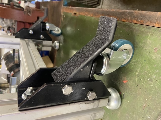

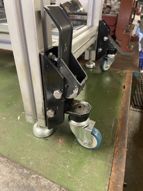

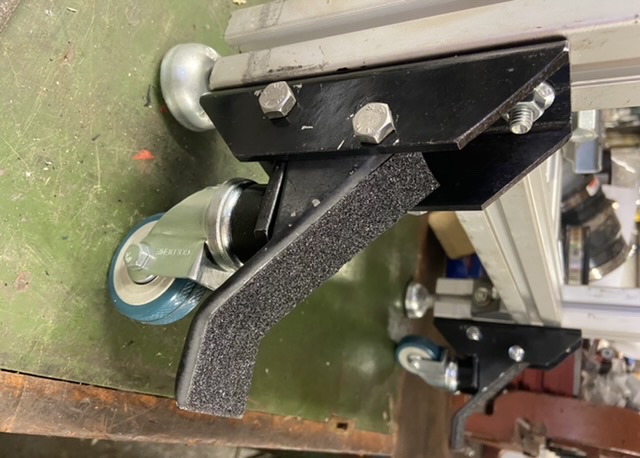

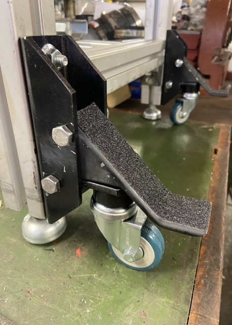

    Been a while since I last posted. Busy on a couple of construction jobs over the year so little workshop time. But at last I have got one project finished and decided to fit some retractable castors. Nothing new I know. I was surprised at the cost to buy so decided to make some from scrap box section. The final result works a treat but buying against making is questionable. There was unite a bit of cutting and machining and the cost in items I bought was £6.50 Wheels E-bay £4.50 and cheap spray paint £2.00 so 10% of cost of buying complete set. The material I used is more substantial than the commercially available. But time to manufacture was longer than anticipated so £68 to buy is probably a cheap price but I guess I still have £61.50 in my pocket I can spend on something else, and I did enjoy making them.
    Below is a few photos of the castors in place.

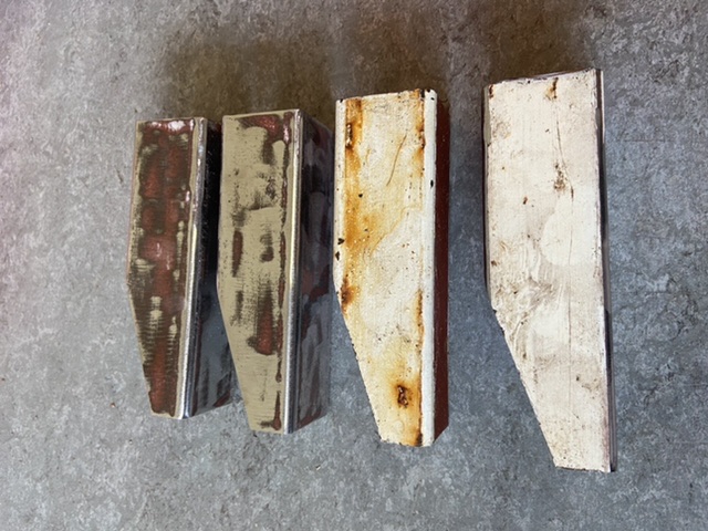

    Retractable castors-d91e23f7-4432-41a1-a4f0-72caaed227fe.jpegScrap box cut to very rough shape for foot lever
    Retractable castors-8d9e1724-40d9-471a-91d4-2547eb964ec1.jpegCastor in closed mobile position
    Retractable castors-3268236f-5a9f-499c-84a8-8c1e38cefb22.jpegCastor in the lifted position.
    many thanks for looking
    The Home Engineer
