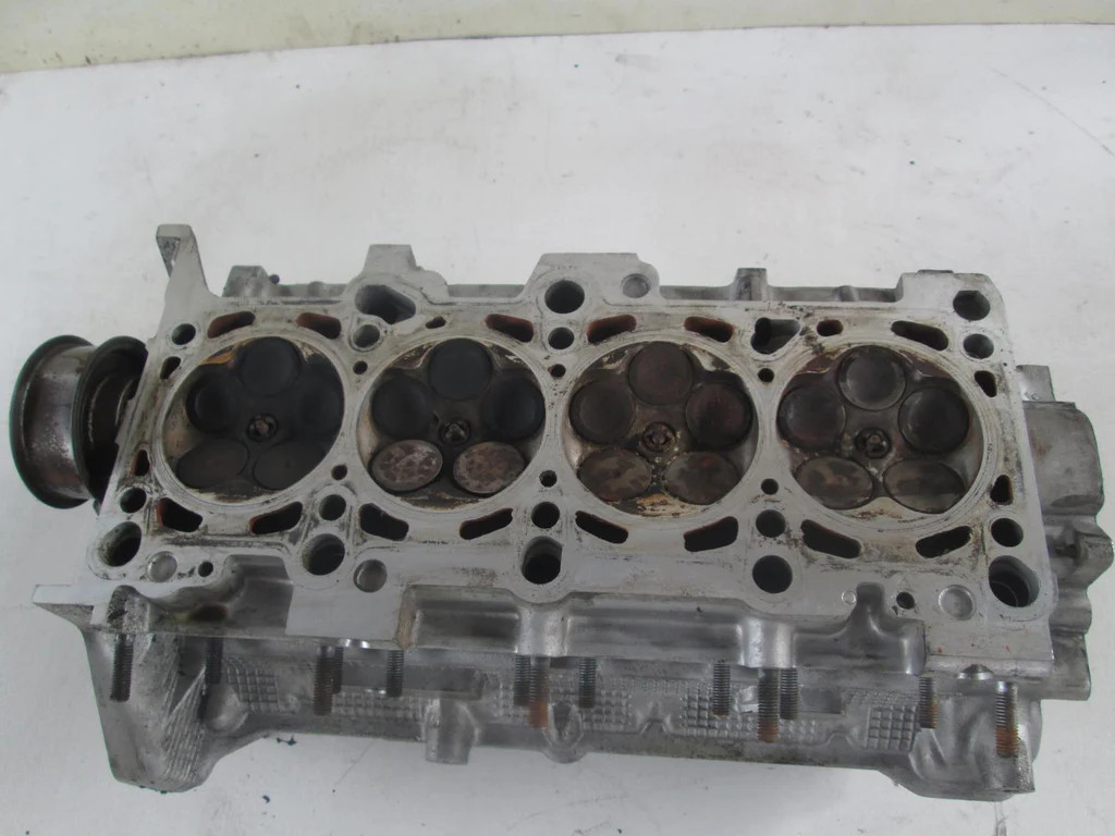

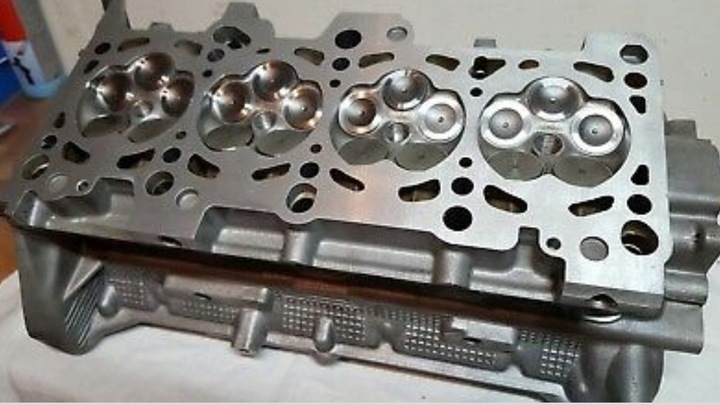

    I did a bit more research. It looks like somebody has spent a hell of a lot of time making a high horsepower race head. The stock heads have large coolant passage holes on the heads that line up with tiny little coolant passages on the block. Whoever has modified this head has filled in those coolant passages, then redrilled out only what's necessary to line up with the coolant passages on the block. I think they're trying to make a more closed deck head. Also the combustion chamber is way deeper than a stock 1.8T head. The video appears to have added 2-3 mm of additional height above the head gasket to that head. Have a look at the depth of the stock heads. The valves are almost flush with the mating surface for the head gasket.

    There is a ton of work here that we're not seeing. Somebody spent many hours on this. Weld, machine, die grind around the outside of the head and in the combustion chambers, rinse repeat. That happened probably 3 or 4 times to get to the point we see in the video. There aren't even any inclusions in the surface after the fly cutter. One or two passes of weld is not going to produce a surface finish like that. We're looking at many hours of work here.
    I also found 1.8T heads that have been CNC ported for crazy amounts of money. Like $5k for a head. I really don't understand why someone would spend that kind of money on a four cylinder engine, but then the Honda Civic tuner crowd exists so what do I know?
